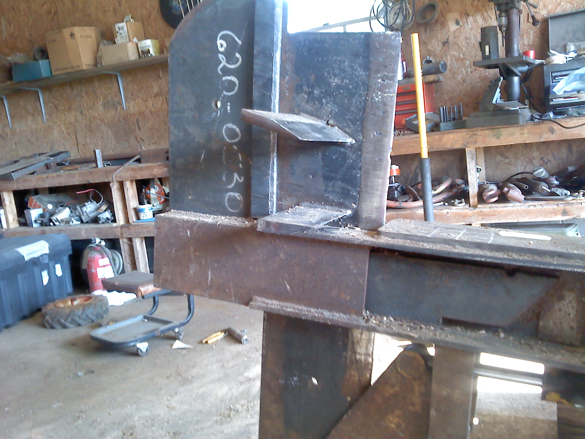

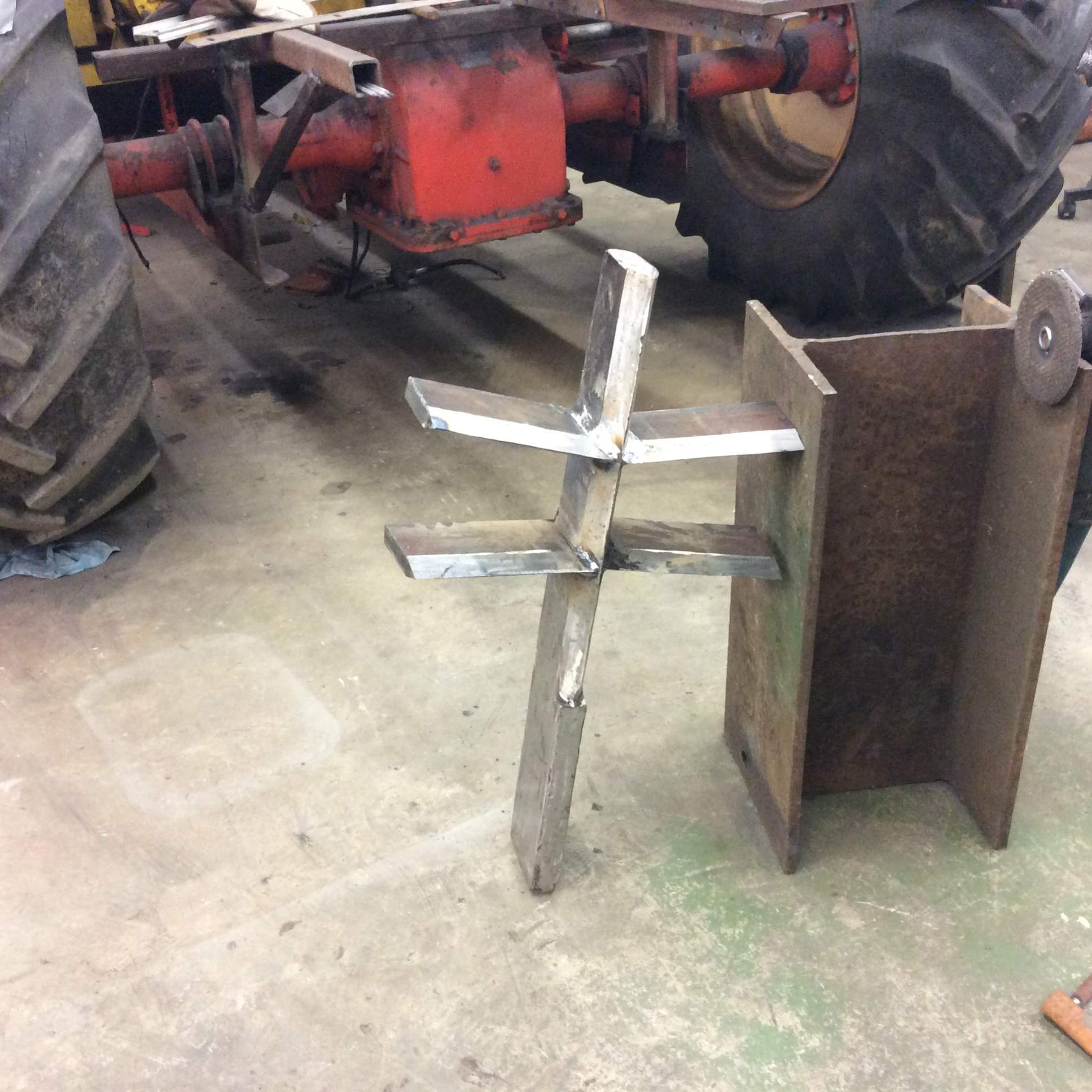

Haven't much to report, still looking for a larger hydraulic cylinder. Can't do much without knowing the size of it, but I did make the wedge ,made it out of three pieces of half inch plate laminated together, here is a couple of pics.
What do you think?
It is 18" wide and 21" tall, it should work for anything I will ever have to split

I think you will have binding of your splits. My wedge is very similar to yours. To prevent any binding, I only sharpened one side of each wedge. The bottom wedge is sharpened on the bottom side and the top wedge on the top side. I also made the opening between the wedges wider in the back than the leading edges of the front. If the wedges are sharpened on both side, the wood is forced to go between a narrower space after it contacts the cutting edge. Even after fixing my wedge the ay I did, I still see some binding and plan on cutting my top wing off and not only angleing it up at the back, but putting a little Vee angle on the outer ends.0131141616.jpgwedge.jpg
/ My home made firewood processor #48
I 100% agree with Muddstopper. I would not want to have to pound those chunks back out of that wedge.
You only want to have a single bevel and then even still you want to have some relief where the back of the top horizontal wedge is higher than the front.
That is the way ours is designed and we still have some issues at times. It's amazing how wood compresses in strange ways when you get knots running through.
I know you hate to hear it but I wouldn't even try to use that wedge. It will not be fun.

You need only go to a larger cylinder with multiway wedges if you have a constant diet of hard woods or fat round softwoods. A 4" cylinder with a 2" ram should be sufficient for pine and aspen. As you go up in width without changing pump output, you begin to lose speed. I once used a 37 ton Husky that I could take naps with between rounds. Made me nuts. Much preferred my 4" when I got back home. I have a 4way on mine that easily splits 18" oak. As a matter of fact, I once tore off the wedge right off the beam with this 16 ton splitter.
How'd you sharpen the 1/2" plate?
I equate tall splitter wedges with fat rounds. Are you going to hydraulically control the wedge height?

Yes I am going to hydraulically control the highth of the wedge,I would like some pics of other wedges that are hydraulically consoled to give me some ideas
/ My home made firewood processor #52
you can see in my second pic how i raise and lower the wedge. that wedge is 24in tall at full extend. The cyl is actually a steering cyl off a old forklift. maybe 2in bore and 6in stroke.

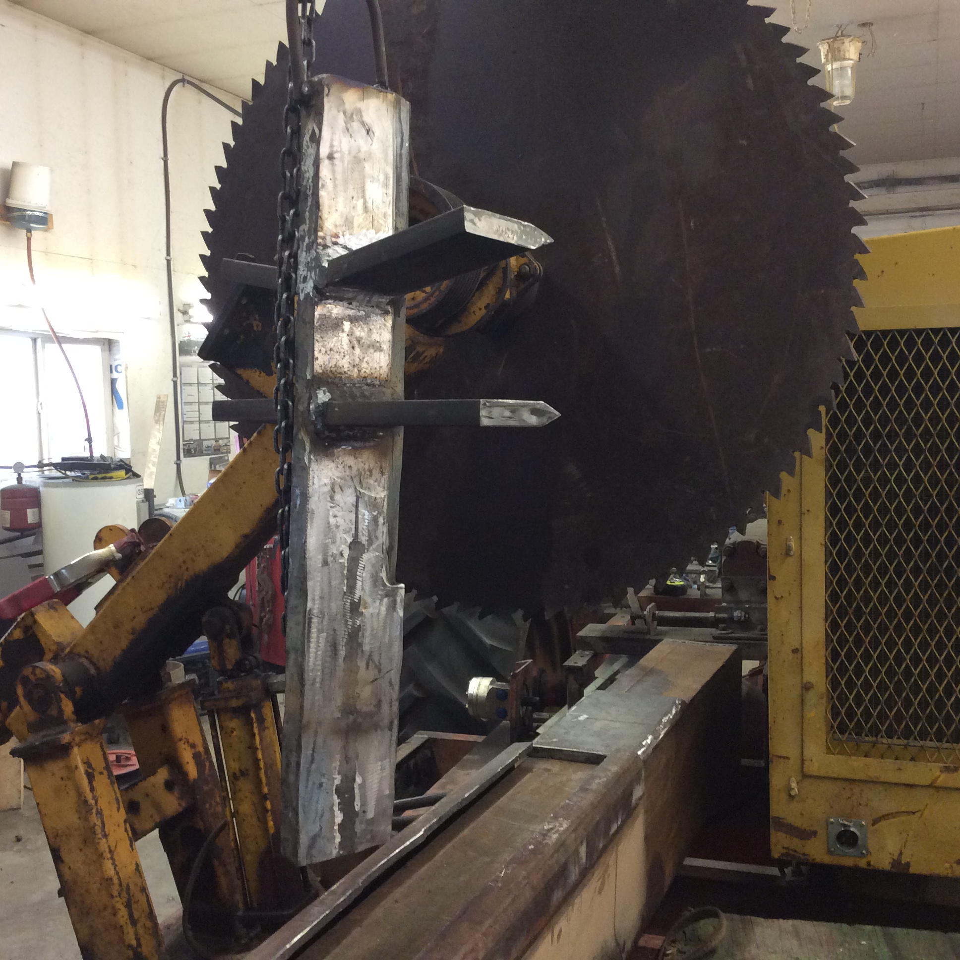

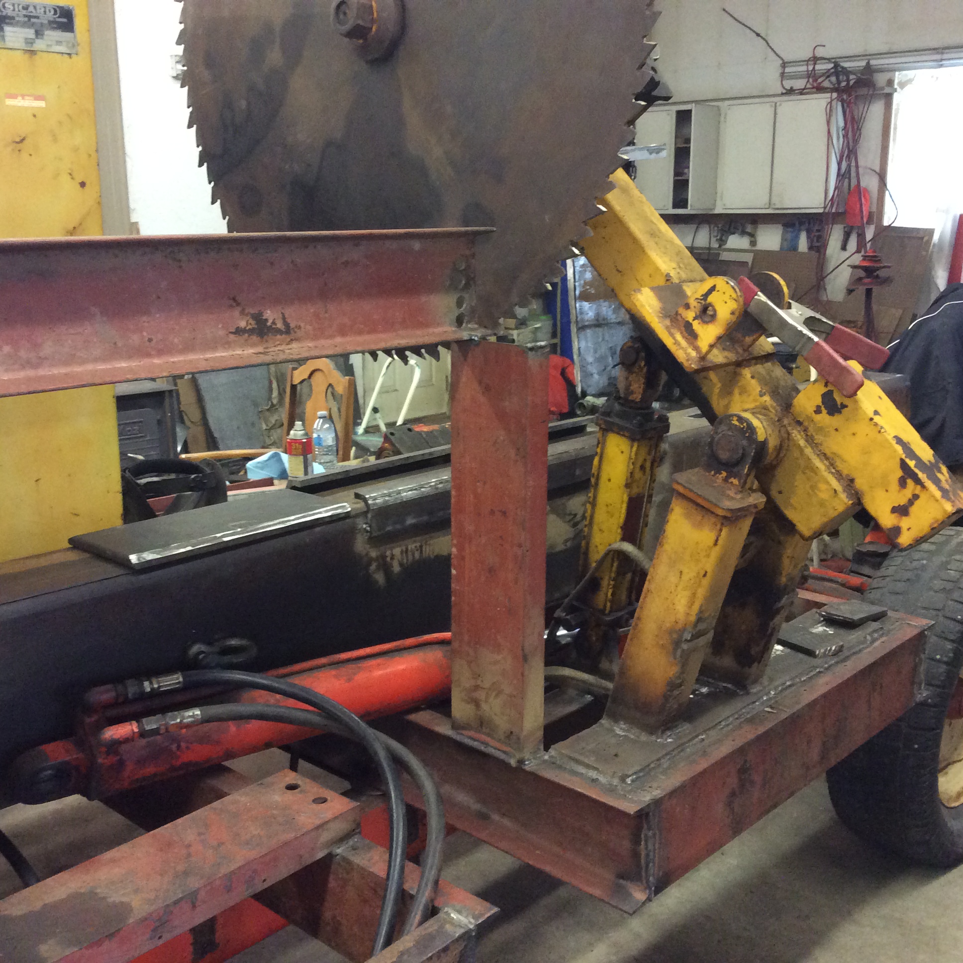

Well today I mounted the saw head and build the start of the log deck, here's a few pics,comments please
It will have a 42" saw on it
Oh ya look what followed me home on Friday. Hiab

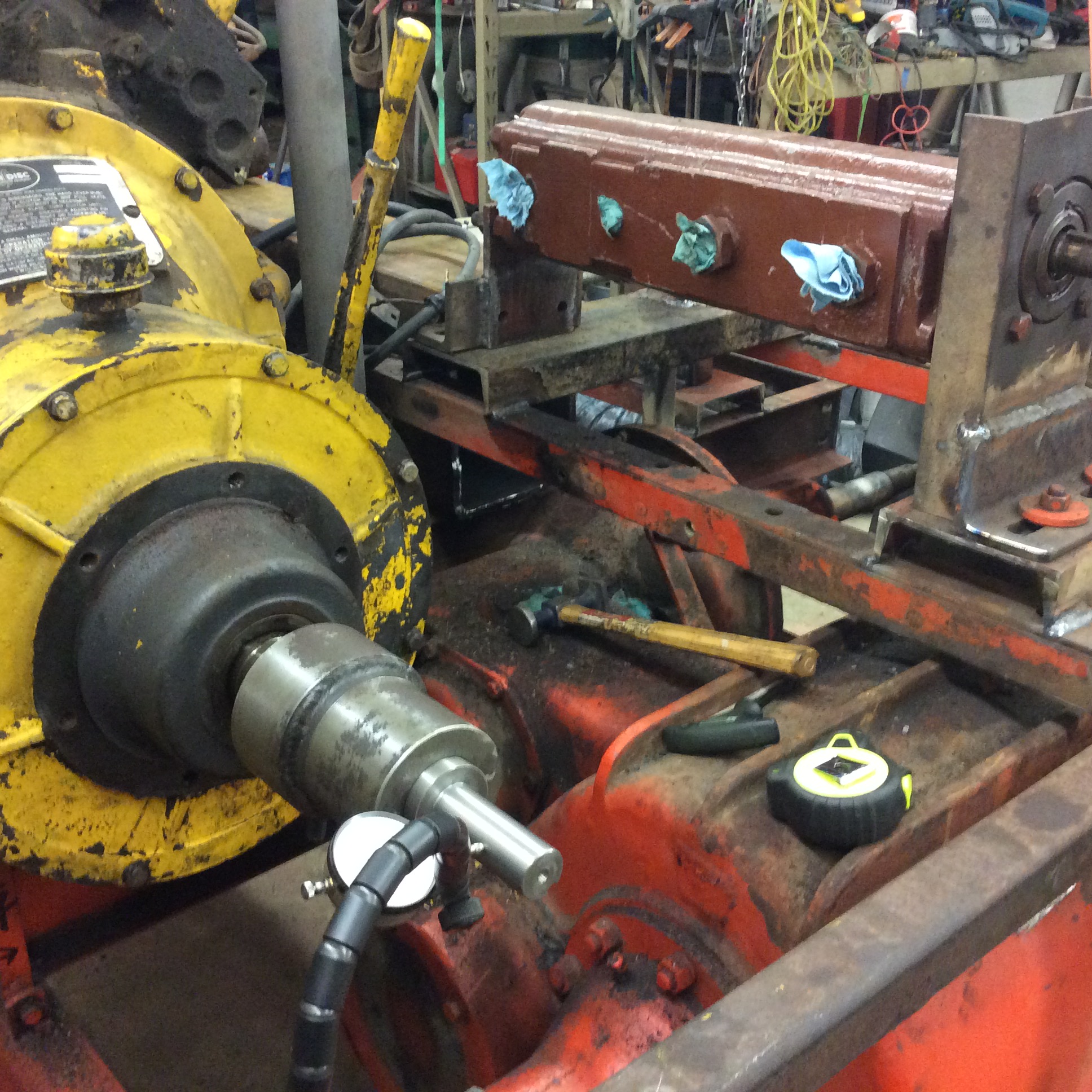

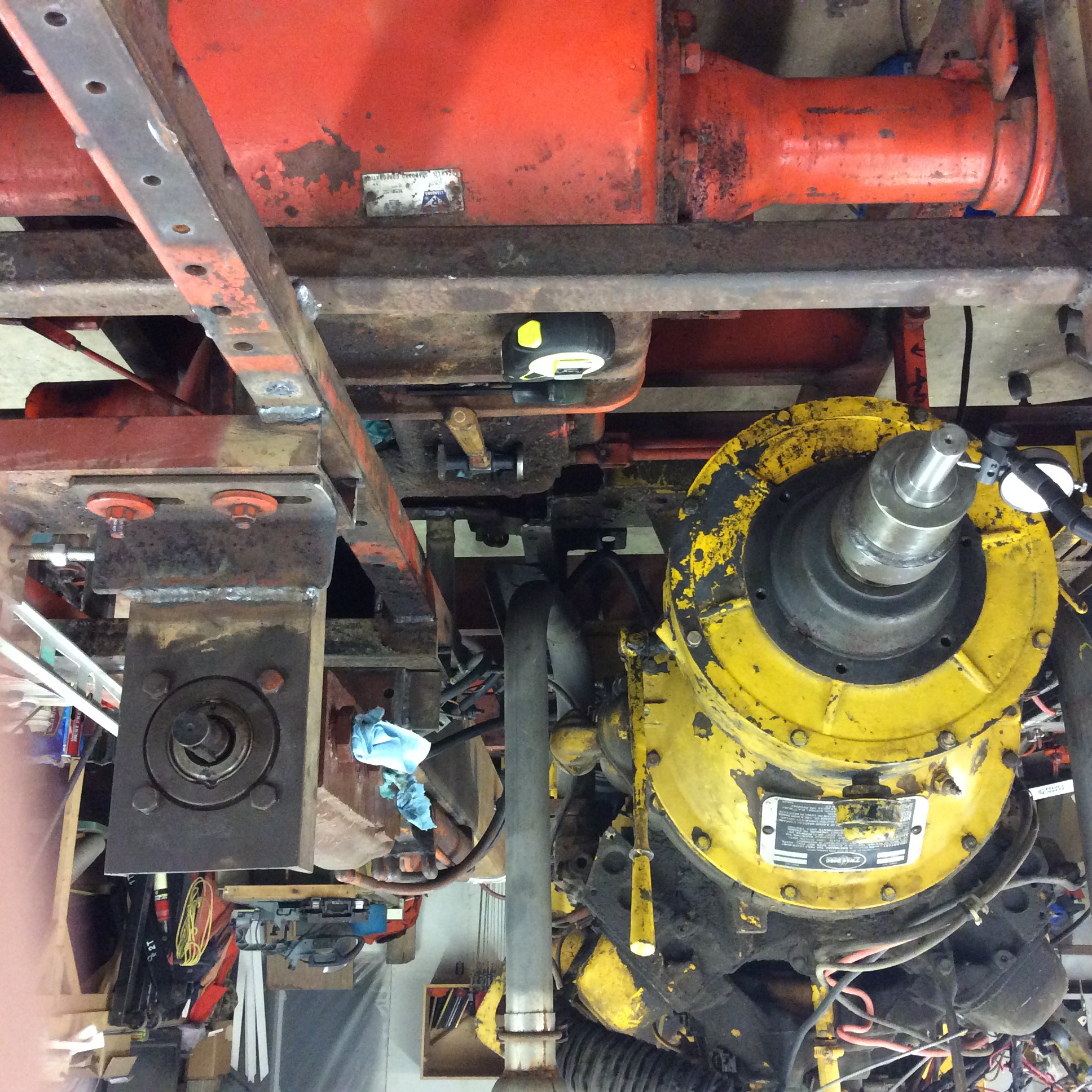

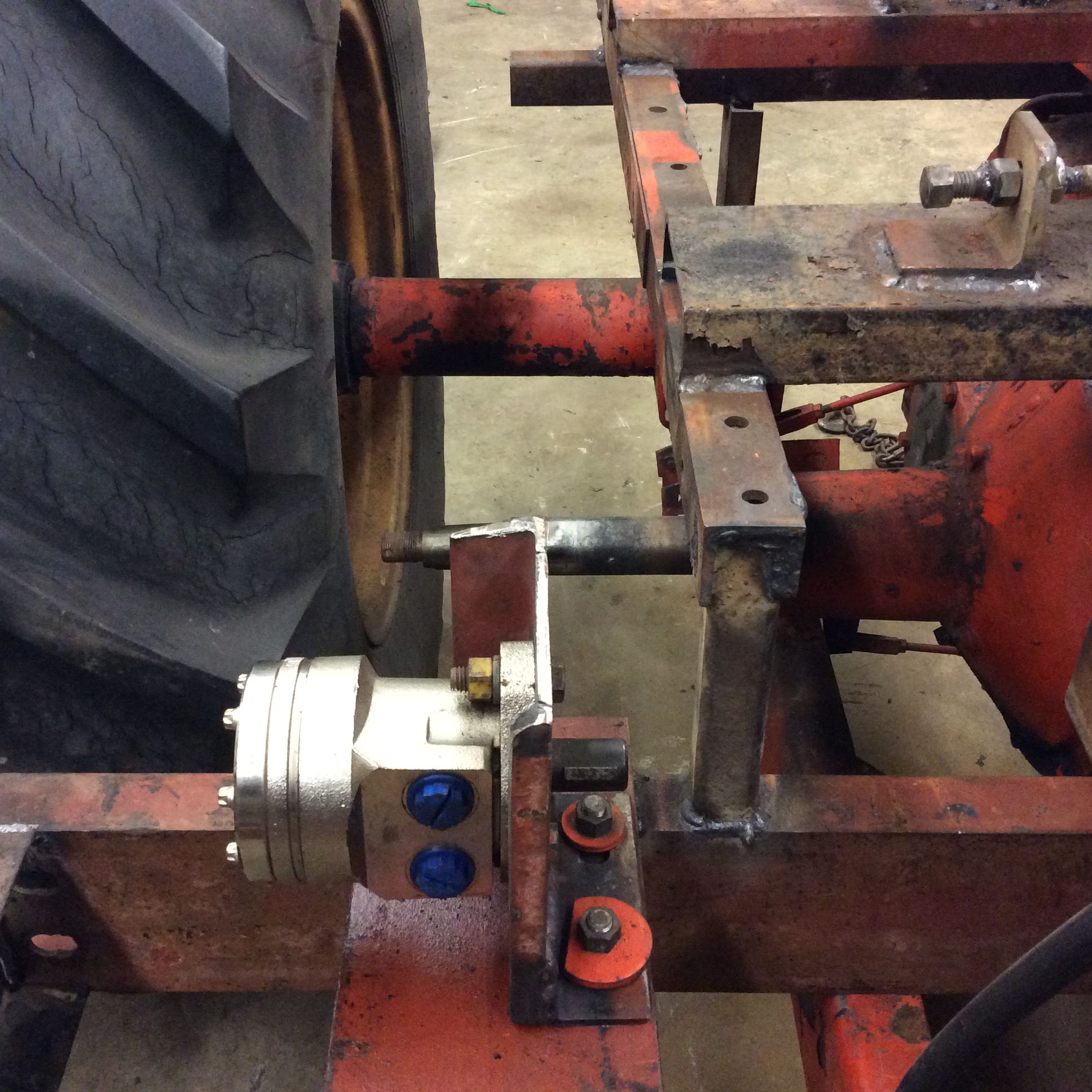

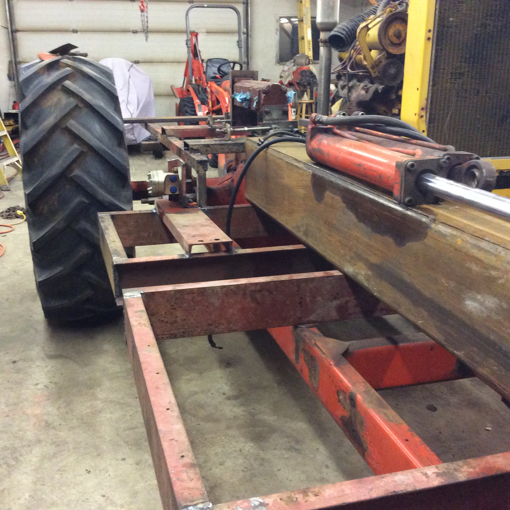

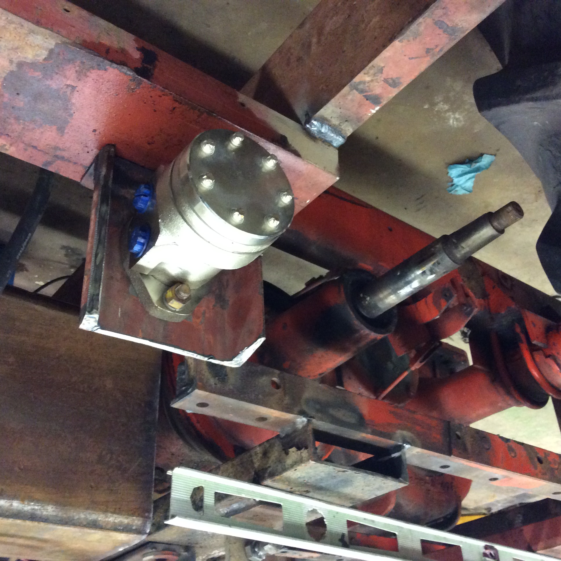

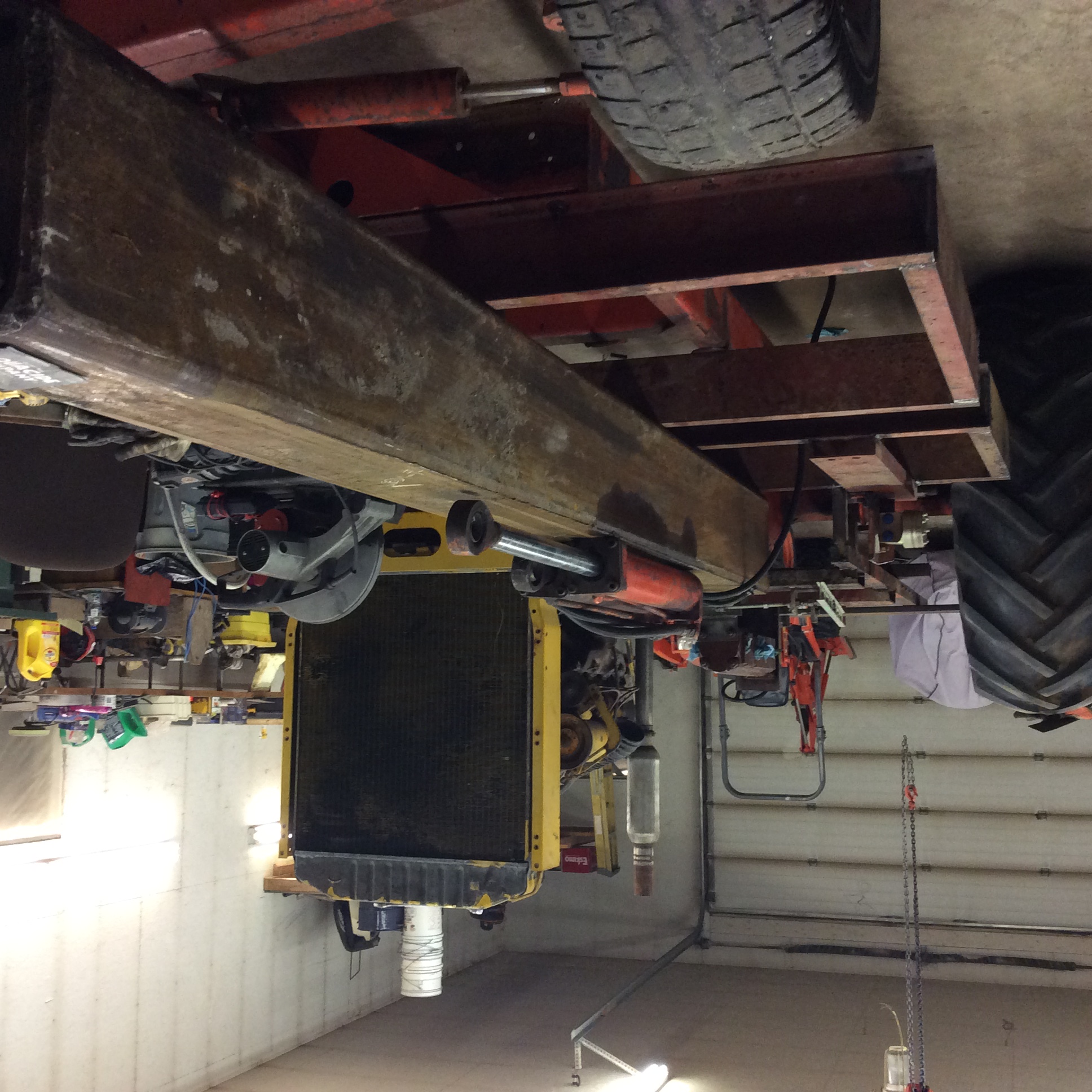

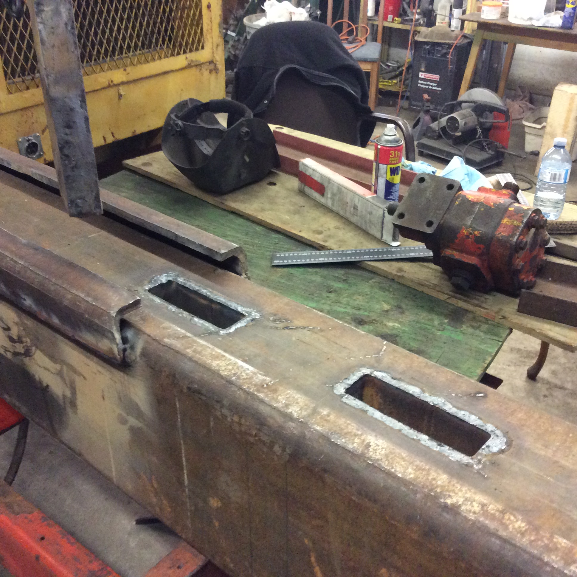

This is what I've done in the last couple days, put inserts in for the splitter wedge, I put two of them in so I can move wedge in future if needed, welded on the hold downs for the splitter slide, mounted saw arm and cylinder and put blade on just to take some measurements
For some reason I can't upload pictures tonite. I'll try again later
Lea
#58
Here are the pics I promised

Ya I'll have to build a guard for that blade or the safety police will come take it away on me
