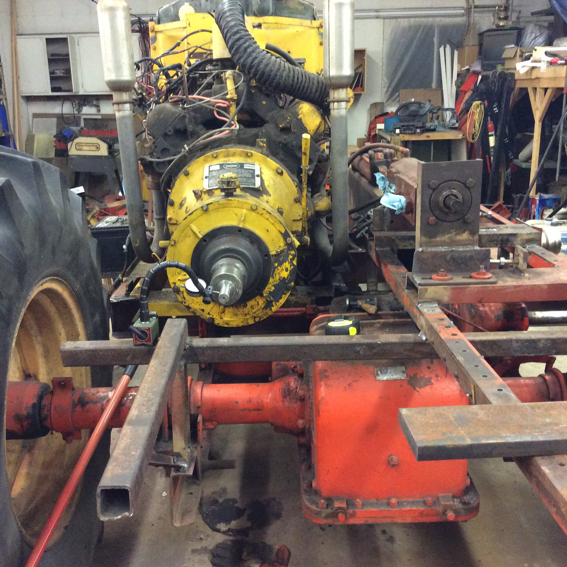

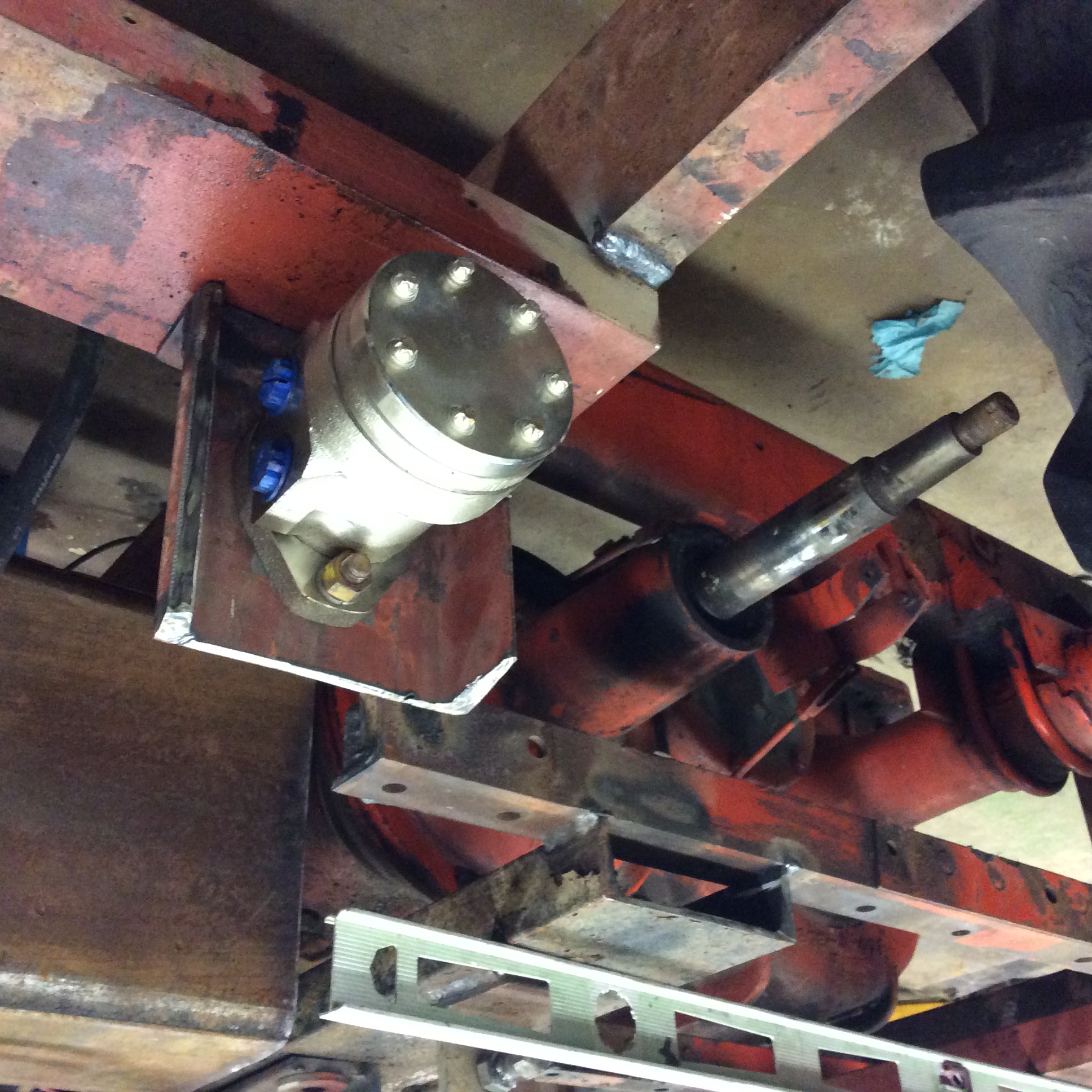

I plan on running 42" circular saw, splitter ram, hydraulic motor for live deck, hydraulic motor for propulsion, and a couple of stabilizer cylinders, hydraulic cylinder for saw arm and maybe a couple other things. If that one pump with four banks isn't enough I'll run another pump off the front of the crank shaft. But I'm thinking one pump should do it since there are only a couple functions that will be run at the same time. Does that sound reasonable to you guys watching or am I missing something
Lea
Without knowing the volume of the pump sections, the RPM that you will be running, what motors you are planning on running, etc it is really tough to tell. It is certainly possible.

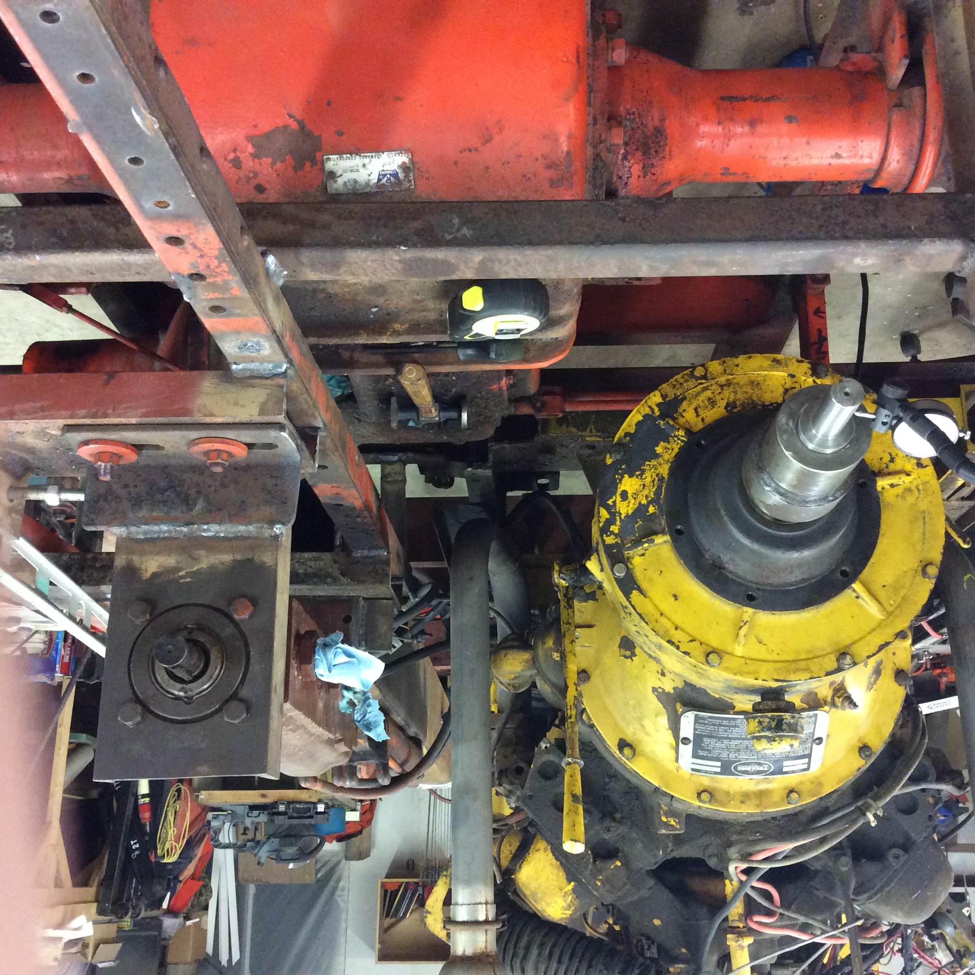

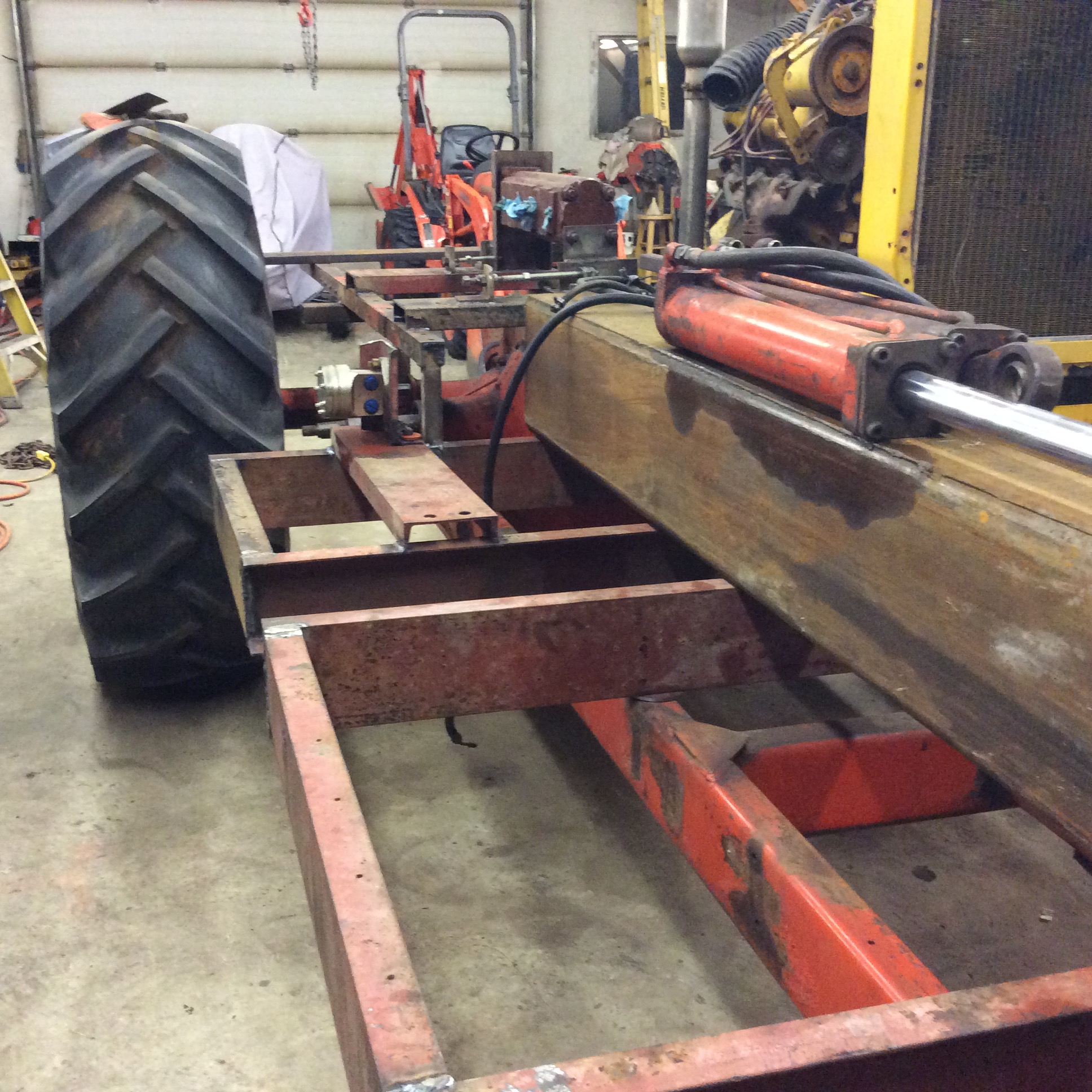

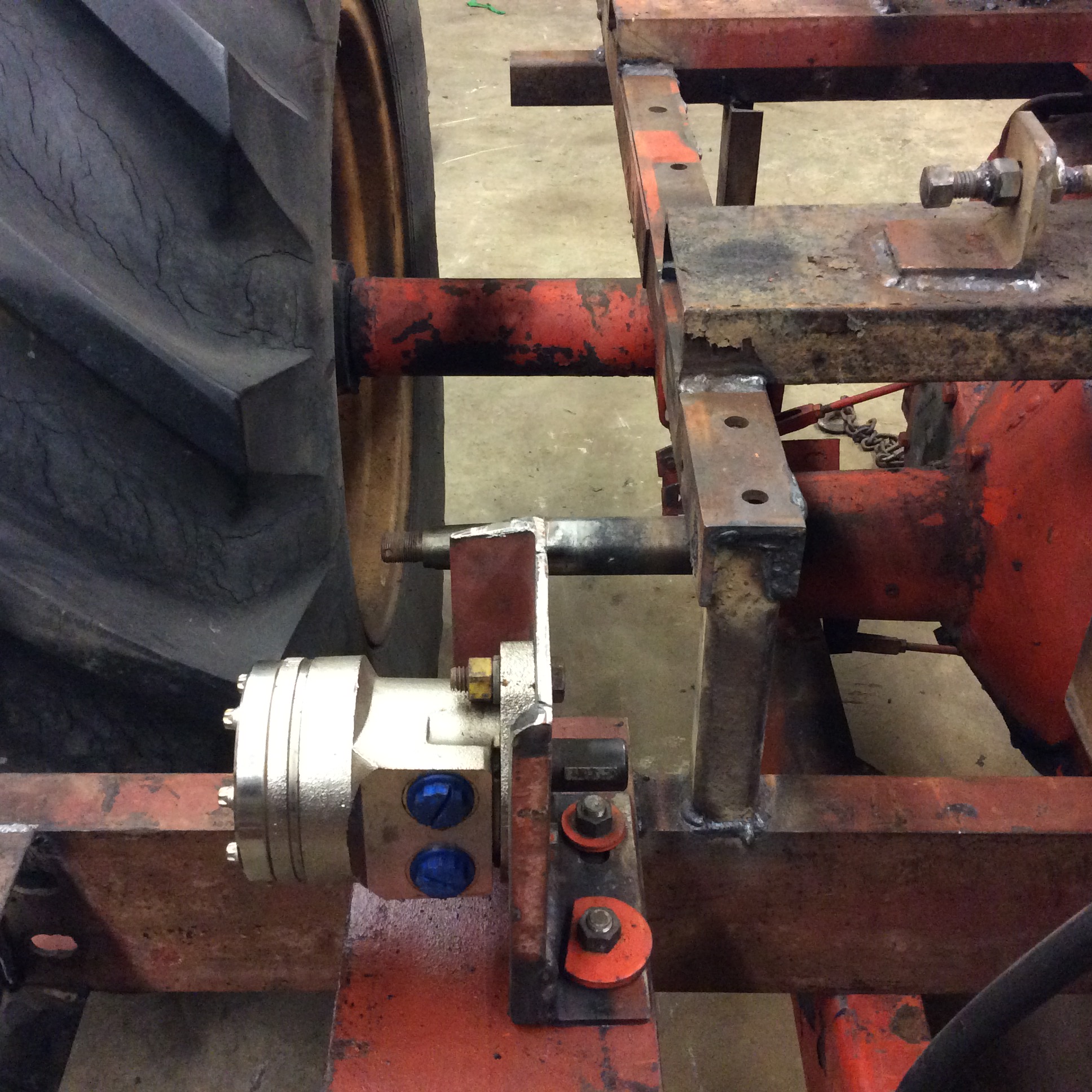

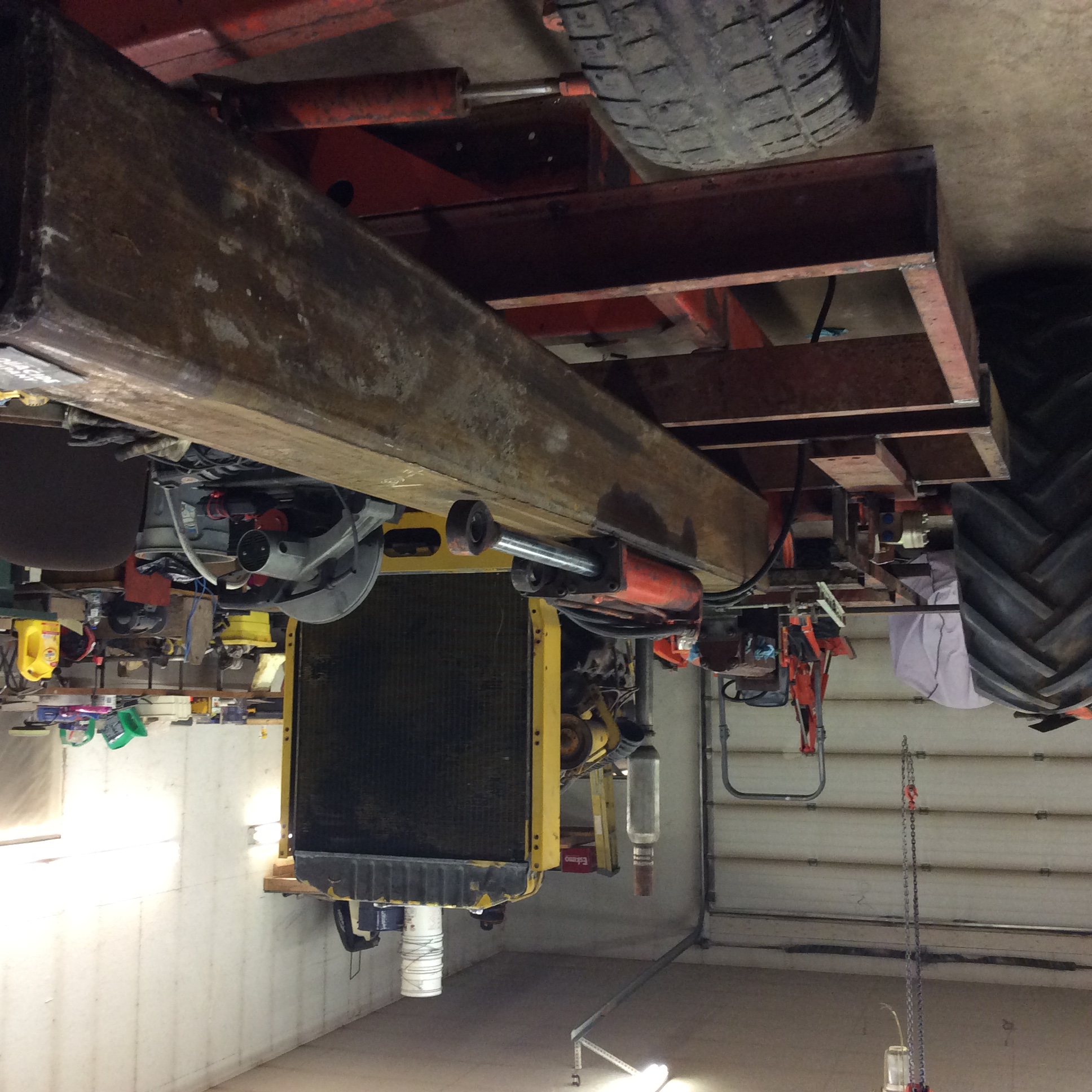

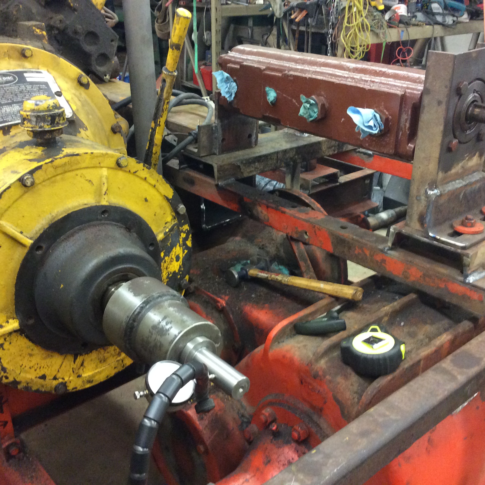

Here some pics of a bit of progress. I have hydraulic pump mounted, hydraulic motor for propulsion mounted and the splitter Belem laying in place
Been busy rounding up more parts, now I'm looking for a longer splitter cylinder, the one I have only has a twenty inch stroke,I think I'd like to have about 26"0

Looks like some beefy rectangle tubing you're planning on using for the beam. What is the wall thickness on that? Do you know how you are planning on running the pusher on it? Wrapping the pusher carrier around the beam / welding some stock on the sides to create a lip / something else?
/ My home made firewood processor
#27
I may weld some half inch square stock to the top edge of it or maybe heavy angle welded to the sides so it sits above top of beam half inch or so.
The beam is eight by twelve inches and half inch thick

Lea,
Looking at the pictures you posted I believe you have a 4 section pump. Do you know the displacements for each section?
On the propel/ travel circuit be sure to include some form braking or run-away control like counter balance valves. If not the first slope could be a wild ride.
