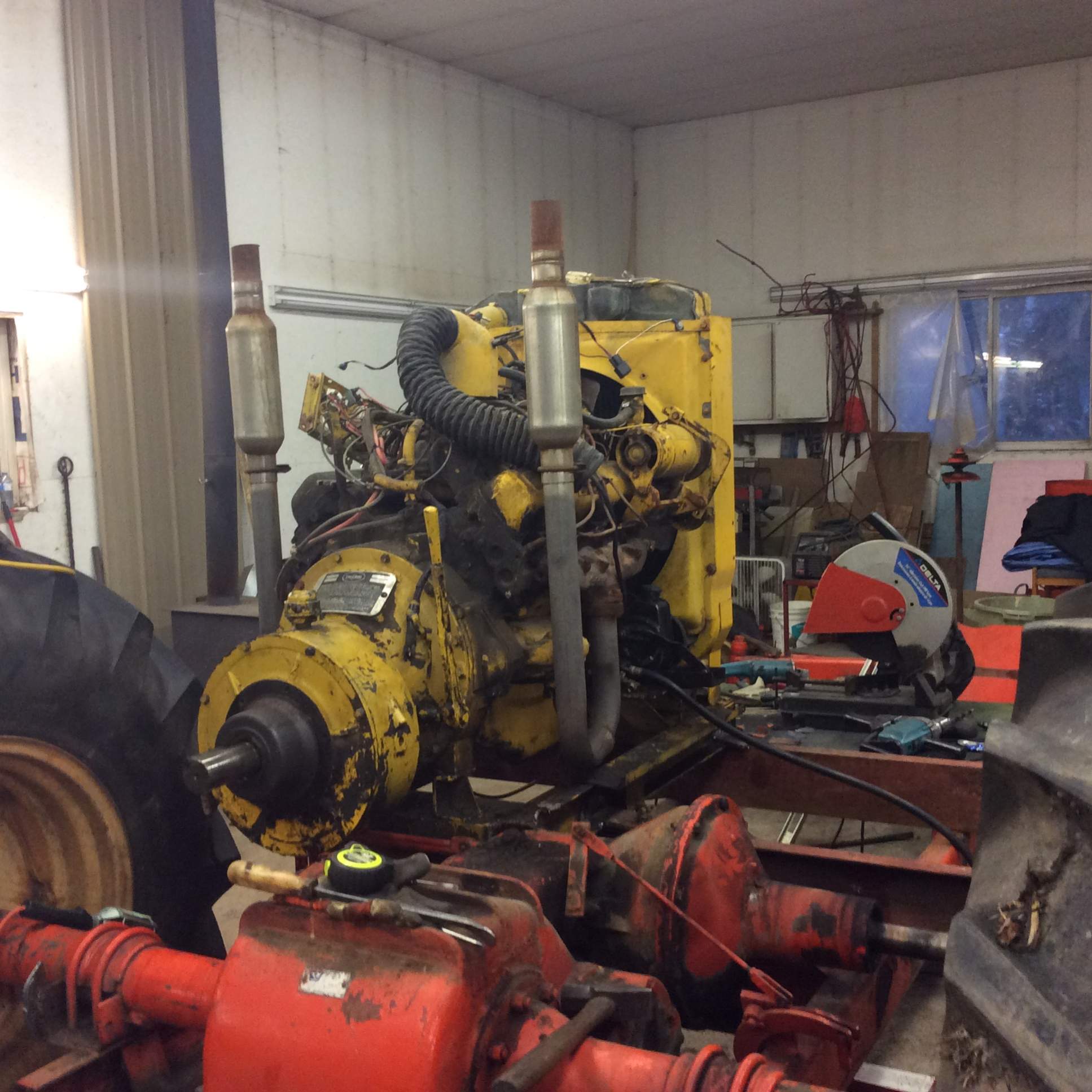

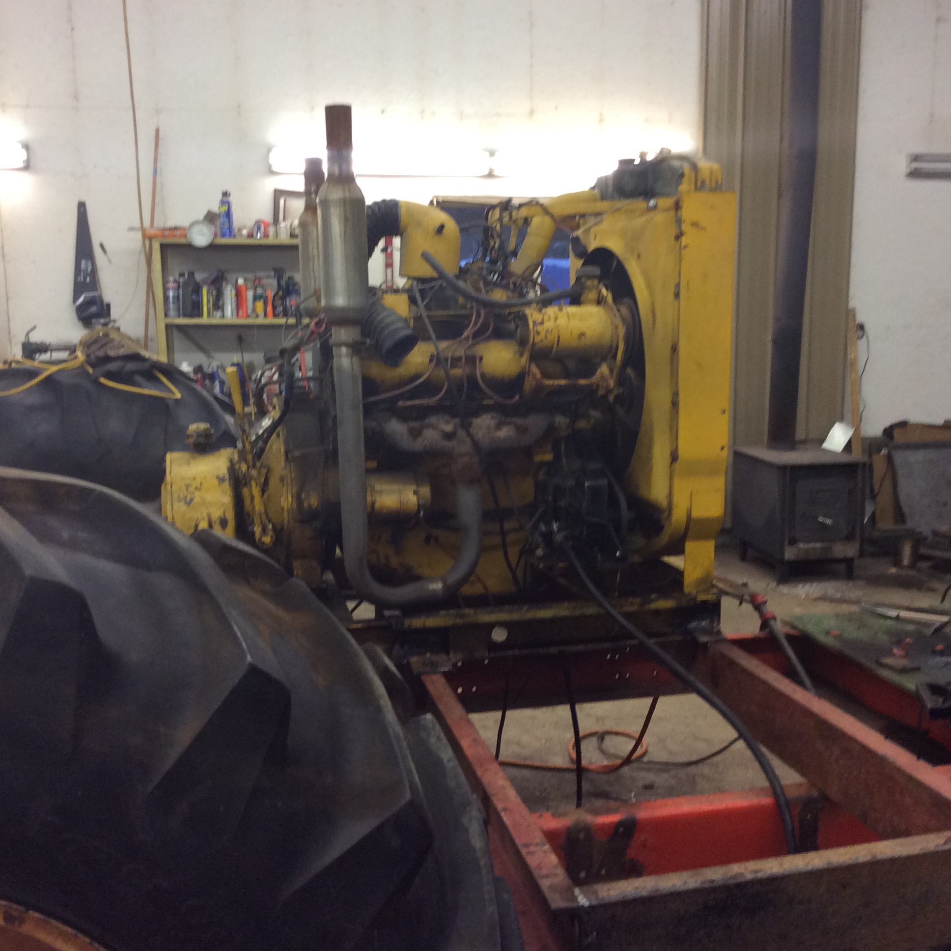

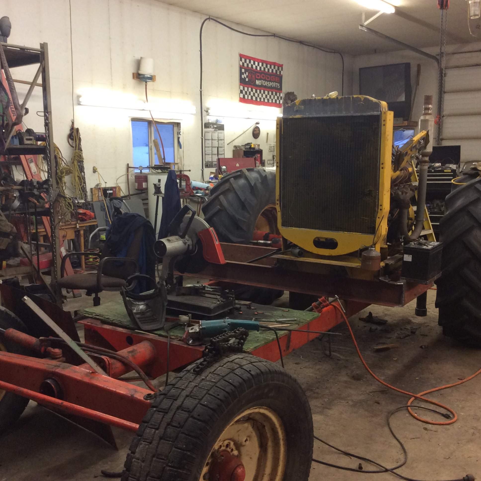

Well I finally decided I have enough parts to start my processor, I'm using a old combine frame and a V8 international industrial engine for power.
This is what I have so far

That engine looks serious! Don't think hp will be an issue.
/ My home made firewood processor
No I think hp should be good, I'm not sure what it is but I think it should be north of two hundred.
It came off of a nine foot industrial airport snow blower
It also is a two to one reduction on it
/ My home made firewood processor #5
I would sell that motor and buy something less thirsty. I don't think you need a 200 GPM pump.
/ My home made firewood processor #7
He said its got 2:1 reduction, so that's only 100gpm..... hahahhahaa :p
No, you'd just have to get a pump designed to run at a lower RPM. I'd mount the reduction the other way so you can run the engine slower to save fuel.

You guys should know I only burn about two cords a year out in the shop, I have in floor heating with a lake source heat pump, so.... I'm just doing this for fun because I can , but that being said it is nice to talk to other people and get their ideas. I'm trying not to spend anymore money than necessary, I'm only using what I have in stock so to speak

Ya Wild Bill that is my intent is to run everything off of that one pump, that includes driving it around the yard with a hydraulic motor running the drive gear on the frame. (Old combine )
/ My home made firewood processor #17
Using one pump might be tricky. You'll have to employ a flow divider of some sort (or maybe a couple). We have 3 pumps on our processor. One for the saw, one for the splitter (a dual stage) and one for all of the misc. cylinders.
What all do you plan to run off of hydraulics?
Interesting idea to have the processor be self powered rather than on a trailer. If you have the frame and the drive train, why not.

I plan on running 42" circular saw, splitter ram, hydraulic motor for live deck, hydraulic motor for propulsion, and a couple of stabilizer cylinders, hydraulic cylinder for saw arm and maybe a couple other things. If that one pump with four banks isn't enough I'll run another pump off the front of the crank shaft. But I'm thinking one pump should do it since there are only a couple functions that will be run at the same time. Does that sound reasonable to you guys watching or am I missing something
