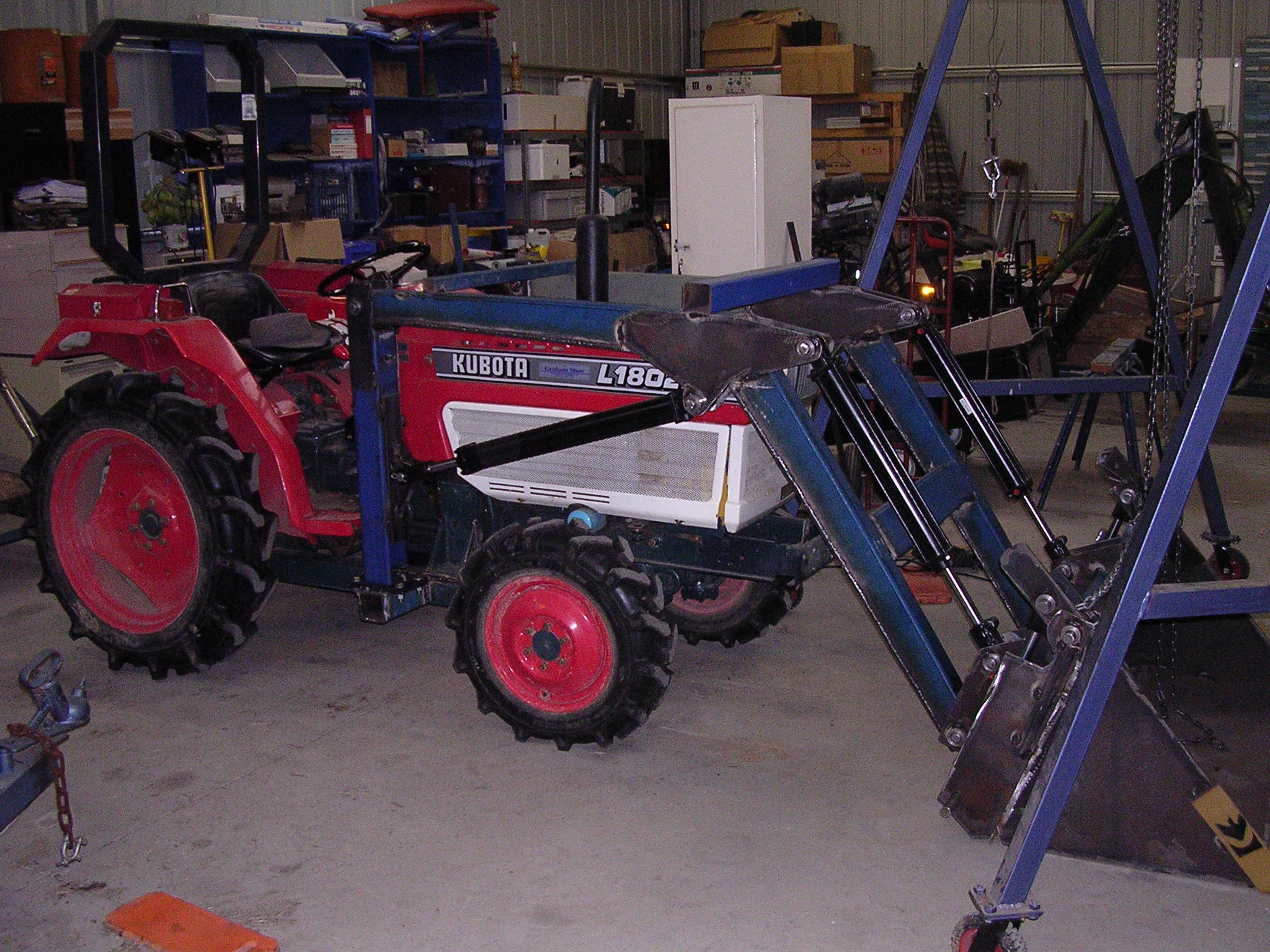

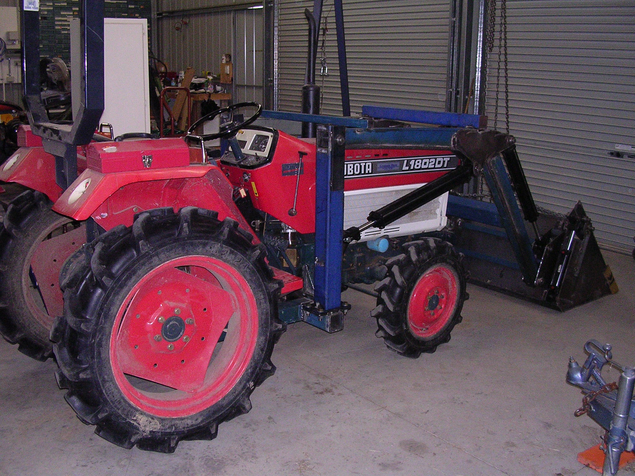

I got a little work done yesterday, whilst listening to the radio about the bush fires we are experiencing here.
Saturday was our hottest day ever 46.4C (115.5F) and it was madness to even venture outside, but of course that's just what fire likes.
So far there are 108 confirmed dead, but that will rise as people return to the burnt out towns.
You can read more about it here
Anyway, a little more progress.
Cheers
Rohan

You may have to add a support bar from the vertical post to the front bumper. While the subframe looks beefy, the vertical to the subframe is a weak point. My MF135 has like a 2inch thick bellhousing x 4 5/8 bolts and they still brace to the front attachment plate, or rear axle housing.
   / My Home built Loader
#68
Oh, yeah I just havent got to that bit yet :)
It's just sitting there to check for overall fit, just in case I had to change something.
Cheers
Rohan
