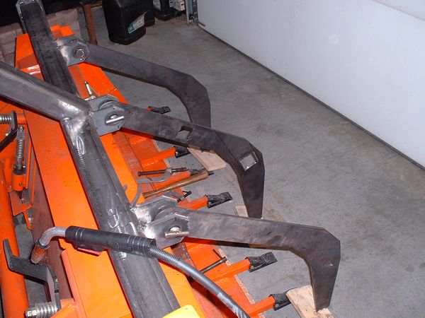

Part 4 - Moving right along
Good evening everyone. After attaching a few gussets to the bottom tube, it’s ready to be remounted. (pic 17)
Bill

#37
Time to finalize the cylinder mounts. Once in place, they were tacked, I mounted the 2 x 8 cylinder from TSC. (pic 18)

/ My Grapple Project (part 1)
#39
Part 4 - The moment of truth /forums/images/graemlins/shocked.gif /forums/images/graemlins/laugh.gif
First test, grapple open, PASSED. It gave me an opening of 33” from the floor to the tip of the arm, more that enough to grab a log or pile of brush. If I can grab a log with that diameter, I probably won’t be able to lift it anyway. (pic grapple open)
