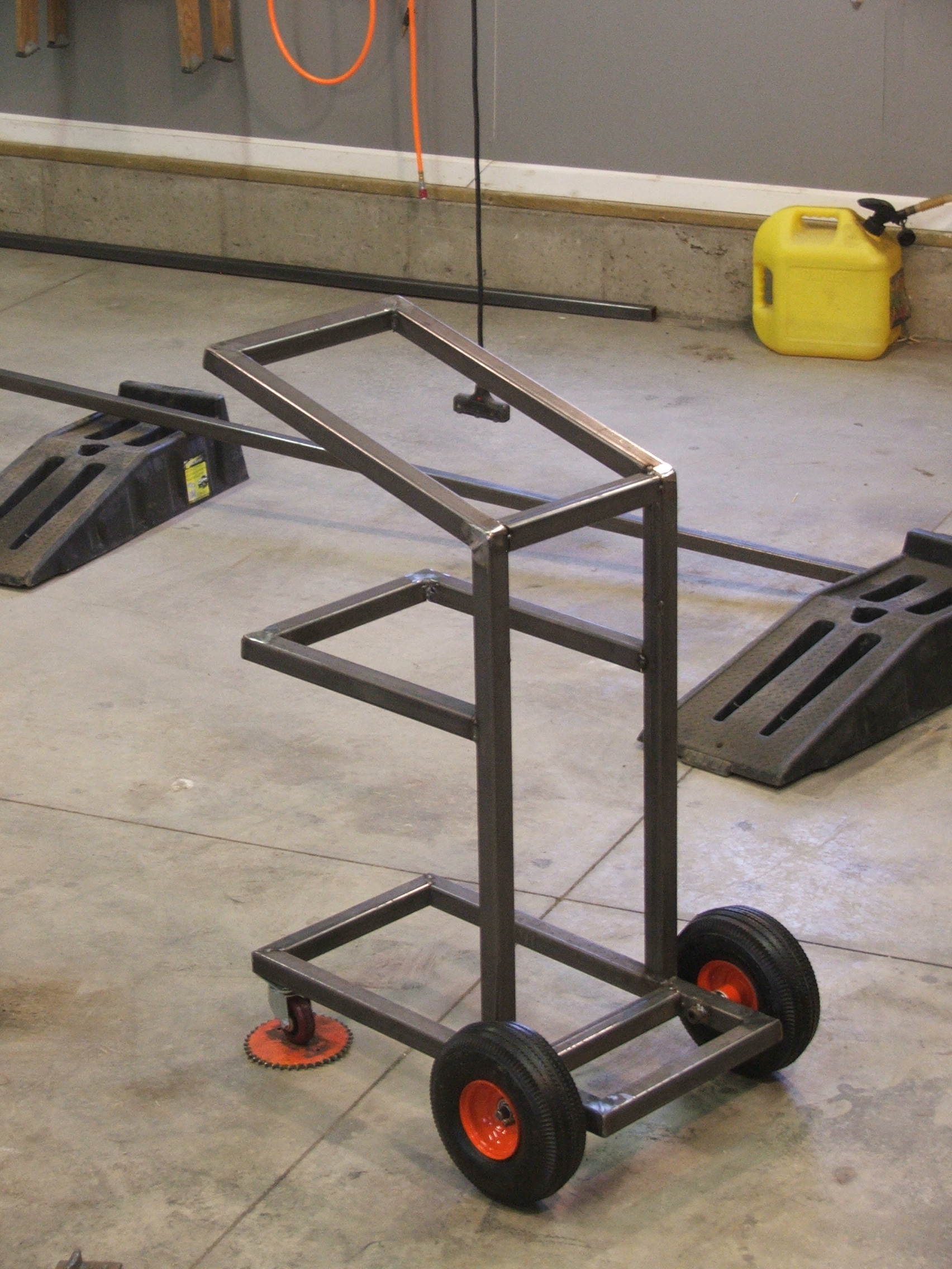

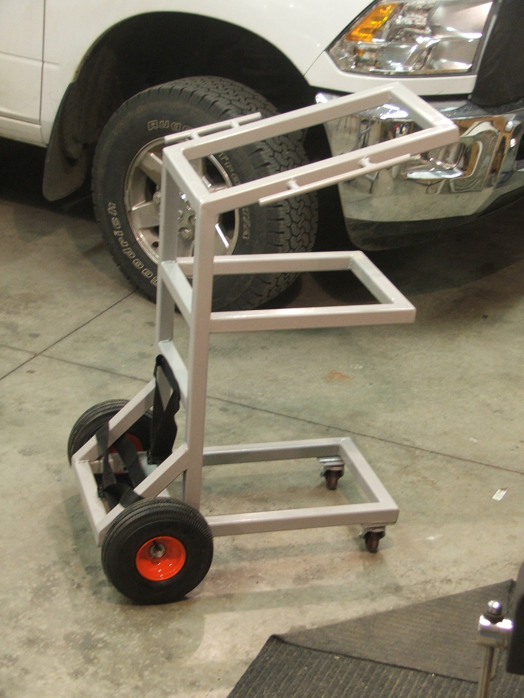

I just got a Hobart 210 MVP welder, since I did not have a cart for it I decided that would be a good first project. I am not finished yet, still need a few gussets and something to hold my 40cf bottle.

nice job !!
/ my first welding project #3
Looks good. Nice to make something yourself isn't it.
Be sure to make the caster plate parallel to the floor, or they will not want to turn freely.

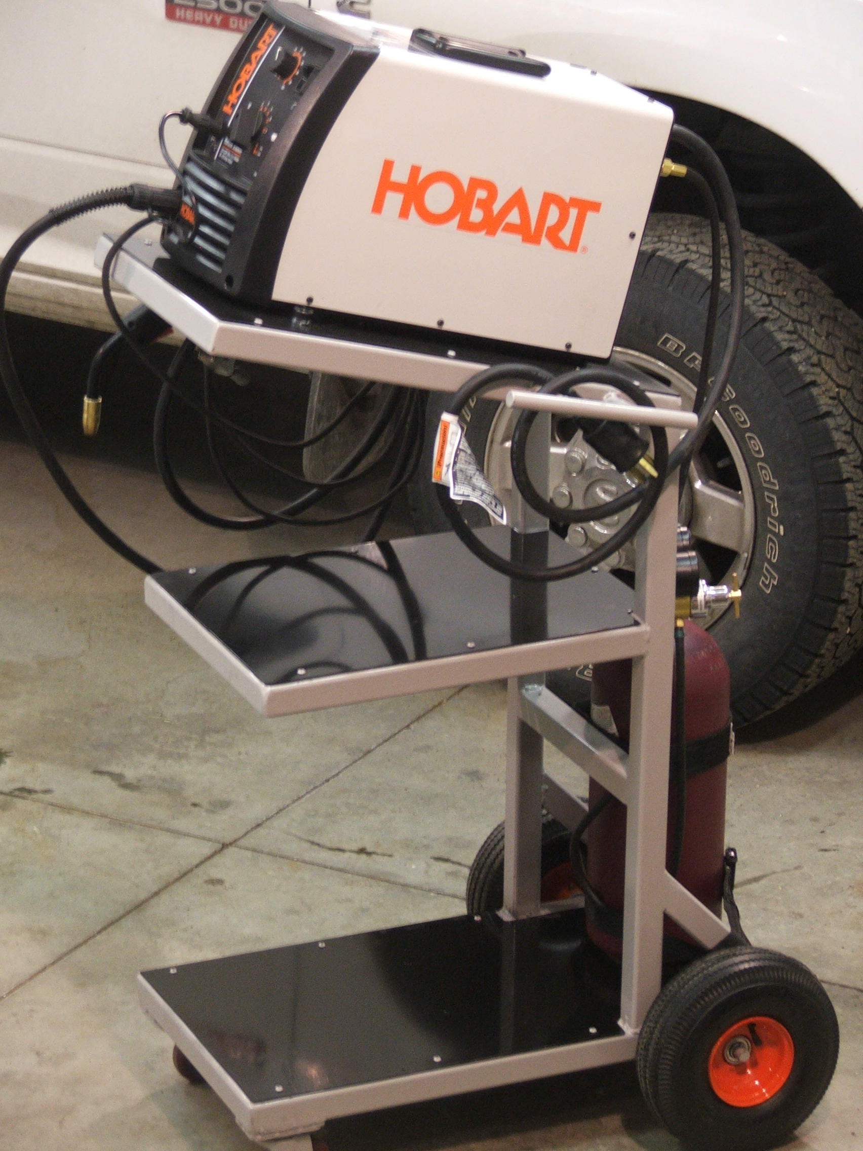

making some progress, just need to cut some sheet metal and paint it for the shelves and improve the bottle holder. would like to find some Hobart stickers so it looks factory.
/ my first welding project #8
Good project. I'd suggest going to at least an 80 cu. ft. cylinder so it will last longer. I bet the price difference would be minimal as well. When I expanded your picture, it looks like you were burning a little cold. Try turning your wire speed and volts up a bit and with the type of MIG welding you're doing, it's always a good idea to twist your wrist side to side or go in circles to be sure you get proper fusion on both sides of the joint.
