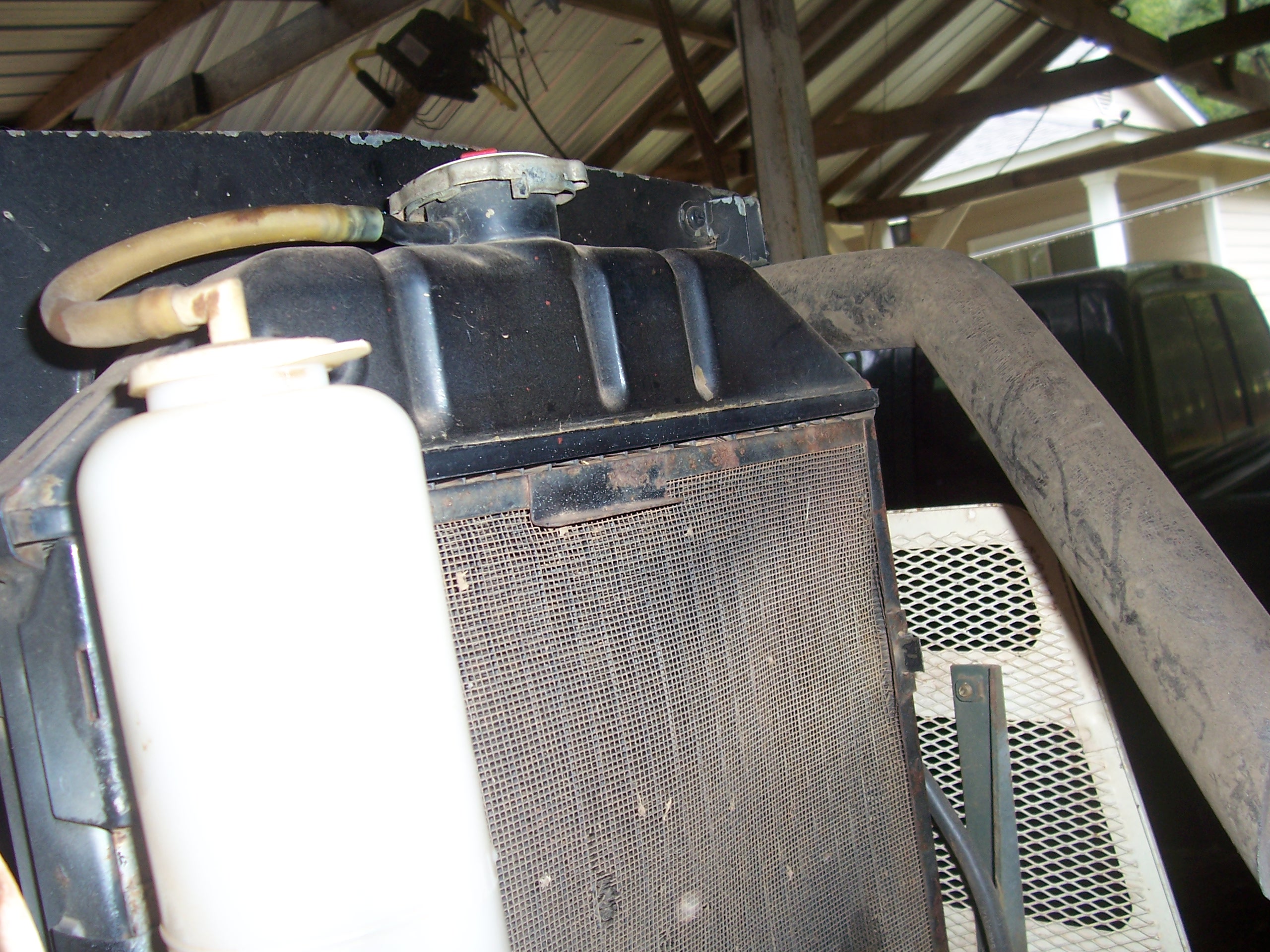

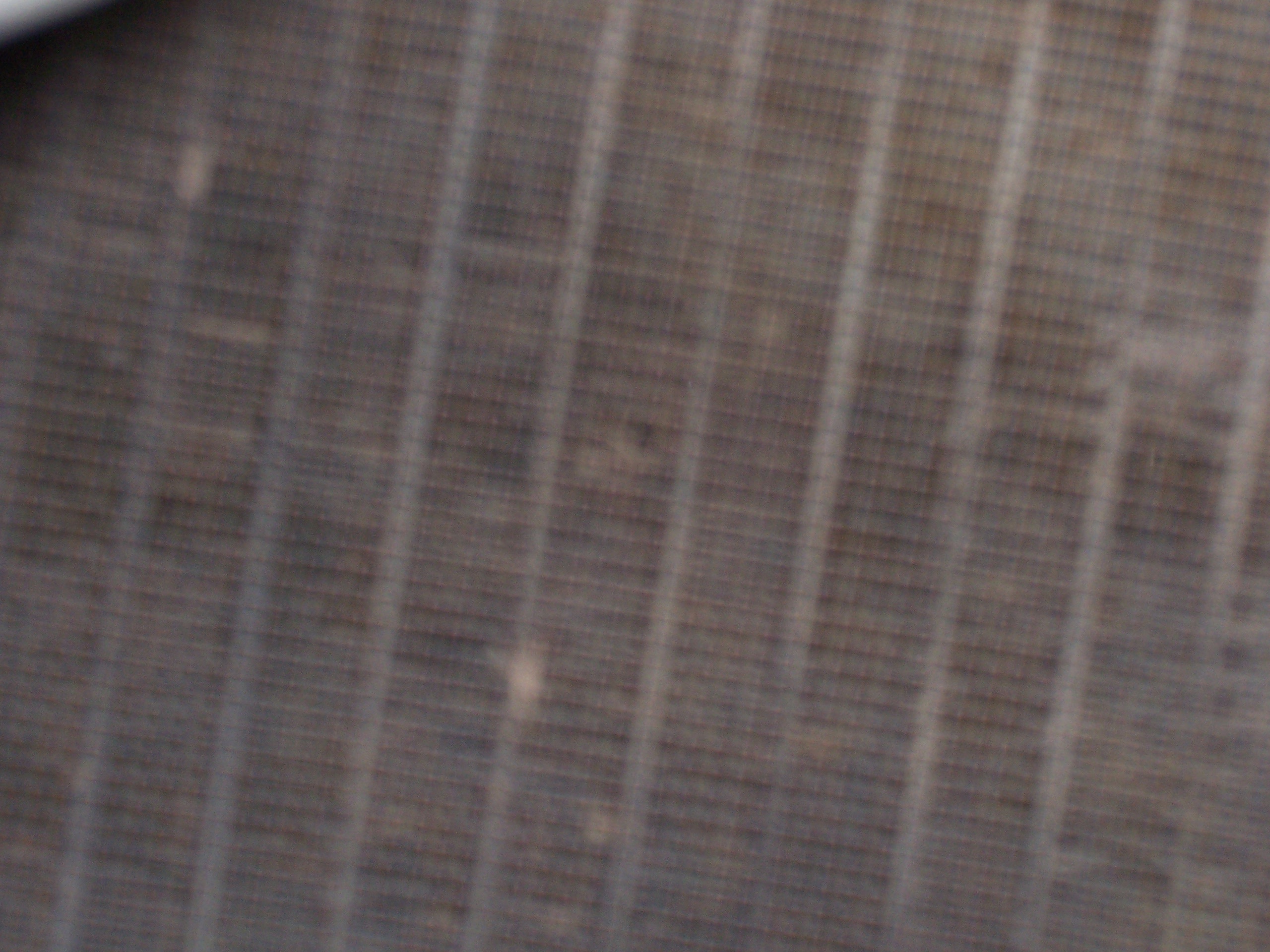

My BH. which I call the beast is 4'. I don't use it to mow which I have. But never have had to run over 2100Rpms. even the FM. You have lower Hp. so you may have to. Here you go for the screen setup. Only takes a couple Min. to stop and clean it. and get on with the task on hand.

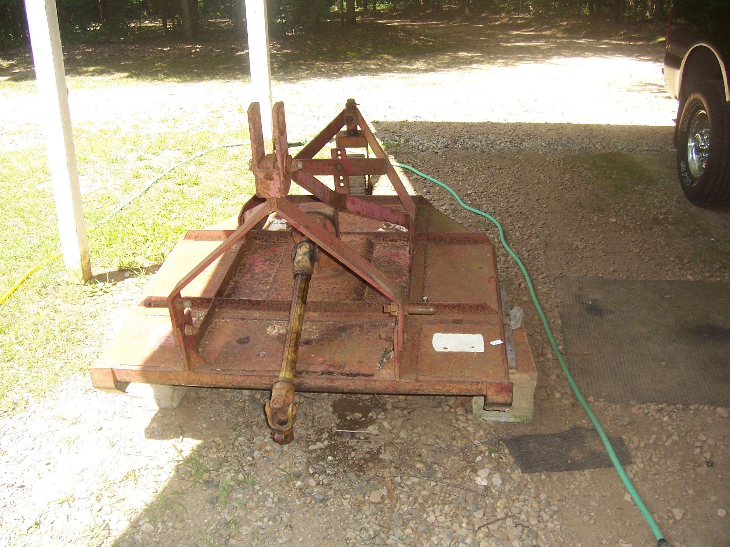

Awesome, thank you! "You don't use it to mow, which I have??" I'm confused haha....So you do or don't use it?/
That is literally the EXACT same bush hog I have now! It is pretty darn heavy duty! I need to get a screen bad. I do not think my new radiator from Hoye has the clips to hold it in though....

Yeah I think I may have been running a little lead-footed too. Seemed to do just fine around 2000-2100. I'll probably keep it to that from now on.

The screen just clips on. You can make do that won't be hard to do. If you look about 8" down on the R side of the Radiator in my pic. that is were the clips are. you can see the Blk. flap. Hoye I believe shows them in the 2000-1700. Eng.-Cooling. You should see the slot were they slide in on the Radiator. Had to check the 2000 on Hoye and they show the screen and the clips on the Radiator. I'd be figuring out how to make it!!
And no I don't have to use the BH. around my place that much. In Spring and Fall. But actually my 2000 is my lawn mower. I ask my self what was I thinking yrs. ago? But honestly I was young and a great way to hide from the wifey ;)

Got it, I'll have to figure something out for a screen. My radiator is def different than the one I took off. THe top and bottom piece hang way over the fins so there is not room to just slide a screen down in there. I'll think of something. I think a big part of it was that I had left side engine cover off too which I'm sure did not help to keep stuff out.

I have an after market radiator in mine. So unless its different from the one you have im not sure why you dont hve clips as mine does...i cant imagine there too many aftermarket suppliers. Plus hoye is pretty good at replicating things.
Cary when you get in stuff like he is cutting over 2000rpms is a must. Or slow way down i guess. I have mowed stuff so thick it chokes me down in 6th topped out. Just draggs you down tractor rolling coal. Really thick bahaia or knee deep bermuda is the worst.
