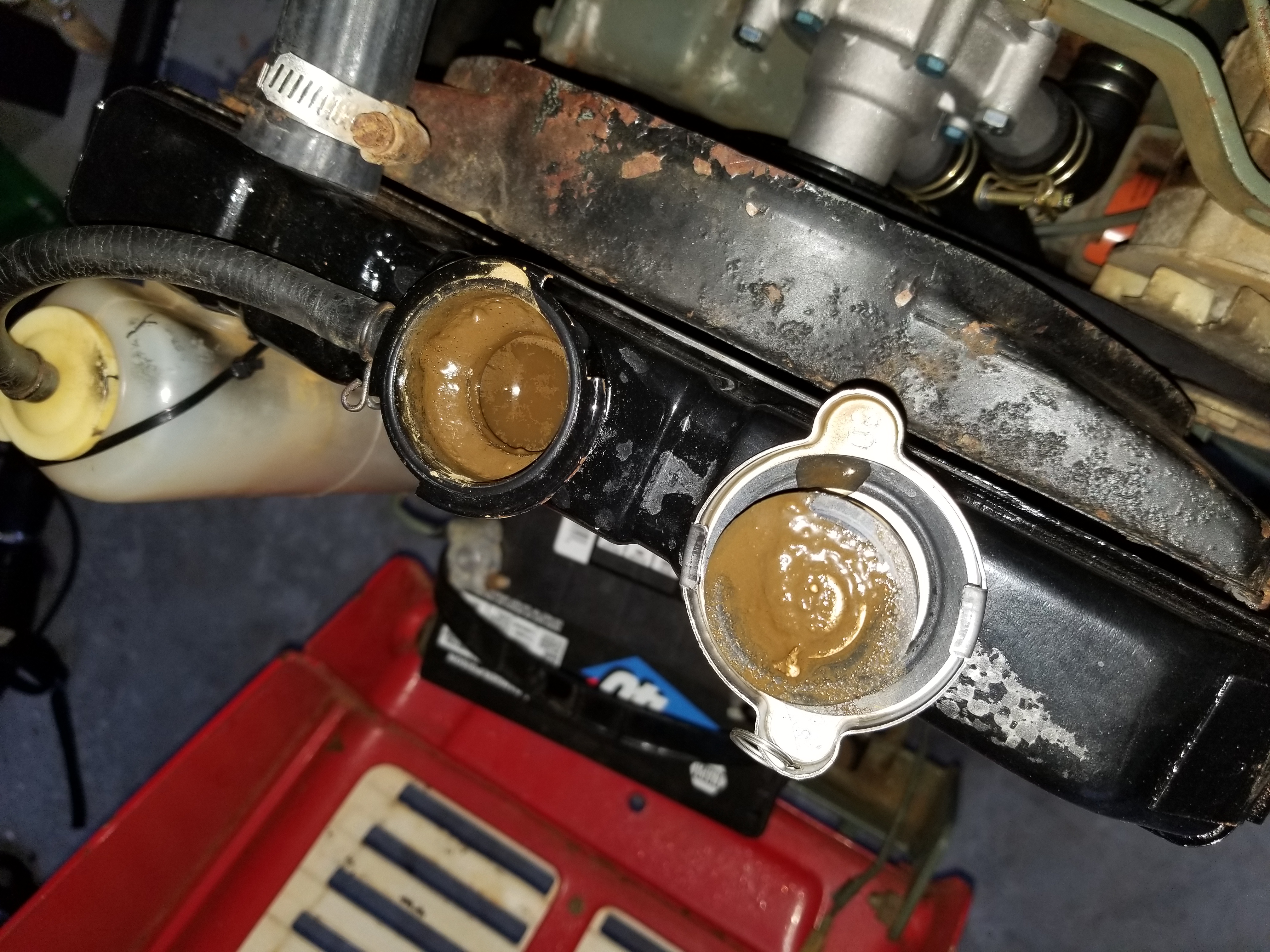

After wiping some more out, it's full of "sludge" or rust/dirt particles. Just smells like dirty water!
   / My First Real Tractor! #202
Looks like oil mixed with water, I hope not. If you have no bubbles and level is being maintained I would try flushing to see if it clears up but I do have doubts. Can't imagine that kind of crud being in your system with a new radiator and water pump.
#203
What's the best way to flush this thing now with the water pump on there?
#204
Winston that was my first thought too. Oil in the water. But it literally is not oily in the slightest bit. Wipes right off and leaves the paper towel looking "muddy.". Not a single trace of oil feel on your fingers. Not even the oily feel from antifreeze.
#205
Also, again it was always super clean, even in the old radiator, before the water pump. Always.
#206
Also, oil level has not changed. Nor has coolant level.
   / My First Real Tractor! #207
Flush until you get rid of it "or " until you can't get rid of it.
#208
Haha alright I'll try flushing it a bunch tonight. The only reasons I really do not think it's oil is because there is no oily texture at all and it was always clean fluid before the first time running with the pump. Sorry if I'm redundant everyone, just coveraing all basis and giving as much info as I can for y'all's feedback.
#209
Good news is it's not oil. But my driveway looks like I just washed a muddy four wheeler. I think I found out why it was overheating in the first place haha. ALL KINDS of crap coming out. Literally like freaking dirt! I keep flushing and then running it and then flushing. It's clearing up.
