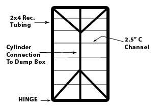

Great job and well documented. I have looked at your build before. Nice job.
Here is how I'd like to do the dump box frame. I want to distributed the pushing and pulling throughout the box with as little weight as possible.
/ My First Attempt at a Dump Trailer #9
If the ground clearance wasn't an issue, you could move the "hinge" a little forward of the tailgate. This would mean less force required to tilt, but would leave the tailgate pretty close to the ground.

#11
Mike, I have figured already on having a 12" hangover past the hinge. That puts my length from the front to the fulcrum at 13'. I will have to verify that I have this clearance but I think I will be ok.
Meburdick, I understand what you are saying. My goal on this was because the initial estimate on this will have a significant tongue weight already. I will have a 4' front wall, a 10K winch (100#), the battery, the hydraulic pump, plus the dump bed frame. This is without anything loaded in it.
