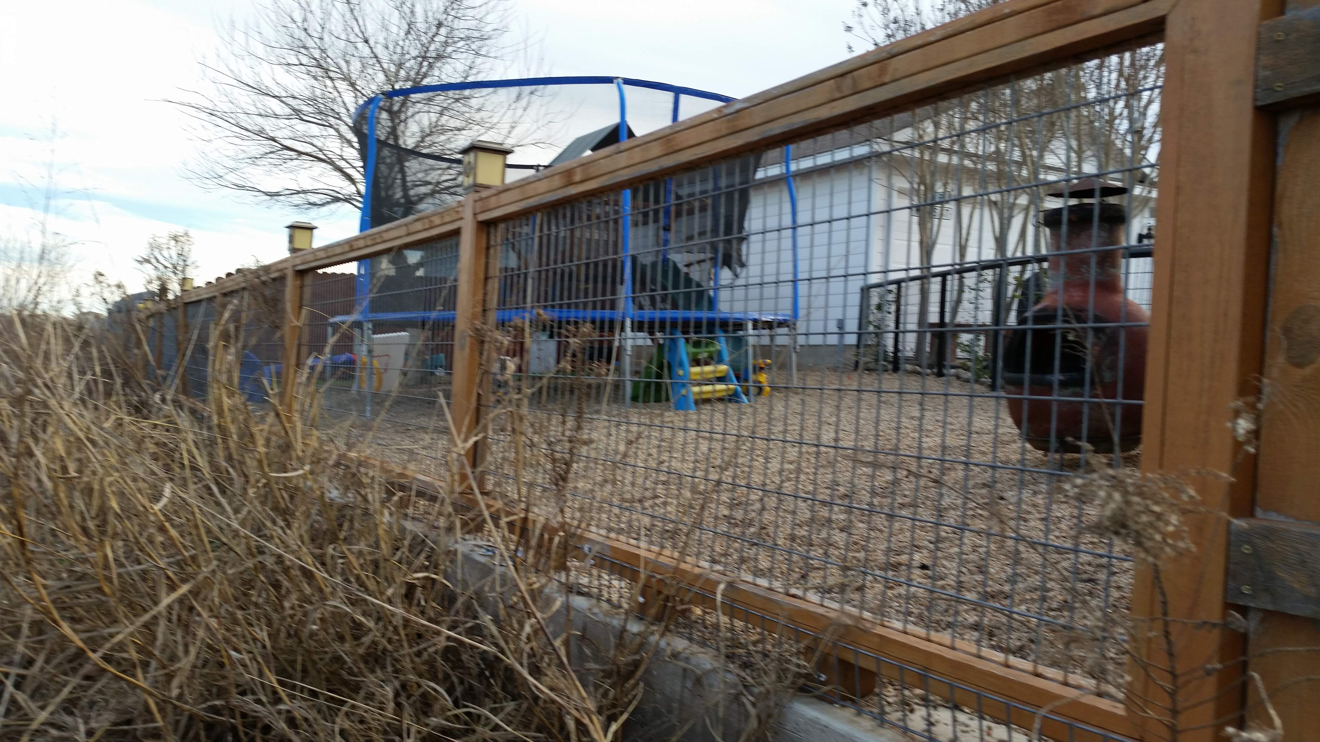

My daughter usually comes up with unique requests for her birthday. She now asks for a fence across the back property line of her home. Not any wooded fence, but a wire panel fence. Something like this. 1-24-15 Fence Rebecca Wants.jpg

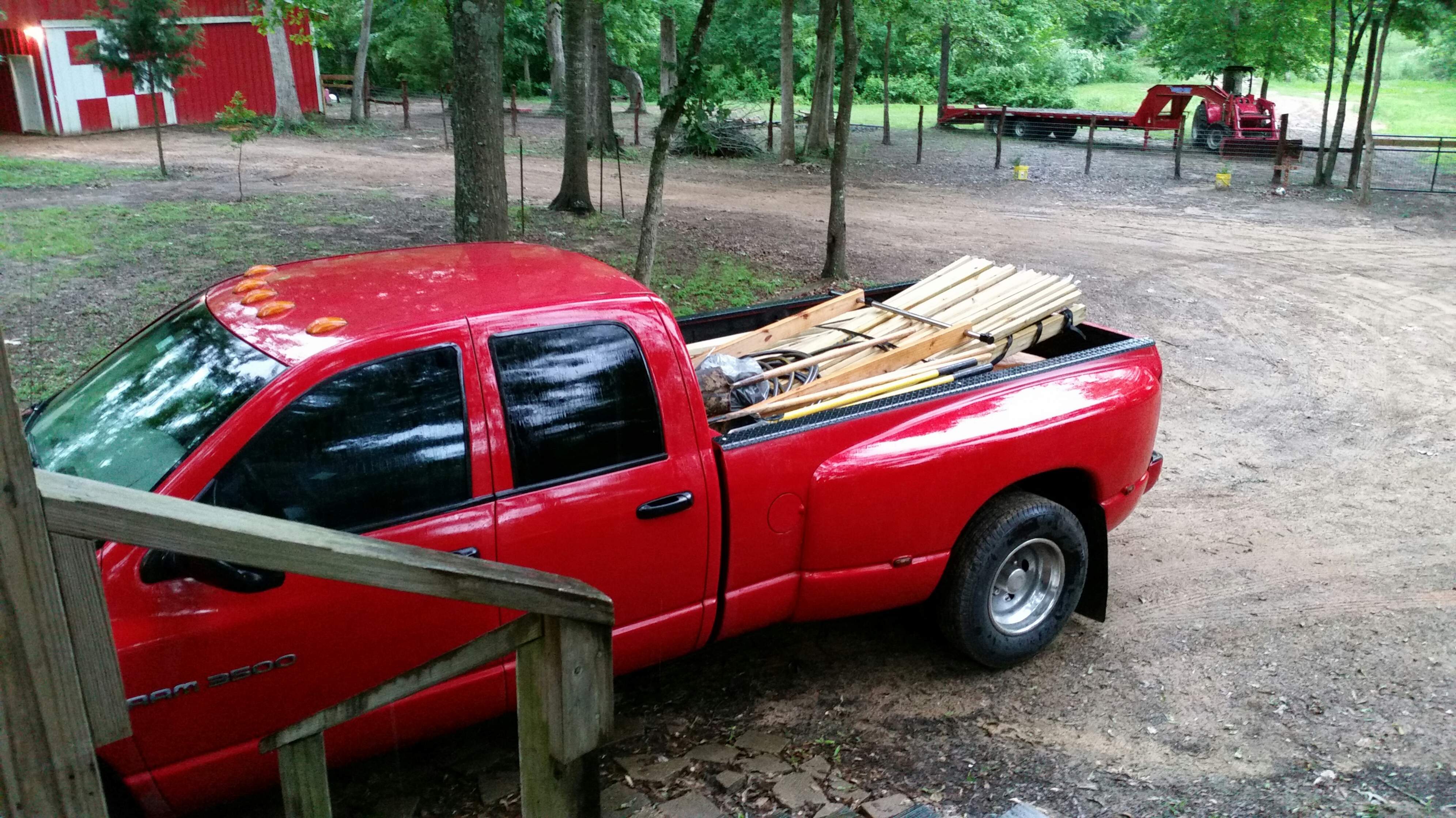

So, this last weekend, my Son and I loaded up the truck and drove to Manor.4-24-15 Truck Loaded and Ready To Go.jpg

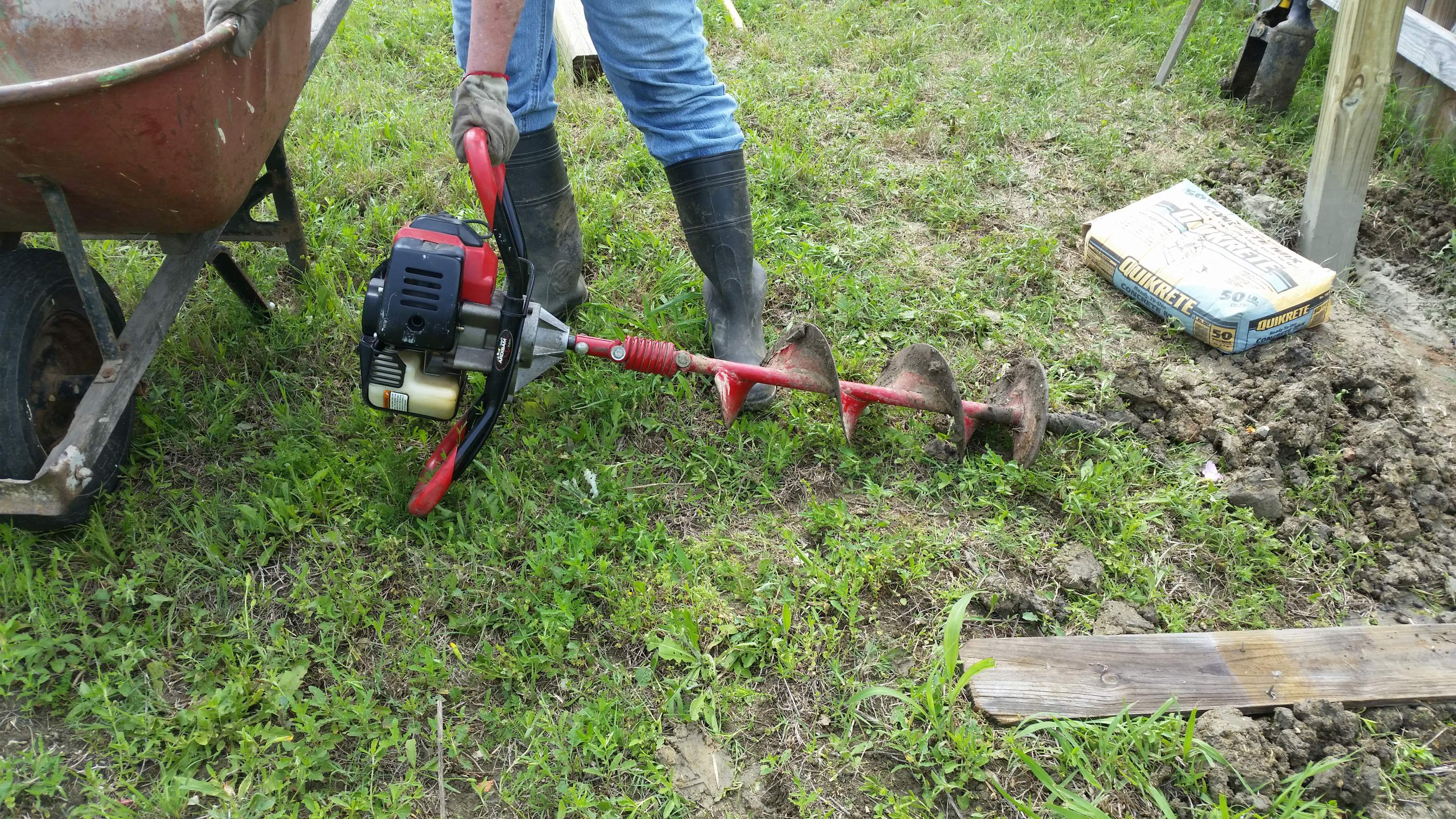

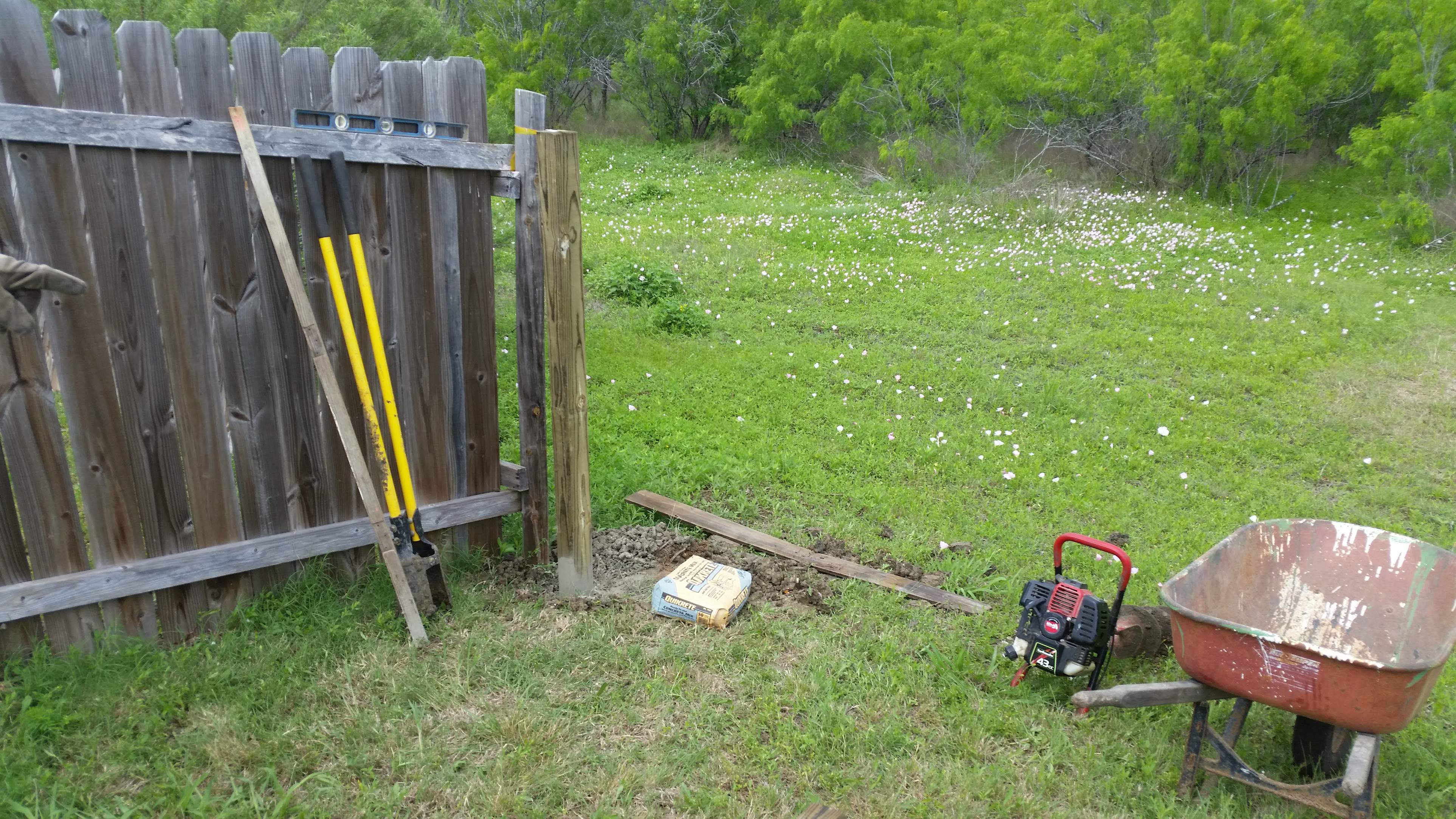

The first post hole went well and we augered down to a little over 30 inches. 4-24-15 First Post.jpg4-24-15 Post Hole Auger.jpg
But the black gumbo really balled up and wouldn't "auger up" the powered post hole digger's flukes.4-24-15 Balled Up Black Gumbo.jpg

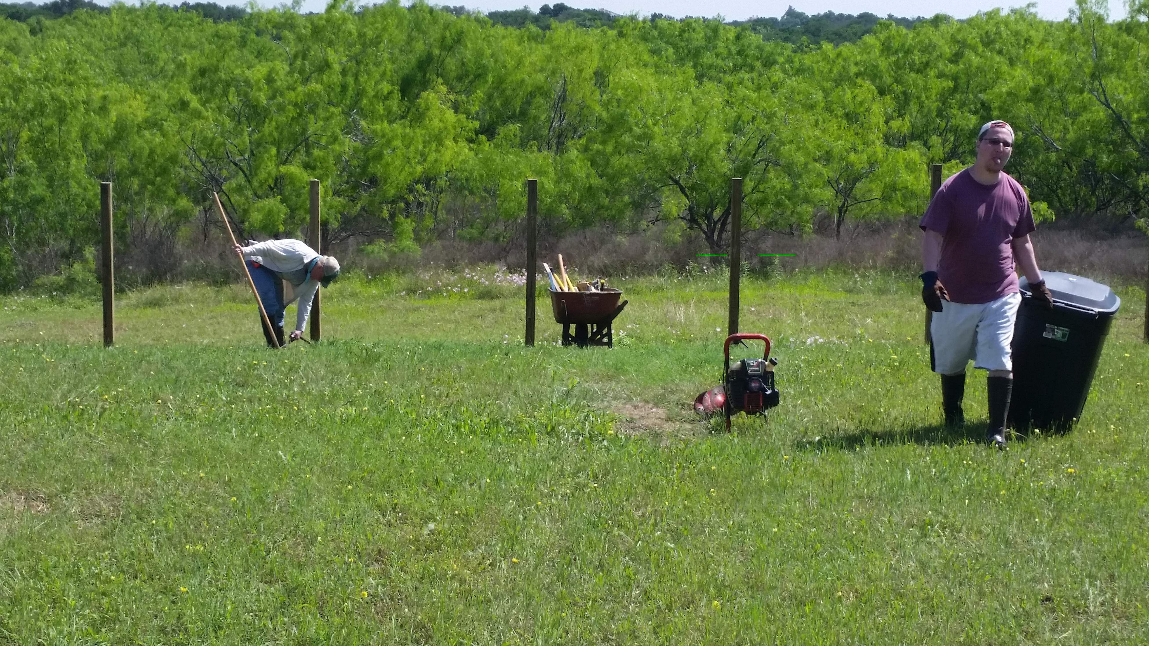

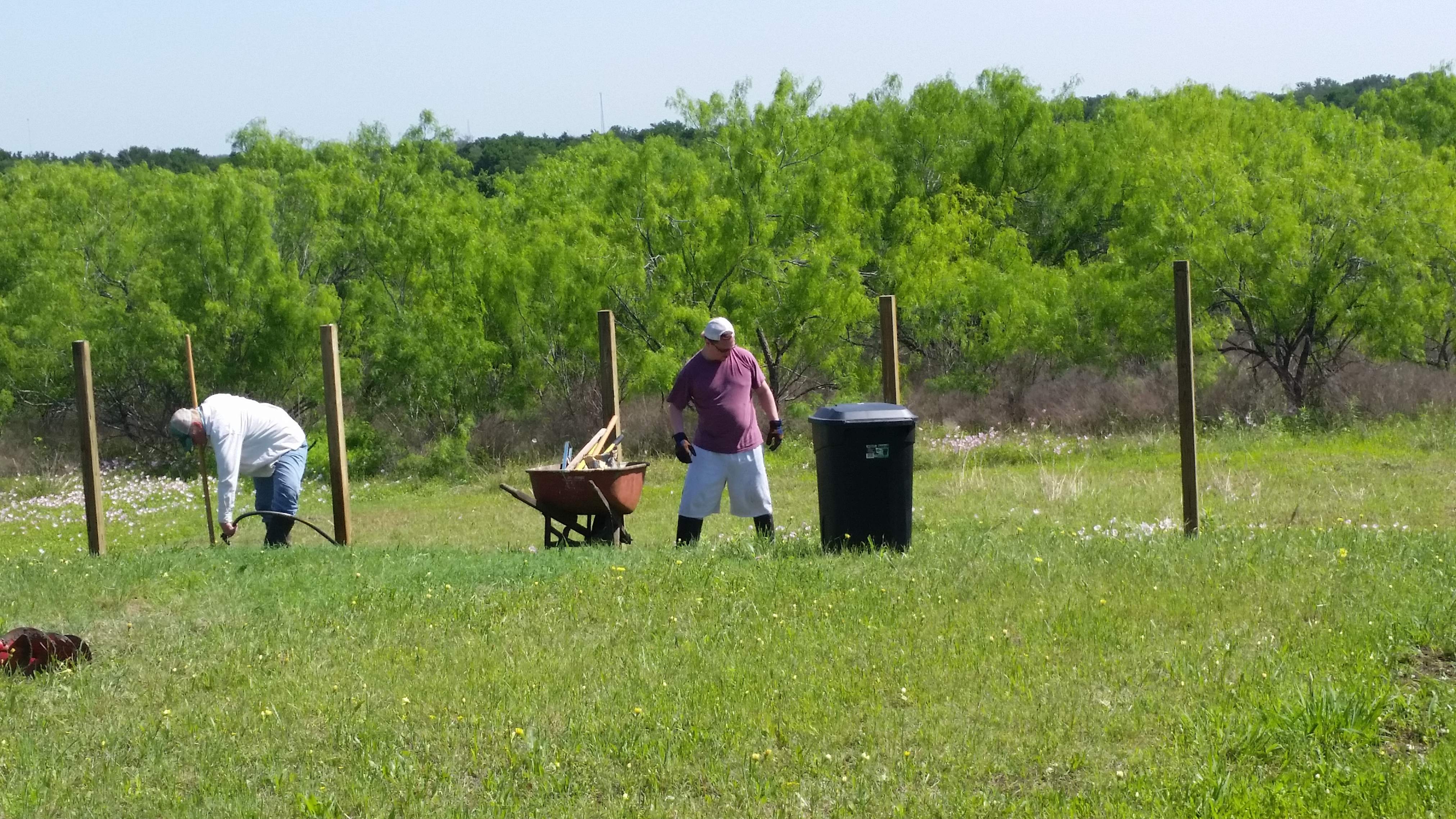

We almost killed outselves and took about 6 hours to put in 8 posts.4-25-15 Luke and Brandi Finishing Posts.jpg

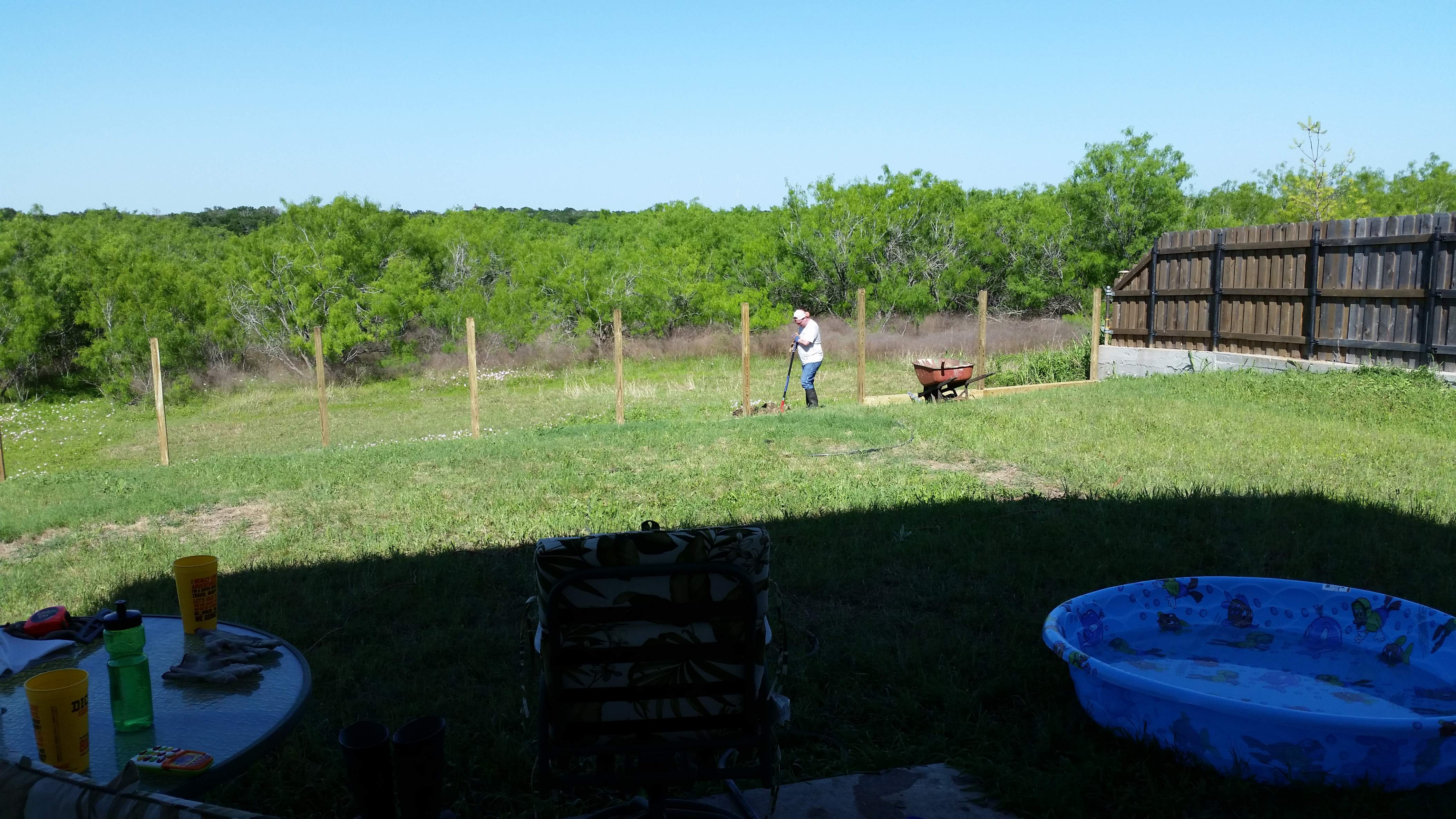

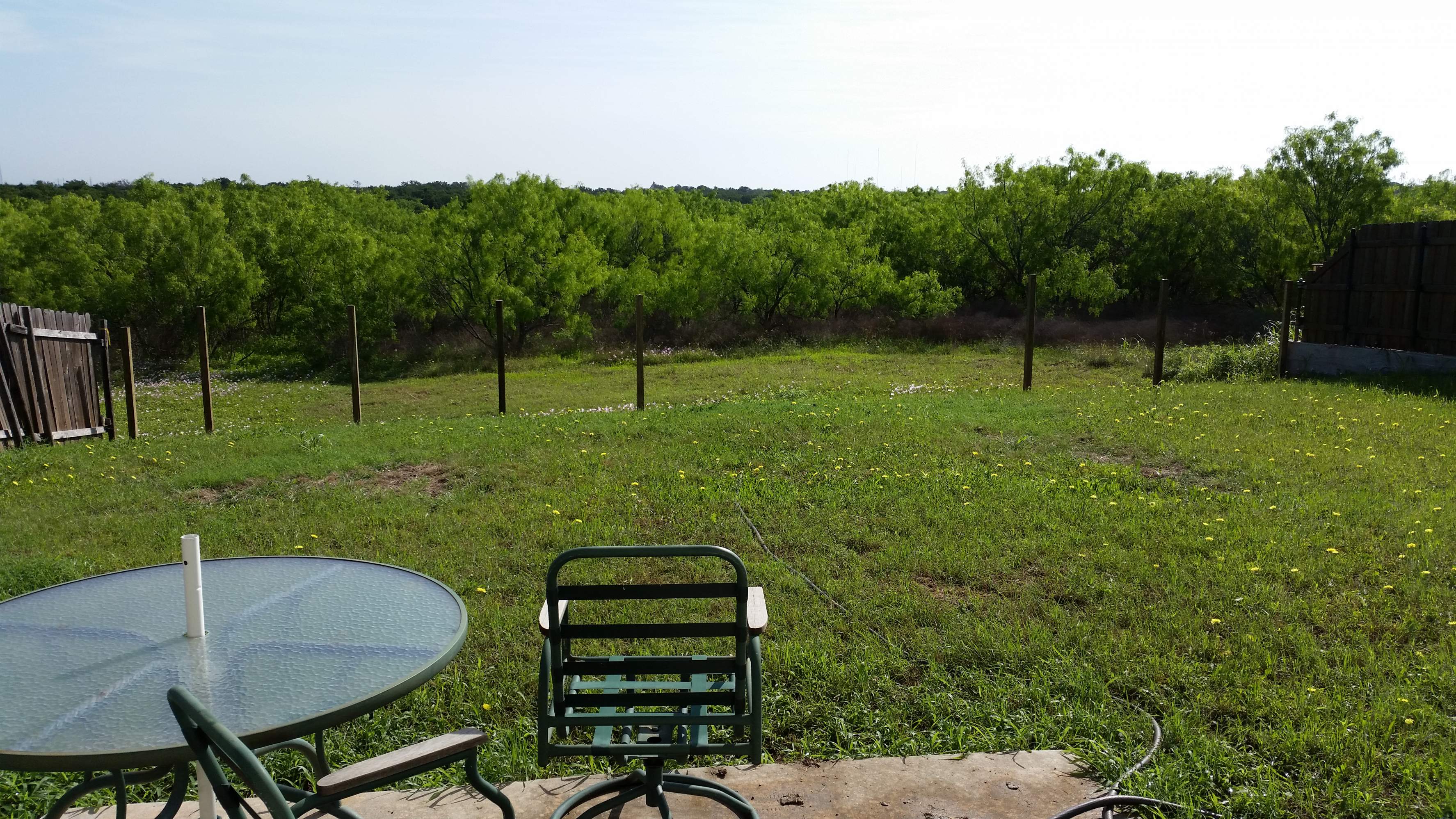

Here is the view when we quit Friday evening............4-25-15 All But Two Posts In.jpg

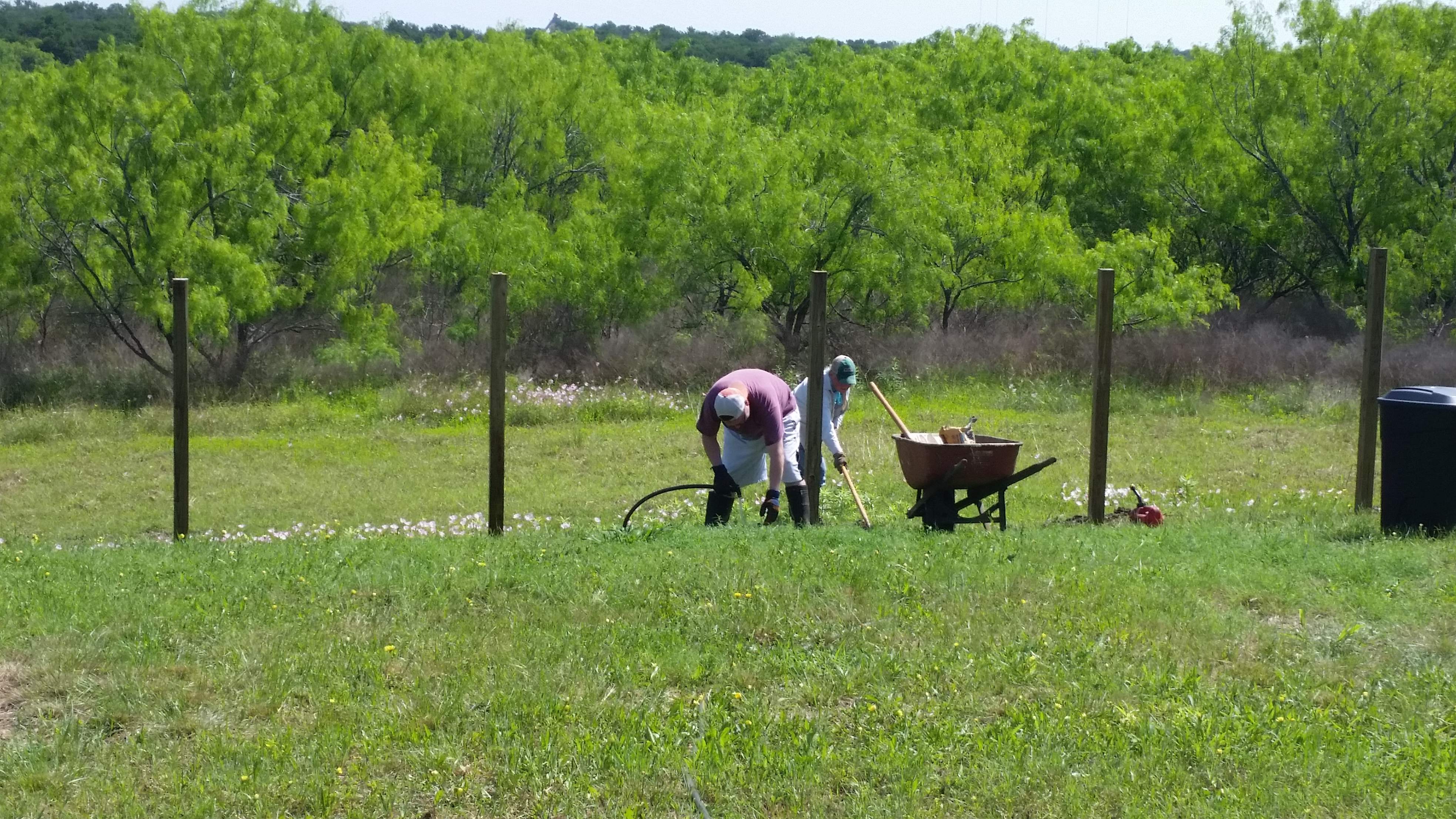

We had to have the water hose out there and constantly washed the 2-3 inch gumbo off of the bottom's of our rubber boots.
It took a while to wash the majority of the gumbo off of our tools and auger. We knocked off the big stuff and let the rest dry and knocked it all off on Saturday. 4-25-15 Posts Finished Cleanup Time 2.jpg4-25-15 Posts Finished Cleanup Time.jpg
I realized digging the last post hole, that we had another powered choice instead of the one man auger in her gumbo filled yard. I realized my daughter's side gate was 53 inches wide. Which is wide enough for a mini track loader with a hydraulic auger. I would have paid the daily fee for this rig (and will next time) as that one man auger and black gumbo kicked out butts for over 8 hours.

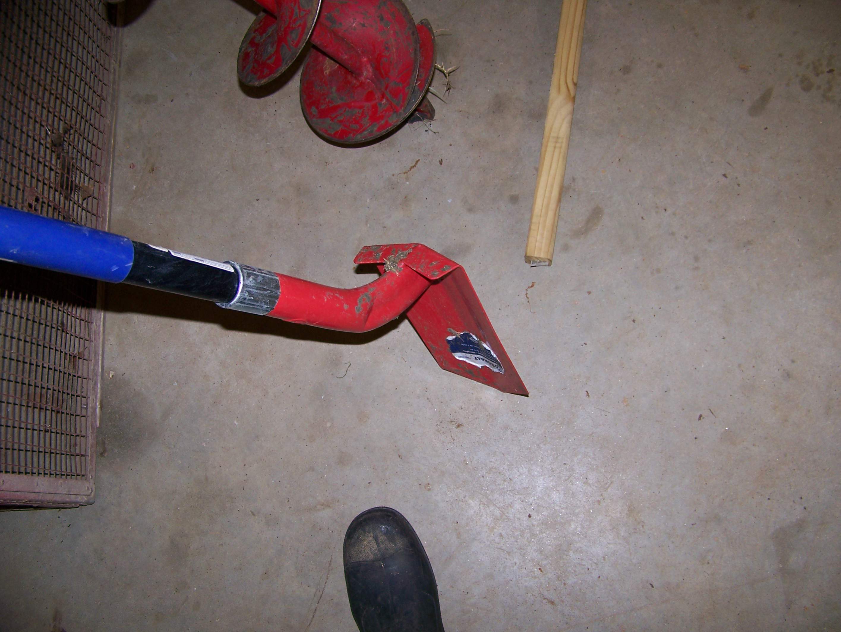

Saturday morning we installed the last two posts. I wanted to buy a sharpshooter shovel, but the Lowes in Austin (that caterers to Yuppies) only had a "trenching tool". Which is a modern day, high tech, sharpshooter. 4-25-15 Trenching Tool.jpg
We also picked up 16 treated 2x6s. I went with 2Xs for the concrete forms, as I will take them home and reuse them for outside projects, thus being treated. I used 3 inch wood screws to attach them with my 18 volt Makita impact driver. Now, it will be easy to remove the forms.

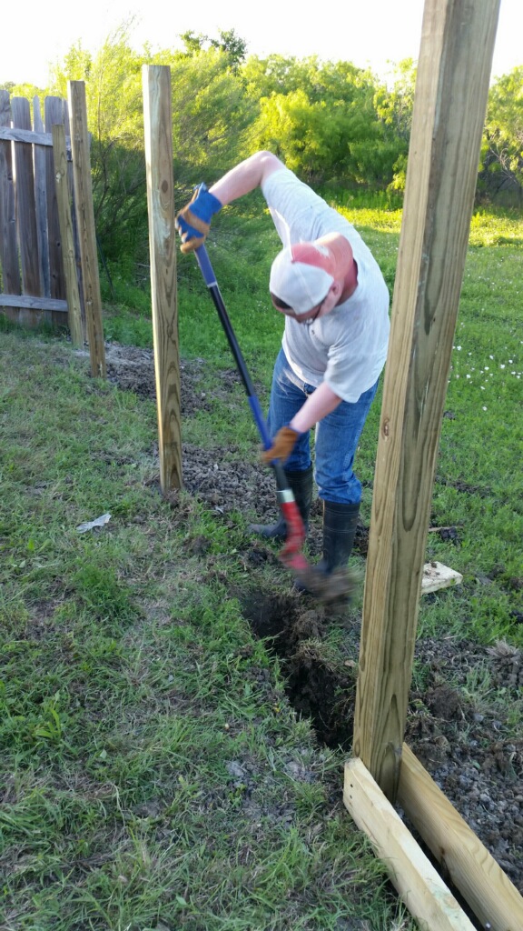

Luke took slowly to trenching with the modern sharpshooter, until I showed him how to wiggle it forward and backwards as applying down pressure with his foot.4-25-15 Luke Trenching.jpg This wasn't easy to do, as our boots had mucho mud on them and would slip off the small step very easy. I bruised my right arch one time. I'll have larger tabs welded on the steps, so that won't happen again.

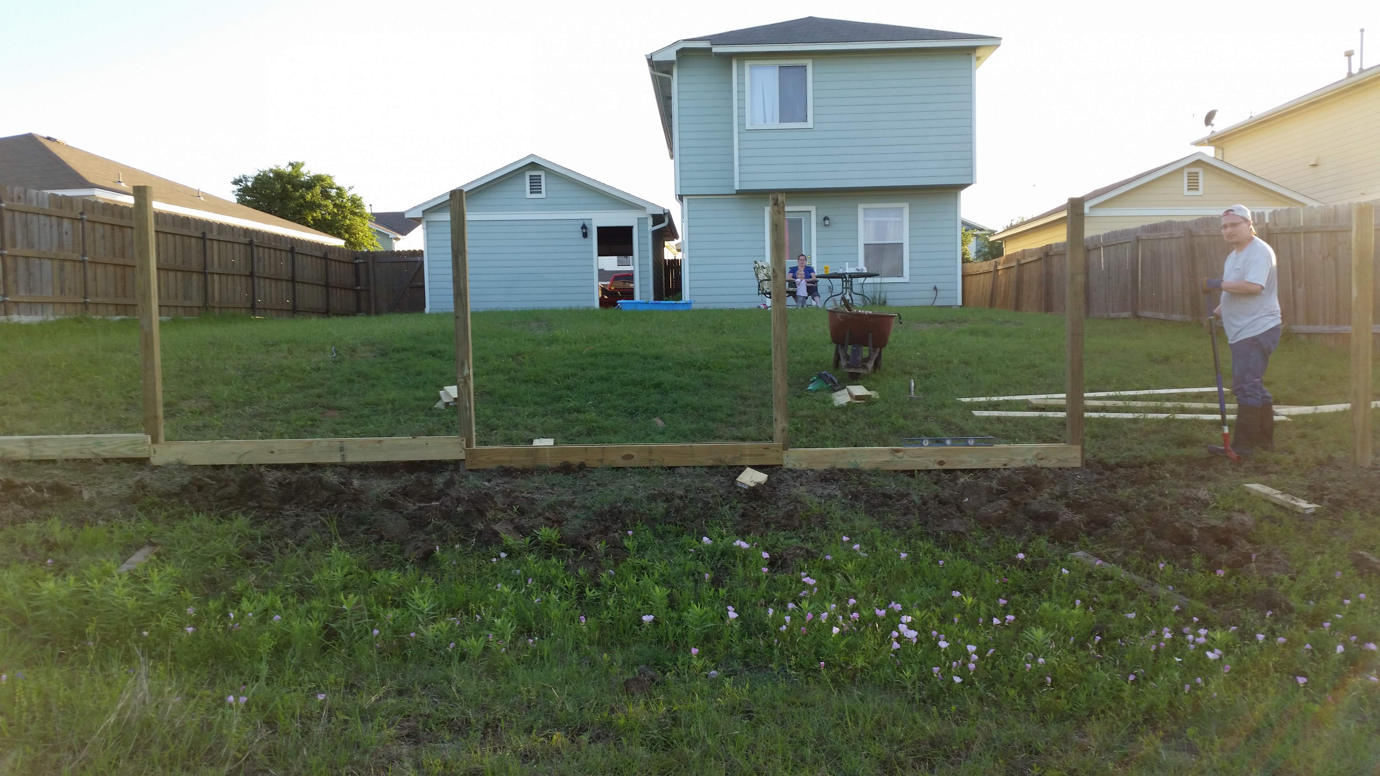

I decided to stair step the level of the forms between each post, as the property drops about 13 inches from right to left.4-25-15 Concrete Forms Going In as Luke Watches.jpg Which is left to right in the photo.
Luke and I alternated digging the trenches, as we did about every 10 inches running the auger. Did I mention that gumbo and auger really kicked out butts? As we went down hill, the soil was drier and digging was easier. 4-25-15 Luke trenching 4.jpg

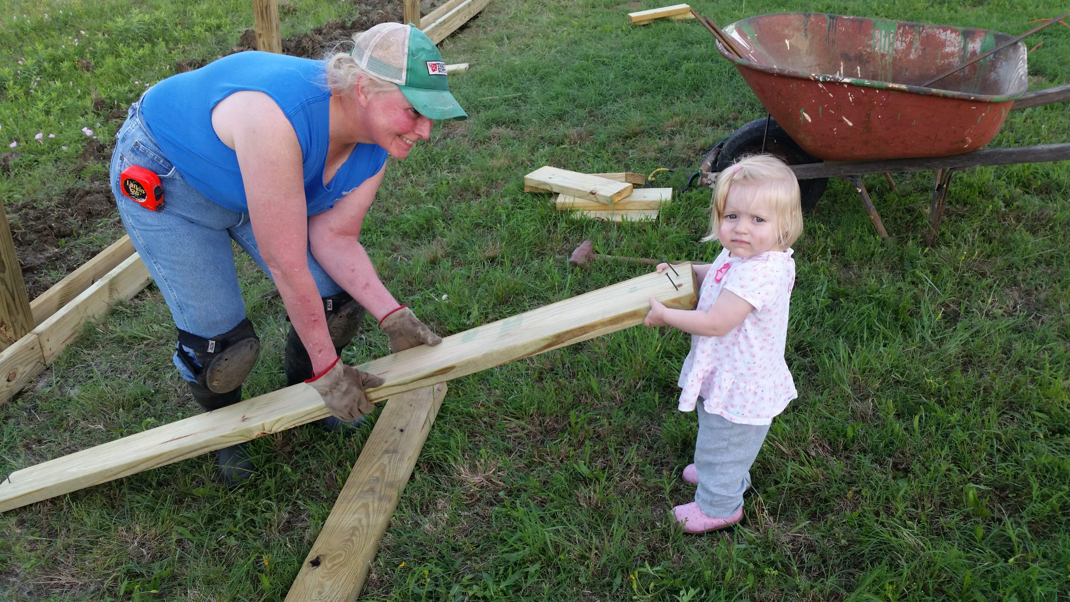

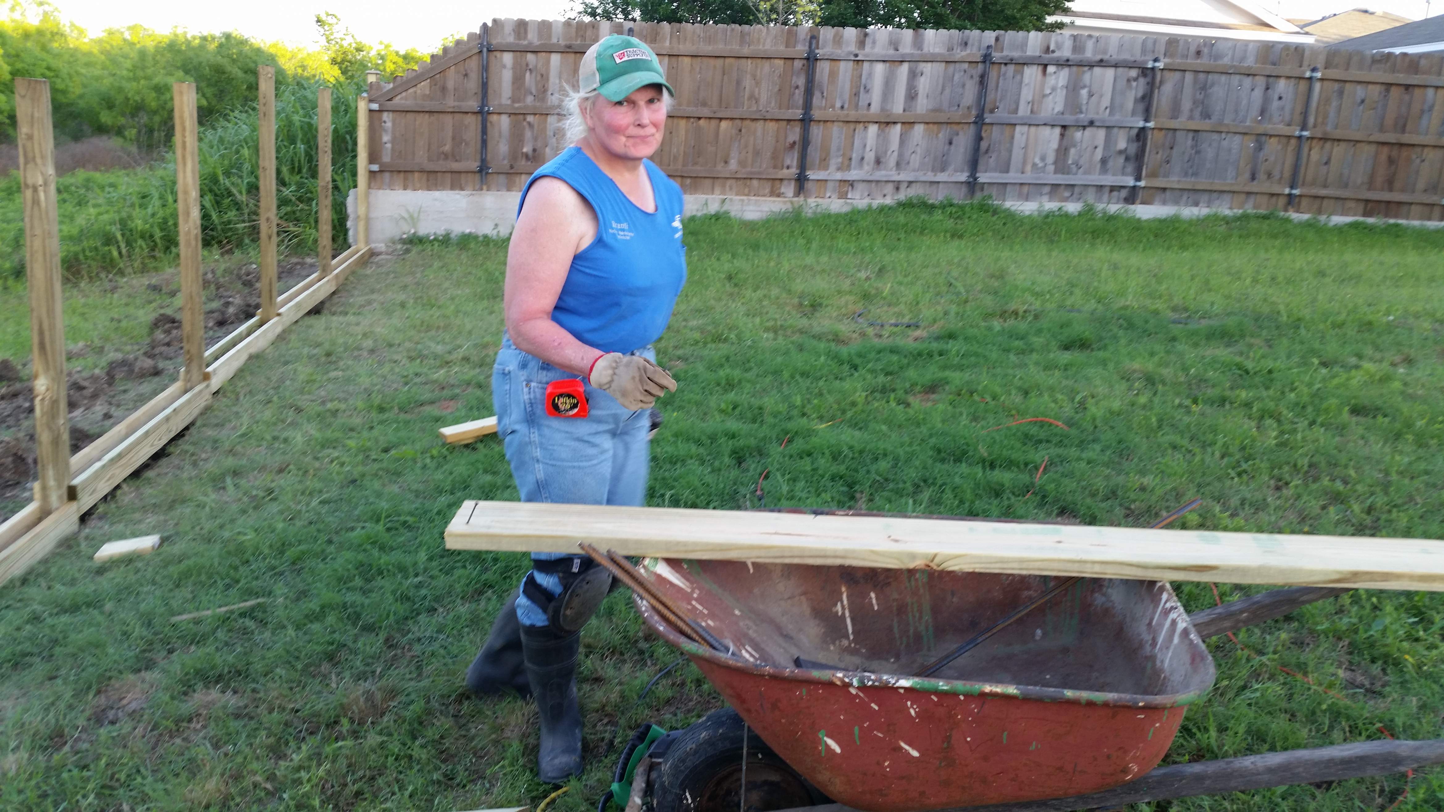

When I wasn't trenching or taking photos, I was cutting the forms to length, leveling them, and screwing them in place.4-25-15 Brandi Cutting Boards.jpg
Here is just one reason I am doing all this.........time with my Grand daughter, Chloe.4-25-15 ChloE helping Grams with a Board.jpg
Notice she had her pink cowgirl boots on.

Here is just one reason I am doing all this.........time with my Grand daughter, Chloe.View attachment 422539
hugs, Brandi
That makes it worthwhile. She'll remember your hard work when she's an adult.
I still remember helping my Grandfather (and Father and Uncle and Aunt) build a house when I was about 5. My job was to sort straight nails from bent.
Looks like a great job was done.

Thanks. That is exactly what my son would do. He used to take my 1 inch combo wrench and dig in the dirt. ChloE spent most of the time up on the patio playing. You can see her and my daughter in the photo I took back from the fence of the stair stepped forms and the house.
