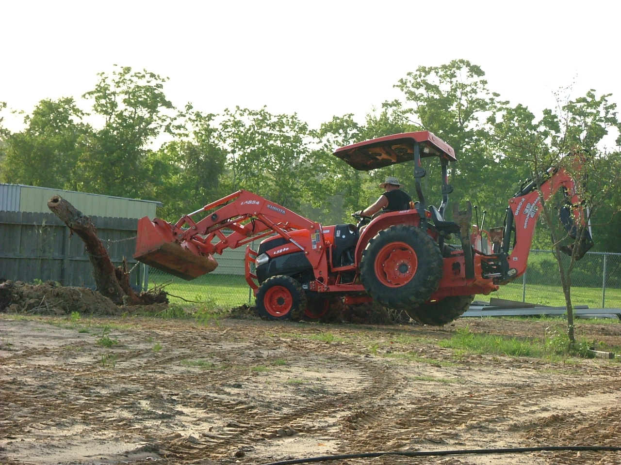

This pictures shows me lifting and slowing backing up, the R/R tire ran up on spoils of the digging so I knew I had to get another angle:

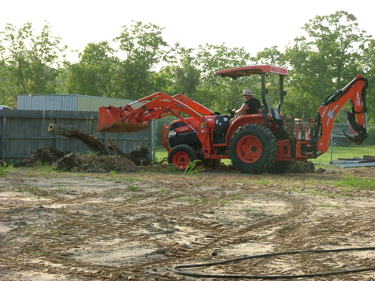

I tried this approach and still no go.. Should have gotten off an fetched an axe

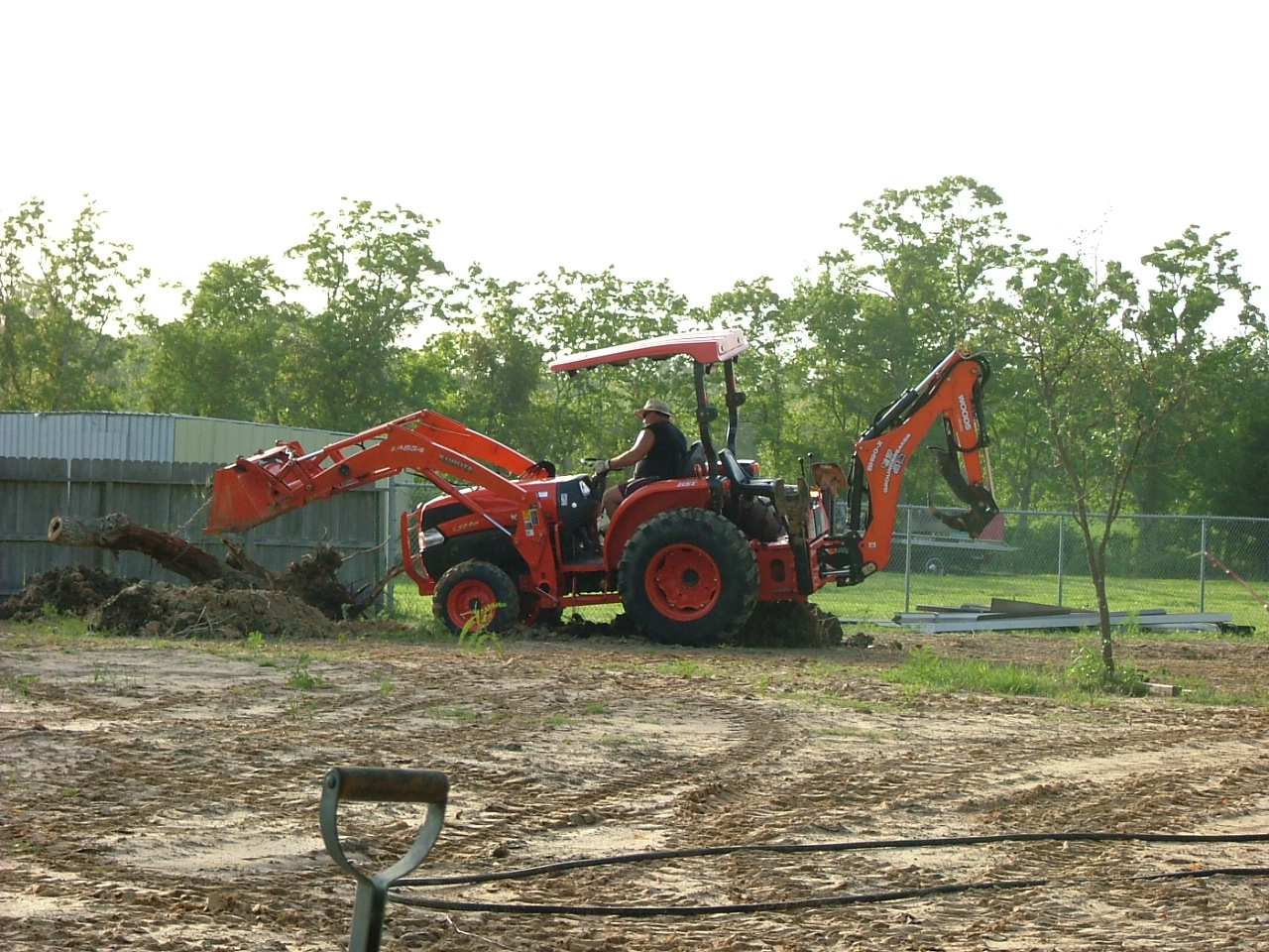

So Im backing up in double low.. Love the HST+ Im focused on the stump coming up... I think I got it... I realize I feel the left rear going up I thought I was backing up on spoils again so I continue on until my wife screams at me after realizing what she saw through the camera:
I guess the moral of my story your judgement can be impared by heat, frustration etc. do not get tunnel vision as I did focusing only on the stump coming up and not my surroundings... I am thankful for the HST as well, I felt no real threat of turning over, I simply let off the pedal and eased forward...
Be safe out there.. Chuck.

Nice endo Chuck! :eek: I'll try to remember to never do that.

Yep, also a good way to roll over if the force applied has any side component. You shouldn't pull things with the FEL, just like you don't pull things from the rear any higher than the drawbar. Great pics, thanks for sharing...

FELs are designed for pushing and lifting, not pulling. Not surprising you got yourself into this predicament. And you didn't do your front axles any favor by doing that reverse wheelie.
You pull with the drawbar. I suppose since your Bota is configured as a TLB, the drawbar is not attached when the backhoe is in place. I would have dropped the backhoe, attached the drawbar and then moved that tree. Or is that backhoe permanently attached?

That is the 1st correct answer.
Pulling with your loader will treeke the loader arms.

No, the B/H is not permanently attached, it never crossed my mind to go through the trouble of removing it and pulling from the draw bar... I was not trying to pull the tree out of the ground but lift it up and out of the hole and drag in into the burn pile. The large hidden tab route was the culprit of my problem..

I am surprised people are responding that this will hurt the tractor or is particularly dangerous. You have a heavy duty tractor that has a loader rated to lift over 2000lbs to full height and can probably lift 4000lbs a few feet off the ground. The front axle is designed for that and has a safety margin engineered in. How many Kubota owners have broken their front axles using the FEL?
I also have a tractor with a loader that is perfectly capable of lifting the rear wheels off the ground when I am grappling a stump or trying to lift too heavy a load. I don't leave myself suspended in midair for ever but my rear wheels come off the ground not infrequently when clearing brush with a grapple. I also sometimes have a BH (same model) mounted and always have at least a 600lb implement on the back.
It is also not terribly dangerous unless you don't know what is happening. The worst that could happen now that both rear wheels are off the ground is that the stump could come flying out and land in your lap.:eek: Unlikely. If the stump starts to pull out or snap the rear wheels will sit down rapidly like you went over an unseen ditch or log while mowing. Uncomfortable to be sure but again I think these machines are engineered for that. Worse would be if only one wheel came off the ground because the loader was assymmetrically loaded because then any further loader force would tend to tip the tractor over further and you could flip it. Once both rears are off the ground you are not very likely to continue to lift and even if you do you'll quickly run out of loader power or reach an uncomfortable angle and stop. The tractor is now a tripod which is pretty stable.
