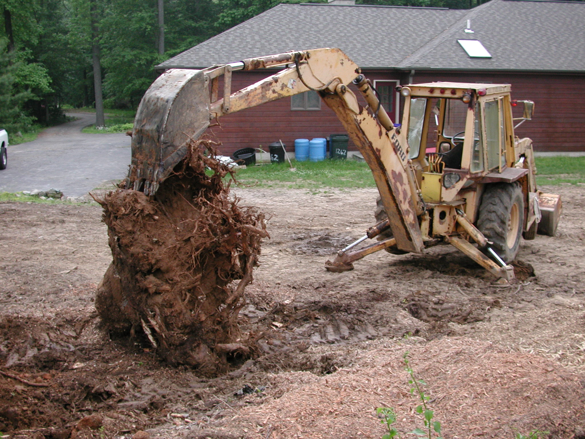

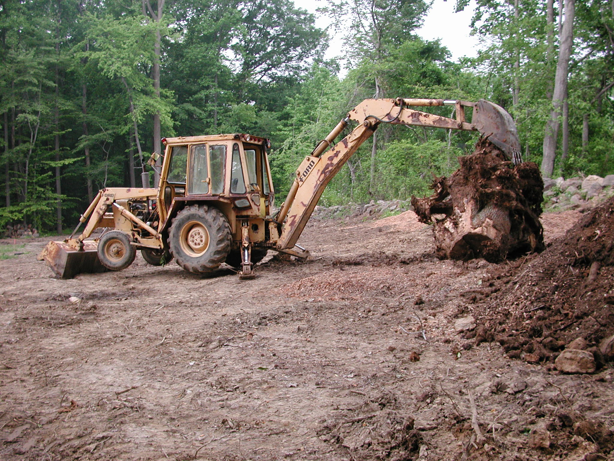

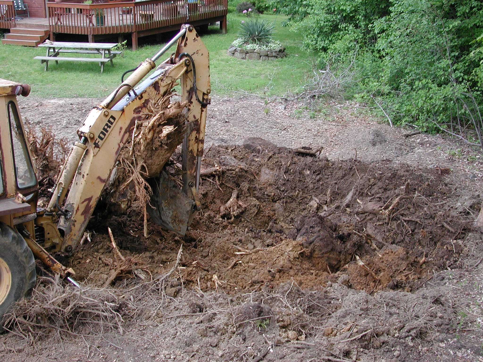

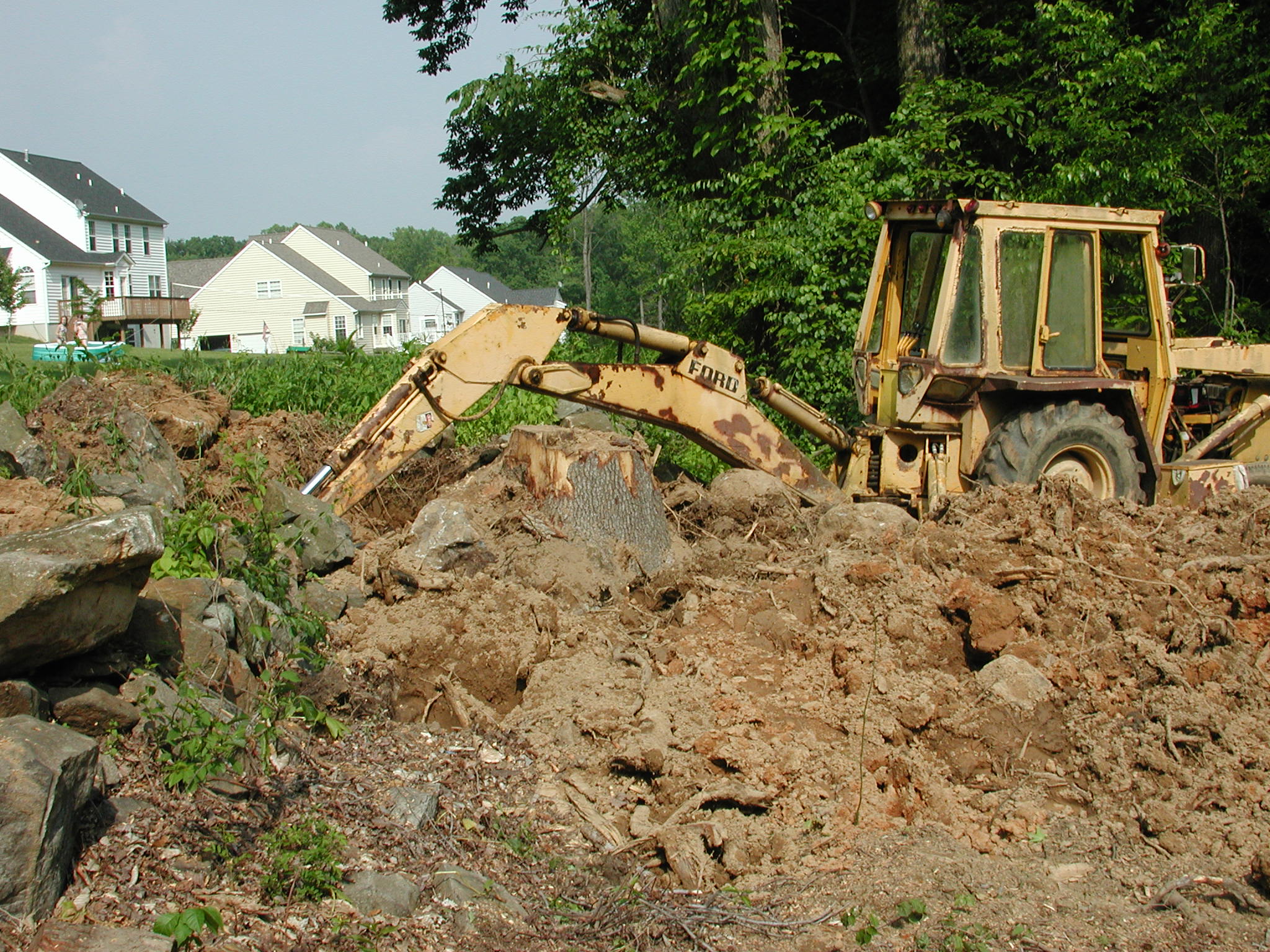

I recently removed a stump that was my worst yet. I ended up cutting some large side roots with a sharpened grub ax. The backhoe wasn't strong enough to pull the stump from the remaining soil so I filled the hole with water and let it sit overnight and the remaining roots came out of the lower soil using the dipper. I had a big problem getting the stump out of the hole and then pushed it into the woods. I am 5' 11" 240 pounds and my arm span is 6 feet 3 inches and overall it may have been larger than seven feet.

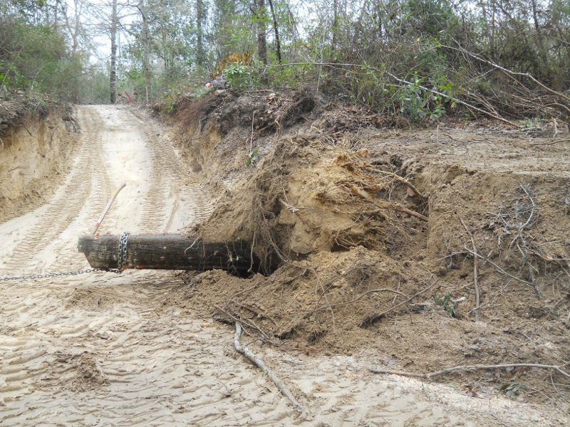

I pulled this one while I was building a road up to the back of the property. I did have to cut one big root. I keep a cheap saw for cutting roots and dig away the dirt and toss a 5 gallon buchet of water to rinse it off before cutting. The tractor is a FarmTrac 390 HST.

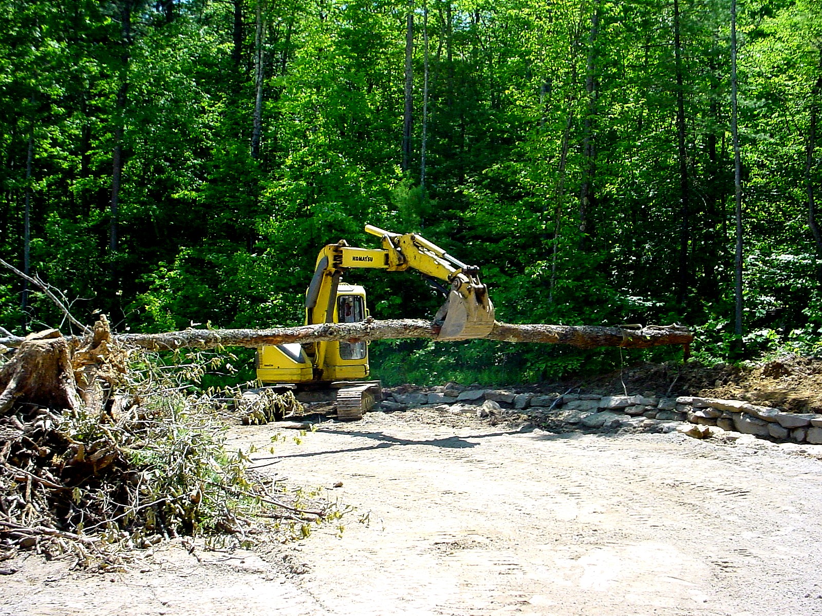

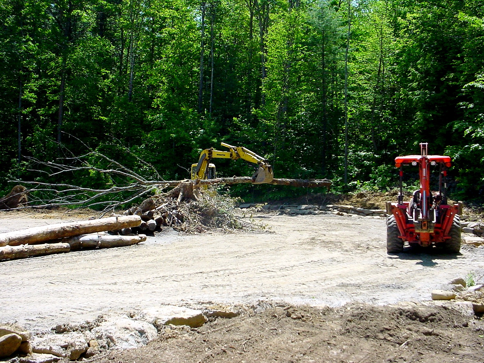

Am I cheating using an excavator. Seriously you guys are tackling too much with too small equipment.
Just to let you know I do the same, I really should have a 12-15 ton ecxavator and a full size TLB

Wow--I could use that rig for a few days.
