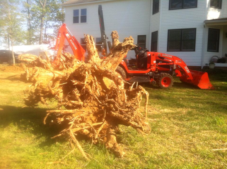

Well;
This girl got her very own tractor in May, and took out her first stump. I bought a Kubota BX 25D 4WD, Loader, Backhoe, Scraper, and mid Mower setup. My first stump took me a while, with a 25hp but for a home with 2.5 acres, it was just the right size. Did I mention I had to put weight in the loader to keep the front wheels on the ground to move it to the burn pile" :)

I pretty much pushed and rolled mine away... even with the full size machine.
