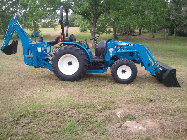

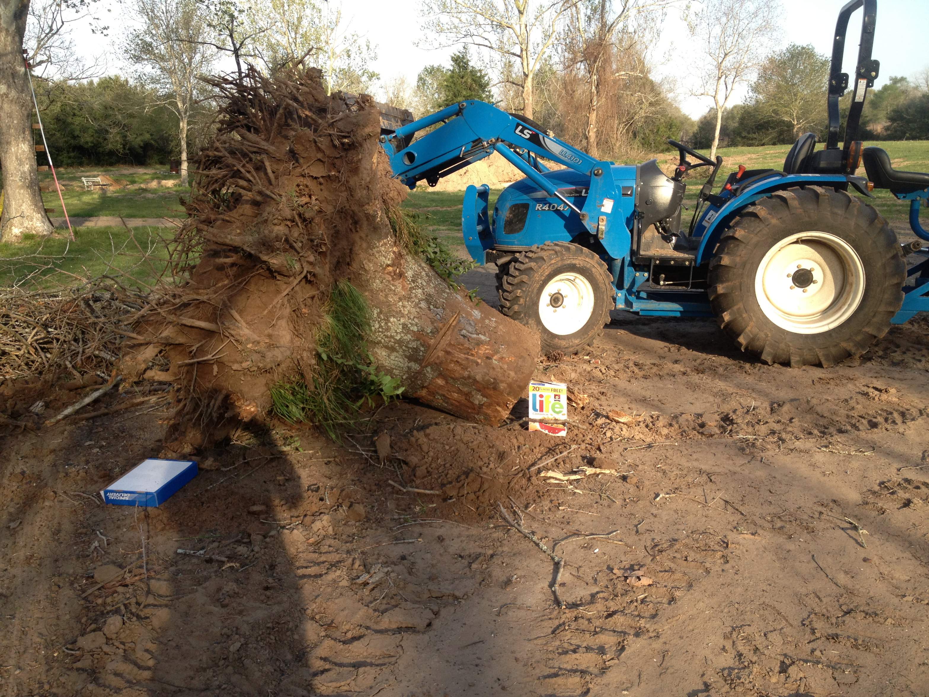

I finally was able to get this thing out a few days ago, I had to dig down about 8 feet on all sides and thank goodness I had NOT cut it all down first, the top had broke off last year and the power company had cut it down to about 30 feet of height.
I used that extra height and weight to help me lever it out of the hole . once I had it laying down with part of the root ball still in the hole , I backfilled behind it , cut off the top , which by the way my 20" saw wasnt long enough for a single cut , I wrapped a chain around it and tryed to lever the stump up on to the backfill. My little LS could get it started to move but I ran out of tractive effort very quickly.
So on to plan B, bring the Dodge 3500 4x4 down and with it in 4 low hooked up to the chain, and even with a couple of feet run ( which scared the **** out of me for fear of breaking the chain and killing my self ) I still could do no better than I had done with the tractor.
So plan C
My FIL Came down to check on me , Hes 84 , I asked if he would help, so with him in the Dodge and me pushing from behind we got it up some , the dodge could hold it while I back filled some more, and then could push more.
I guess all in all I spent about 2 hours digging it up and about an Hour pulling it out , cutting it up.
once we had it out of the hole , I back filled the hole and was able to push the stump on to it roots and was able to push it over to my burn pile, once there pushed it back on it's side to hopefully burn better.

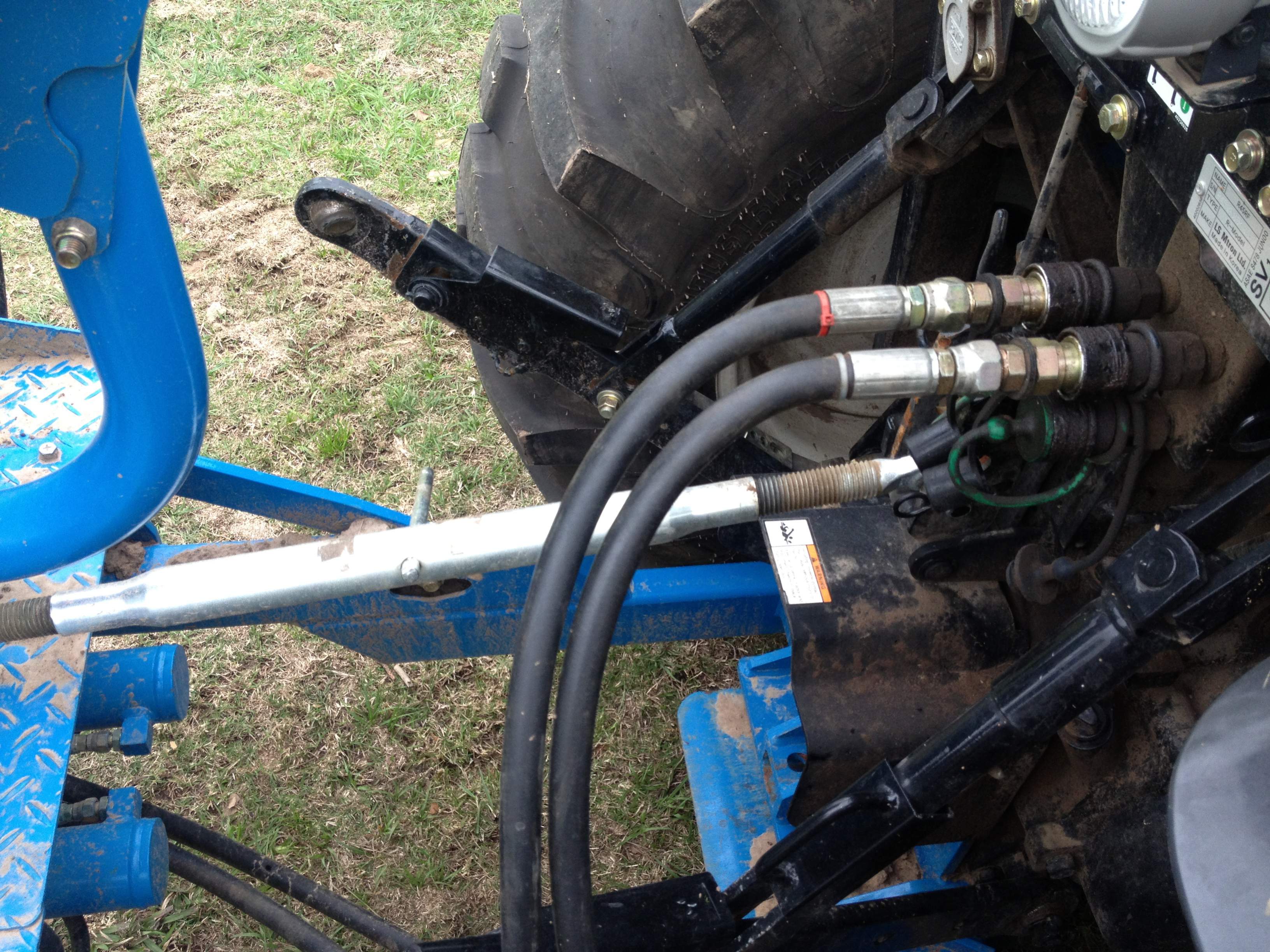

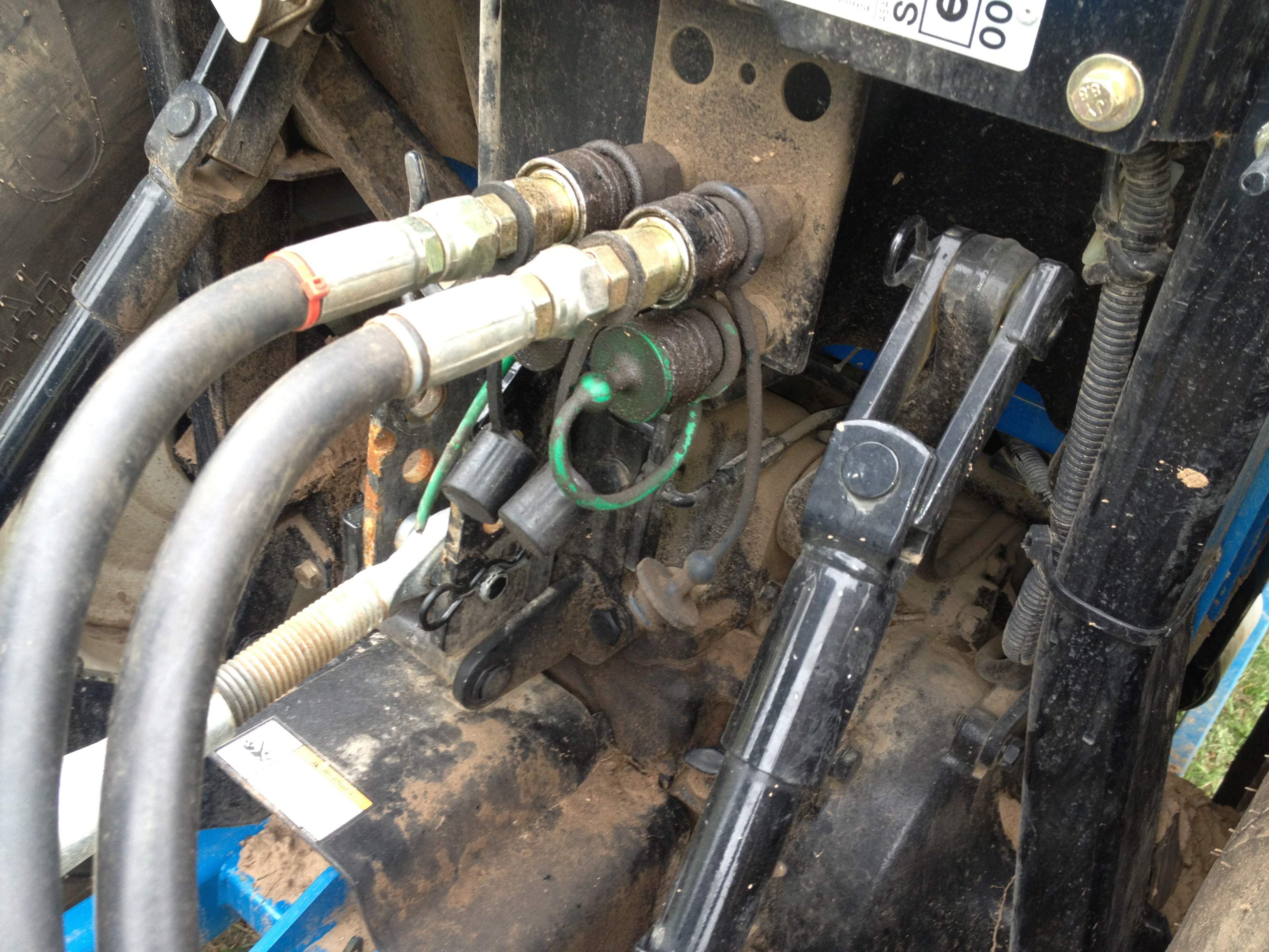

Not to hijack.. but.. Is your backhoe plummed into your rear remotes for hydro power or is it powered by a pto pump? Thanks..

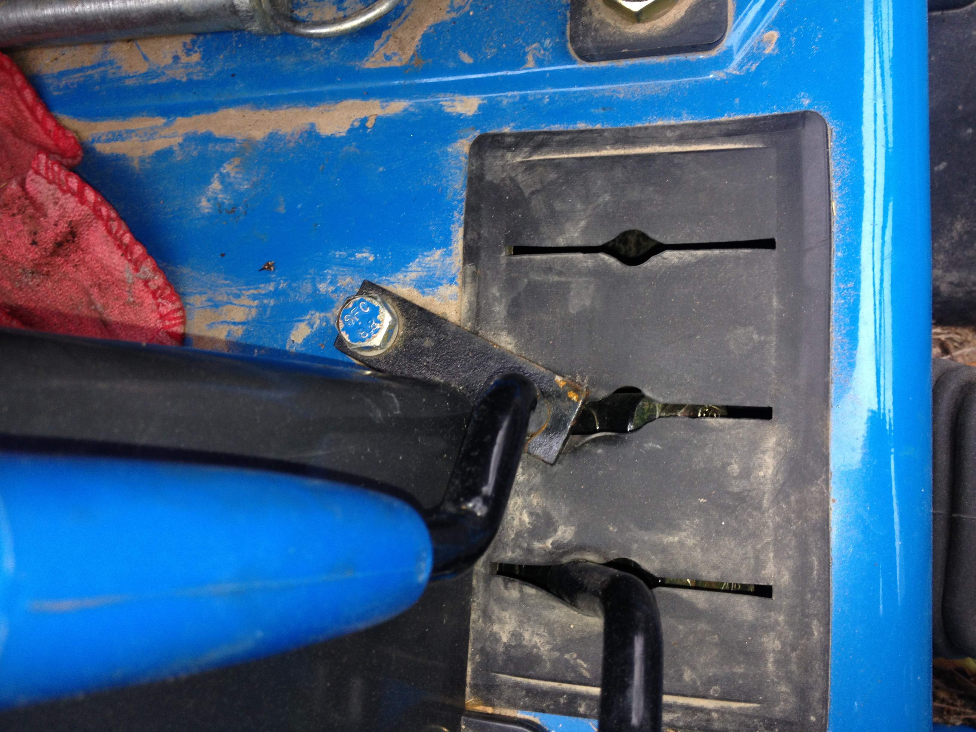

It's plumbed into the rear remote and there is a small lock that locks the remote on when the hoe is hooked up so it has flow all the time.

Gotcha.. uses both sets of remotes I assume?
You only need to use one remote to power the hoe, pressure goes into the hoes control valves and cycles back thru the return side, just like operating a single cylinder except your flow is continuous. Your backhoe valves just divert the flow to BH cylinder opened. On my B26 TLB, I just unhook one oil supply hose and hook it back into the return side and it is ready to unhook from the hoe. No valves to switch or unlock or levers to move like on tractors with add on hoes.

Boomer 632 , I took a few pics of the hydraulics for the hoe for you , the first is the remote lever with the small strap that locks it to the rearIMG_0277.jpgIMG_0278.jpgIMG_0279.jpg
