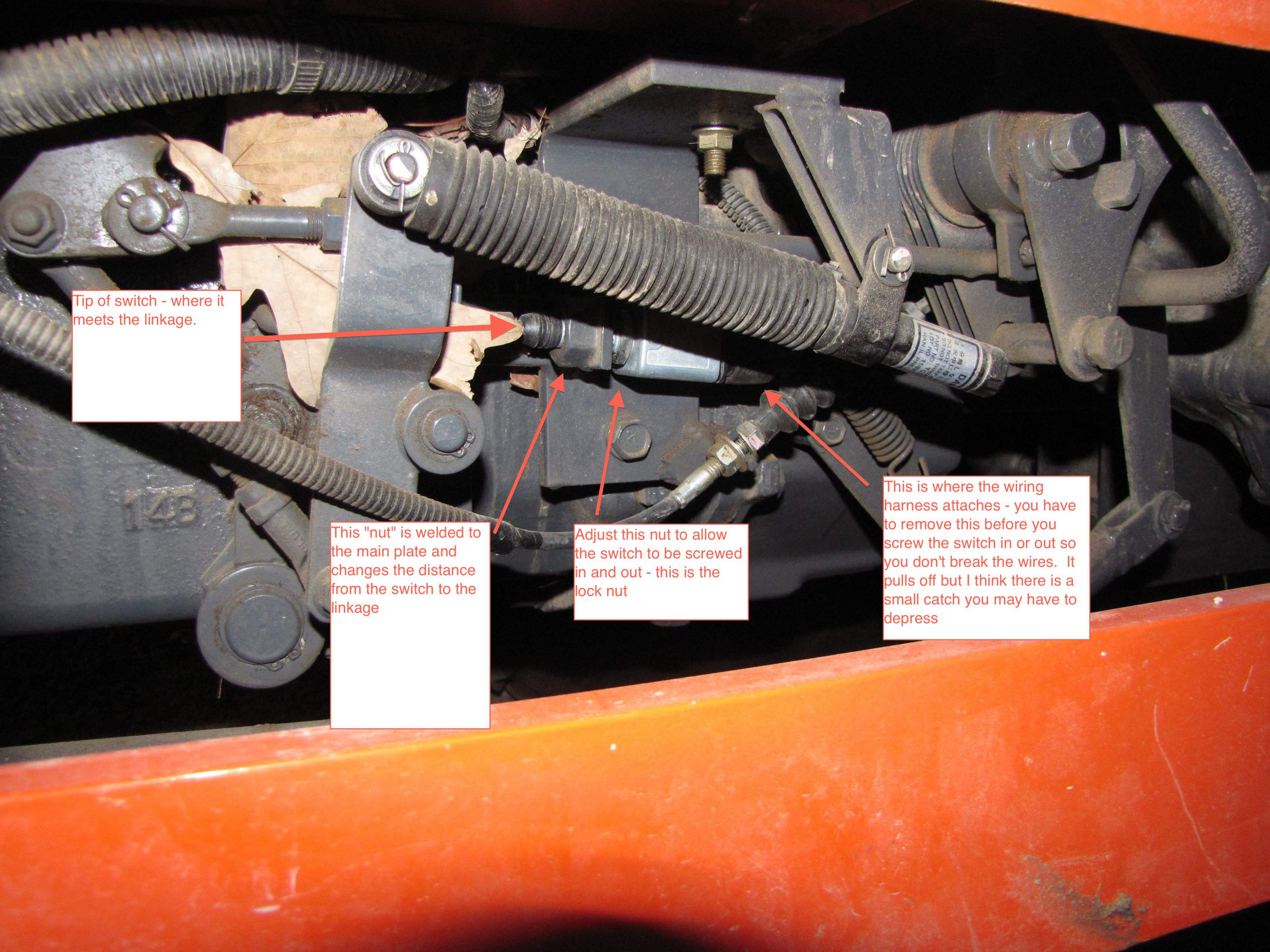

Mine does this same thing. But i need to adjust my HST pedal too because sometimes it wont start because the pedal doesn't return to 100% neutral.
Just replaced my HST safety switch for the same reason. Ended up running jumper wires to bypass the switch while I waited for the new one to come in so I could still use the tractor.

They replace a switch on mine and say now it just needs adjusted, but its been working normal the last few days out.
/ MX 5100 Fuel Problem #11

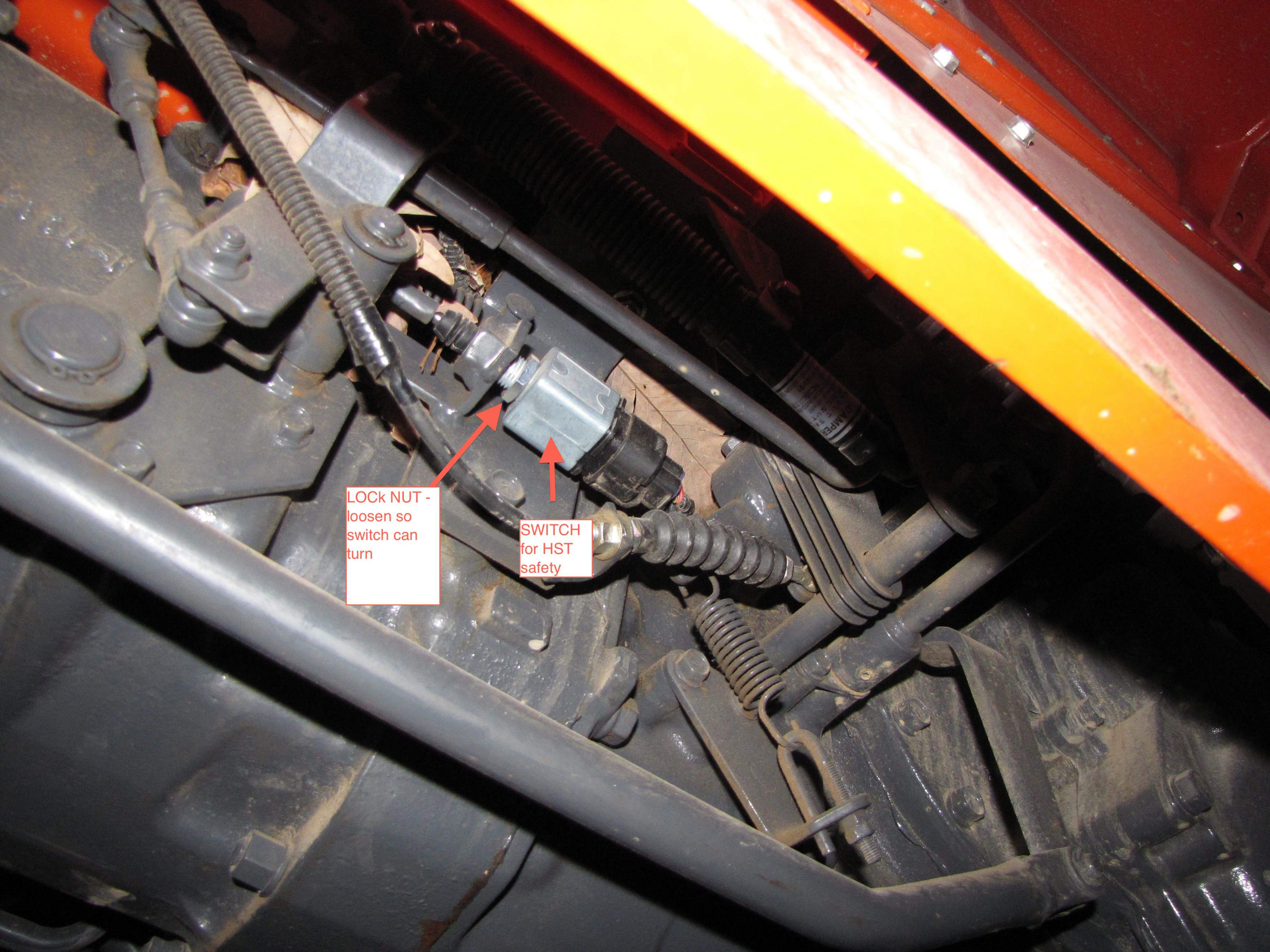

I understand the point of the switches but they sure can be a big pain in rear! Glad to hear yours is working, but if it needs adjusted it is under the left floor board (if sitting on the tractor) and has a lock nut that screws in or out to adjust it. It is easier to adjust it than haul the tractor to the dealer :)

Can you post a picture of the nut you are talking about? Thanks
/ MX 5100 Fuel Problem #13
Here are two photos and I added some text to give a little more info. Hope this clears it up!
