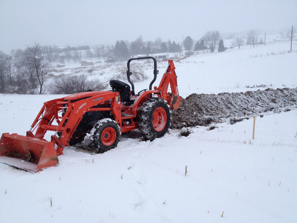

I'm very happy with my BH92 so far, it doesn't dig the same as a full size backhoe but I didn't expect it to. Have about 50 hours of dig time on it, these are the only pictures I could find.
/ MX 5100 backhoe, any advice? #8
Perfect. As I mentioned, I have both a Case Backhoe and a tractor with backhoe attachment. I get more use out of the tractor with backhoe attachment than the backhoe. Principally because I do occasional digging. When I need it need to dig it does that fine, and mine digs 11' deep almost the same as the Case's 12'. But it might be 3 months between digs.
