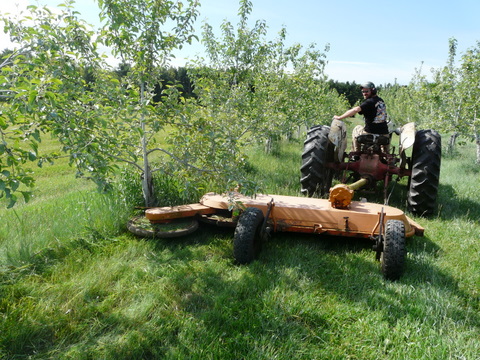

What is the pros and cons of the hydraulic offset feature, as pictured in your url. Nice tractor :)
Got the MX10 semi-mount with the new hydraulic offset feature, like this guy did. This set up is sweet!
2014 JD85E
/ MX 10 Pull Behind or hydraulics #17
With the hydraulic offset feature, you are able to shift the mower to the side so you can mow next to fences/buildings/ditches/tree-line and keep your tractor out and away from these obstructions.
Similar to this: RotaryMower.JPG
Similar to this: View attachment 369601
Dishpointer, what brand/kind of mower is that?
I want one.
