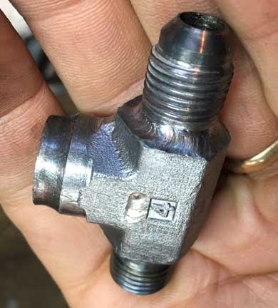

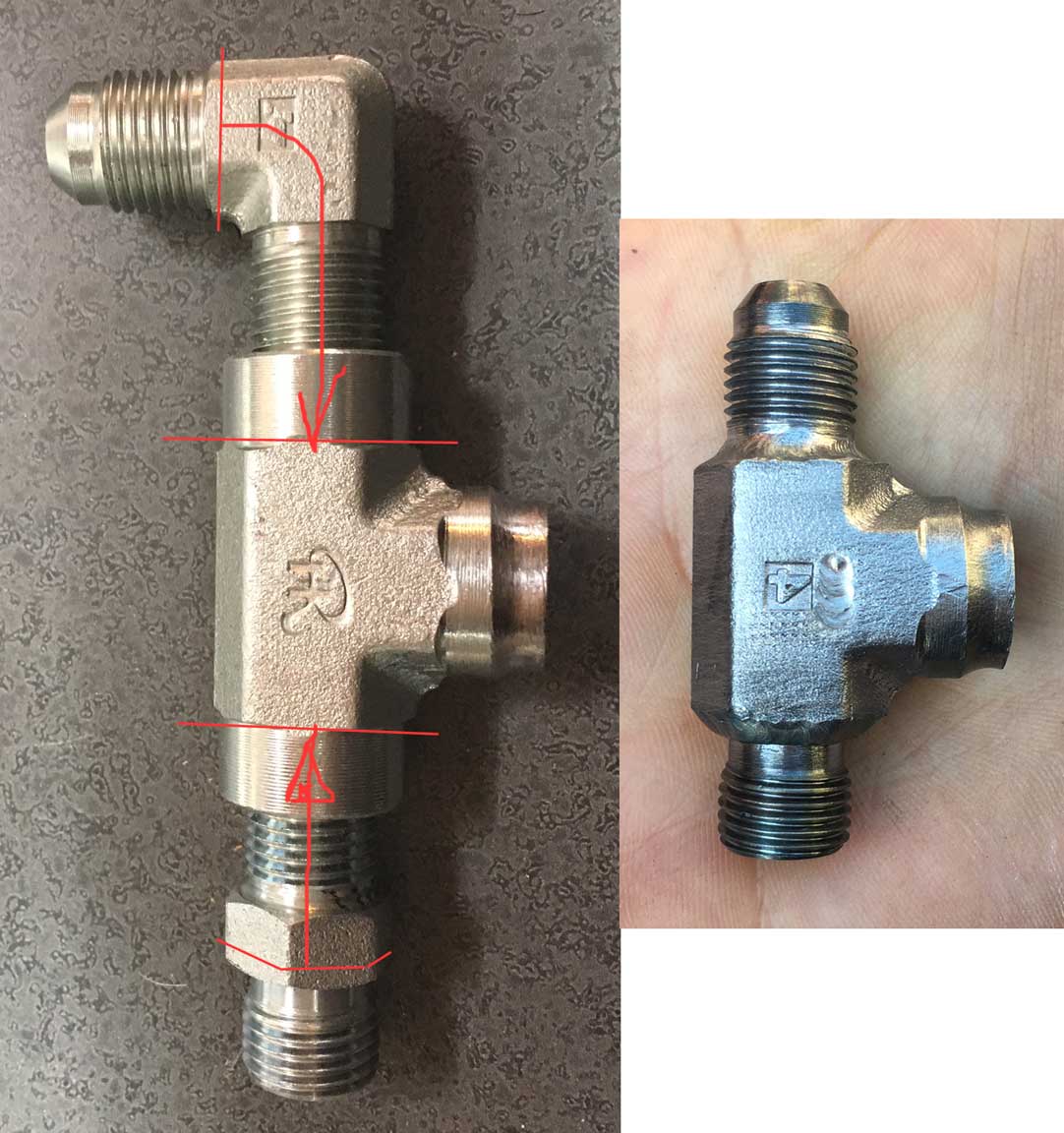

I just learned to TIG a few months ago and it's been GREAT fun. Here's an oil line fitting project (engine pressure not hydraulic pressure). Screwed together fittings were getting kinda big. Cutting them apart and welding the parts back together as a custom fitting becomes feasible when you have a TIG. I have the Miller Multi-Matic200 MIG/TIG/Stick.

Sodo, I tried to customize a couple fittings similar to the ones you showed with my tig and one of them made a mess with a bunch of smoke and slag.
Is it possible that some of these brass? bronze/ fittings are un-weldable?
I cranked up the amps and then it also deformed the fitting- so a complete fail on my attempt
Any thoughts on what I may be doing wrong?
I tried to just meld the to fittings together without rod so it must have something to do with the base metal??

Dan you might put a magnet to the fittings you tried. I couldn't possibly tell someone what they did wrong, I feel pretty lucky when I get it right.
These are steel. I put them in muriatic acid for a few minutes to get the zinc off. Maybe the zinc was messing things up. As you can see these welded nicely. I don't have enough control to use filler rod yet. Note where I cut them (the red lines) I left that thin flange on so I didn't have to hold a filler rod.

Very good Sodo... I like the miniaturization mod! So that gold finish is a Zinc plating, eh? Just curious.

Ahh - the ones i had were used and non magnetic -so definitely not steel.

Well that fitting looks "gold" because of the lighting. It was a bright silver in real life. BUT there are 3 (or more) colors for zinc plating, Yellow, clear, & black. Yellow is the stuff that looks irridescent gold, like drywall screws. Clear is silver, which will turn gray outdoors, like galvanizing does. I don't know much about black.
