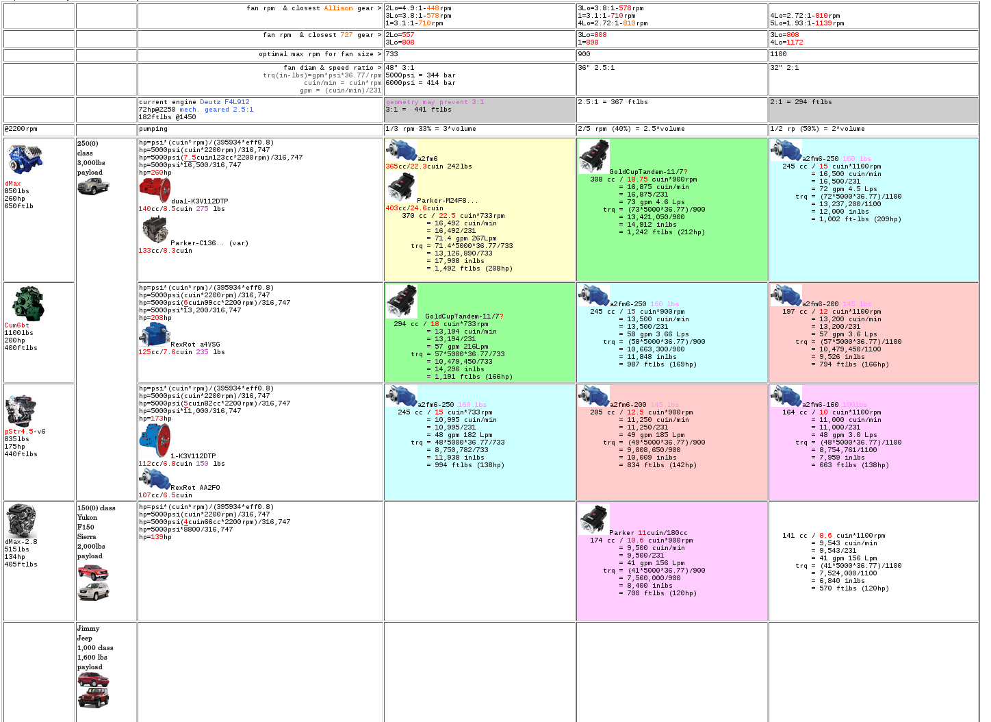

Dont know how much torque he needs, but the Chelsea 249 is rated for 200ftlbs and 95hp. It also runs at about a 25% overdrive so at 1200 engine rpms he is really about 1500rpms. To get the 540rpms or even the 1000 rpms he has mentioned he could use a gear drive and get his rpms down to where he wnat them and increase torque at the same time. I'm just throwing this out there as I still havent figured out exactly what he is trying to do.

I get close to that now but if I'm going to get involved again I'll want a lot more. Nor do I want any arrangement other than a separate engine. I have also been 'suggested' to use the tractor pump (no pto) but that would be woefully inadequate for what I need.
/ Multiple drive-shaft transmission #40
Is there a dealer near you that sells one of these big blowers for a skidsteer? If so you could drop by and eyeball how large the pump is, the hydraulic lines, and generally how they have it setup. You could also find out the minimum gpm required from the skidsteer pump, and get a idea how much of a hydraulic pump it would require. This one is 6ft wide. They sell them for about $5000 on ebay.
