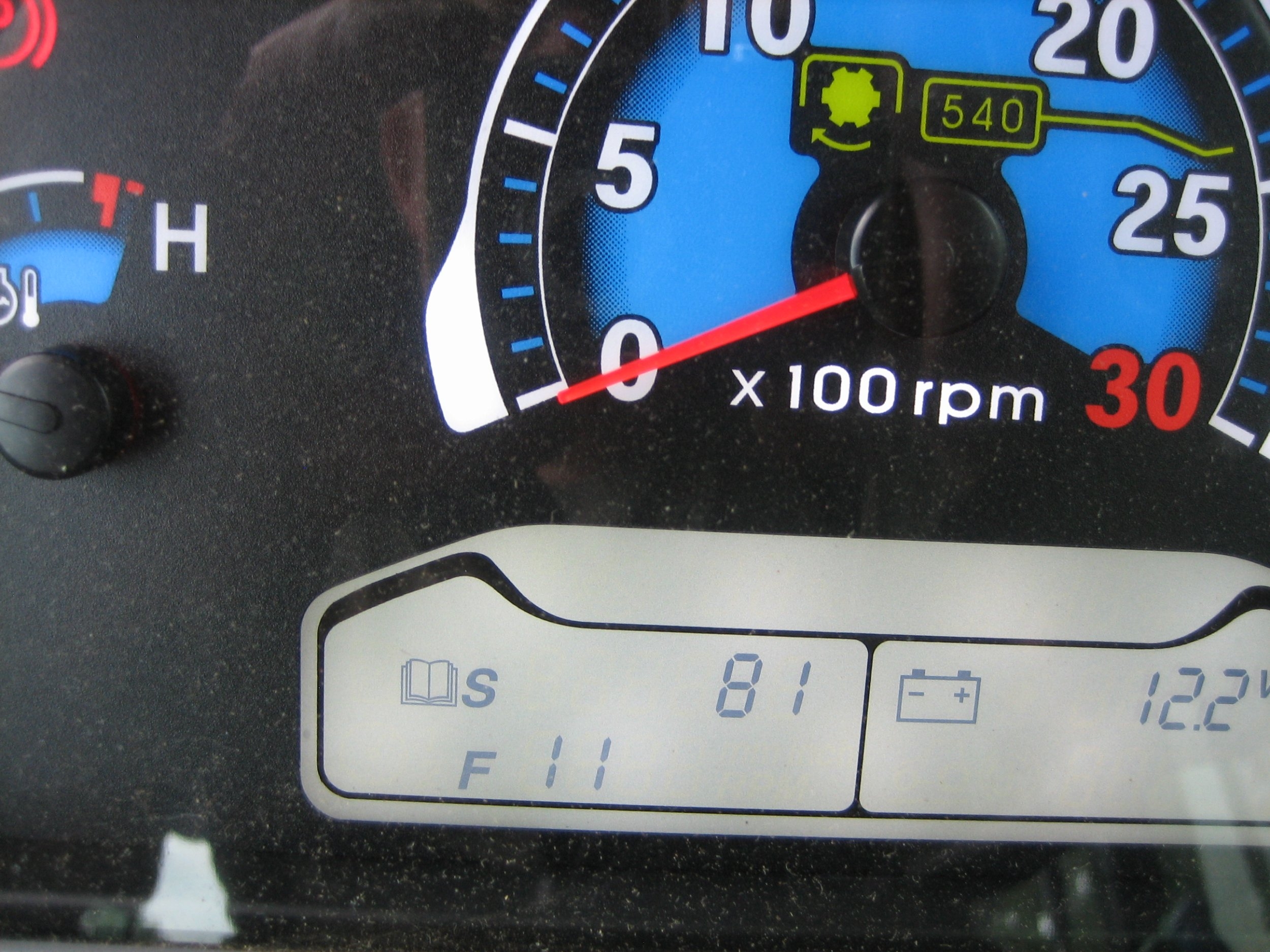

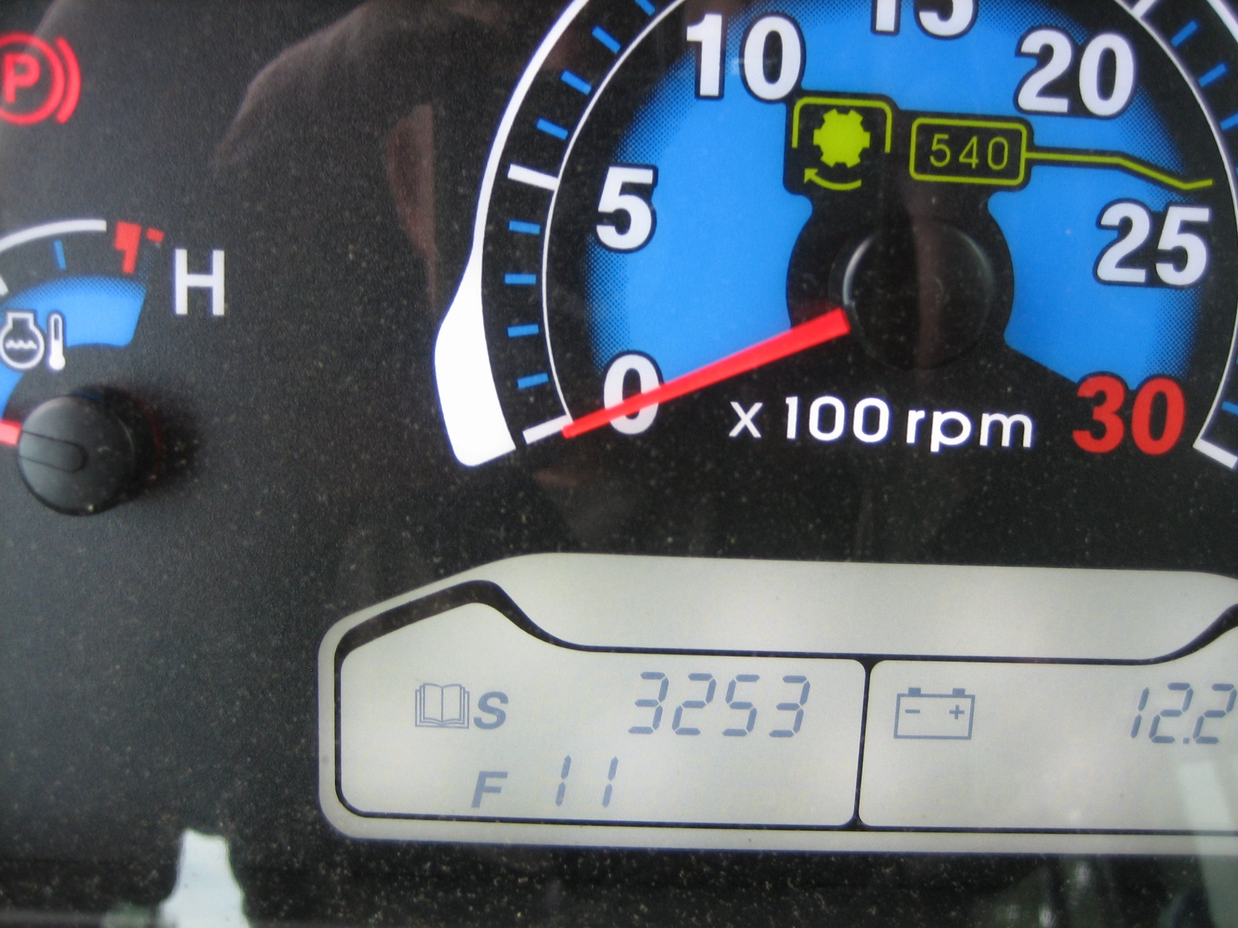

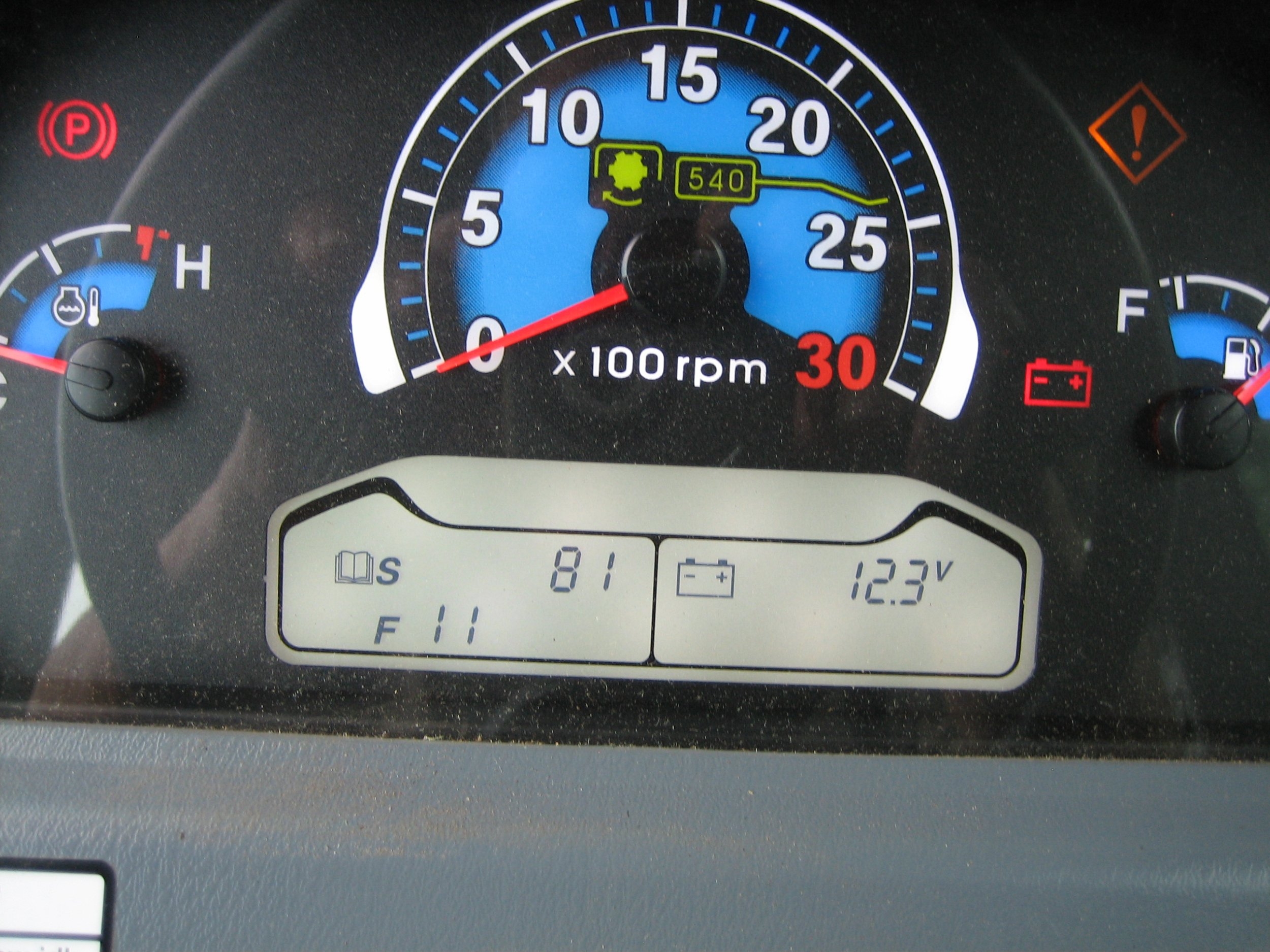

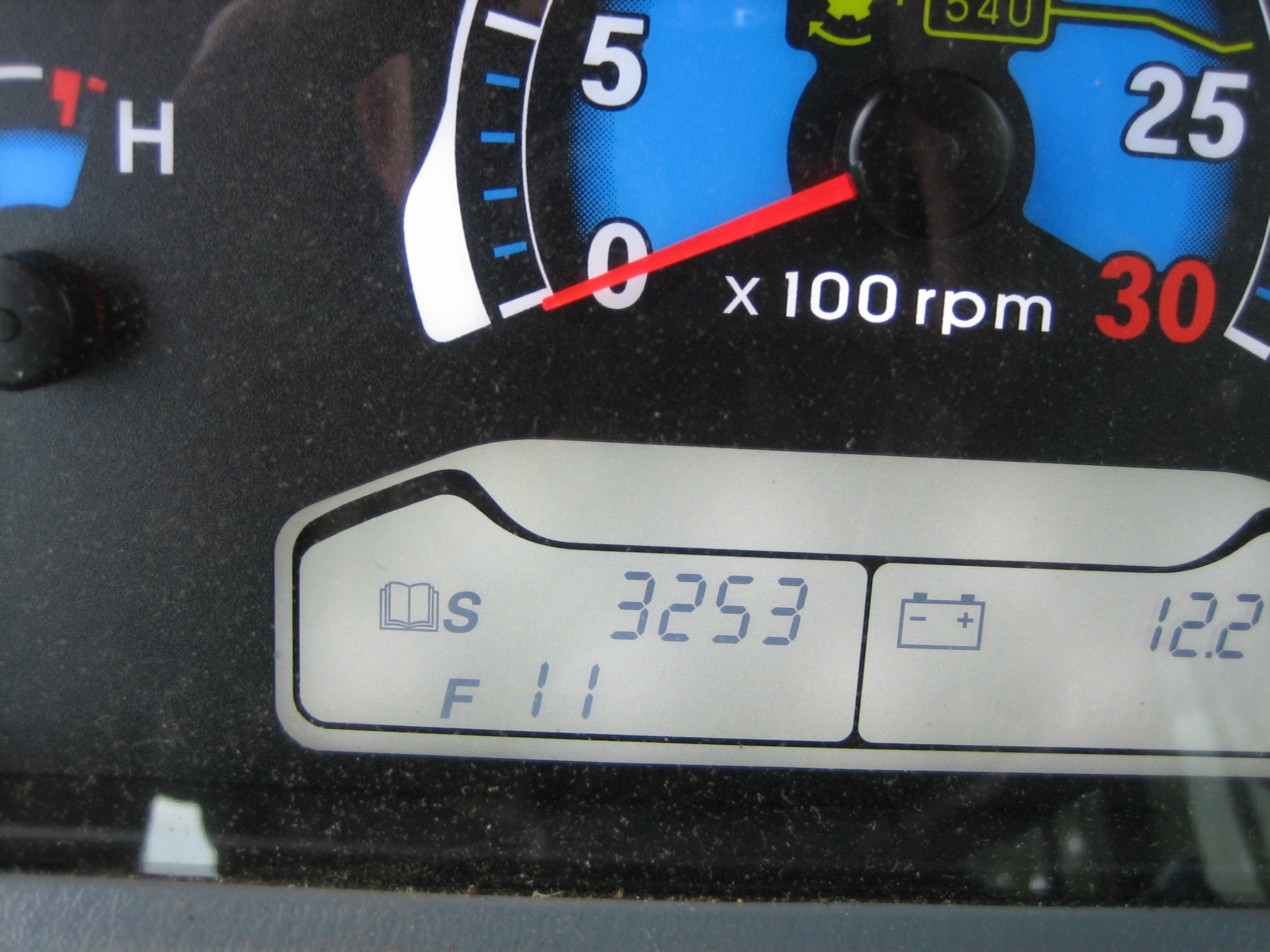

My MT357 has regened twelve times now in twenty-five hours. Last two times it was one hour of running. Today it showed some codes , it showed like a open book with the letter S and number 3253 and on the bottom of that there was F11 and to the right of that the number 81.
The Dealer is closed today so I'll have to wait for Monday.
Anybody have a clue what these numbers mean?

B-011 - DIFFERENTIAL PRESSURE SENSOR (DPS) (Sensor)
Differential pressure sensor - Technical Data (55.989)
Engine control system - Component localization - Electrical sensors (55.015)
s3253 F07 (P224A) - DP sensor leak detected (55.640)
s3253 F07 (P244A) - DP sensor leak detected (55.640)
s3253 F11 (P1453) - DP sensor tube Clamped (55.640)
s3253 F11 (P1452) - DP sensor tube inverted (55.640)
s3253 F02 (P2453) - DP sensor plausibility fault (55.640)
s3253 F03 ( P2455) - DP sensor high fault (55.640)
s3253 F04 ( P2454) - DP sensor low fault (55.640)
s81 F00 (P2458) - DPF overload fault (55.640)
s81 F07 (P2463) - DPF plugged fault (55.640)
s81 F11 (P242F) - DPF regeneration error (55.640)
