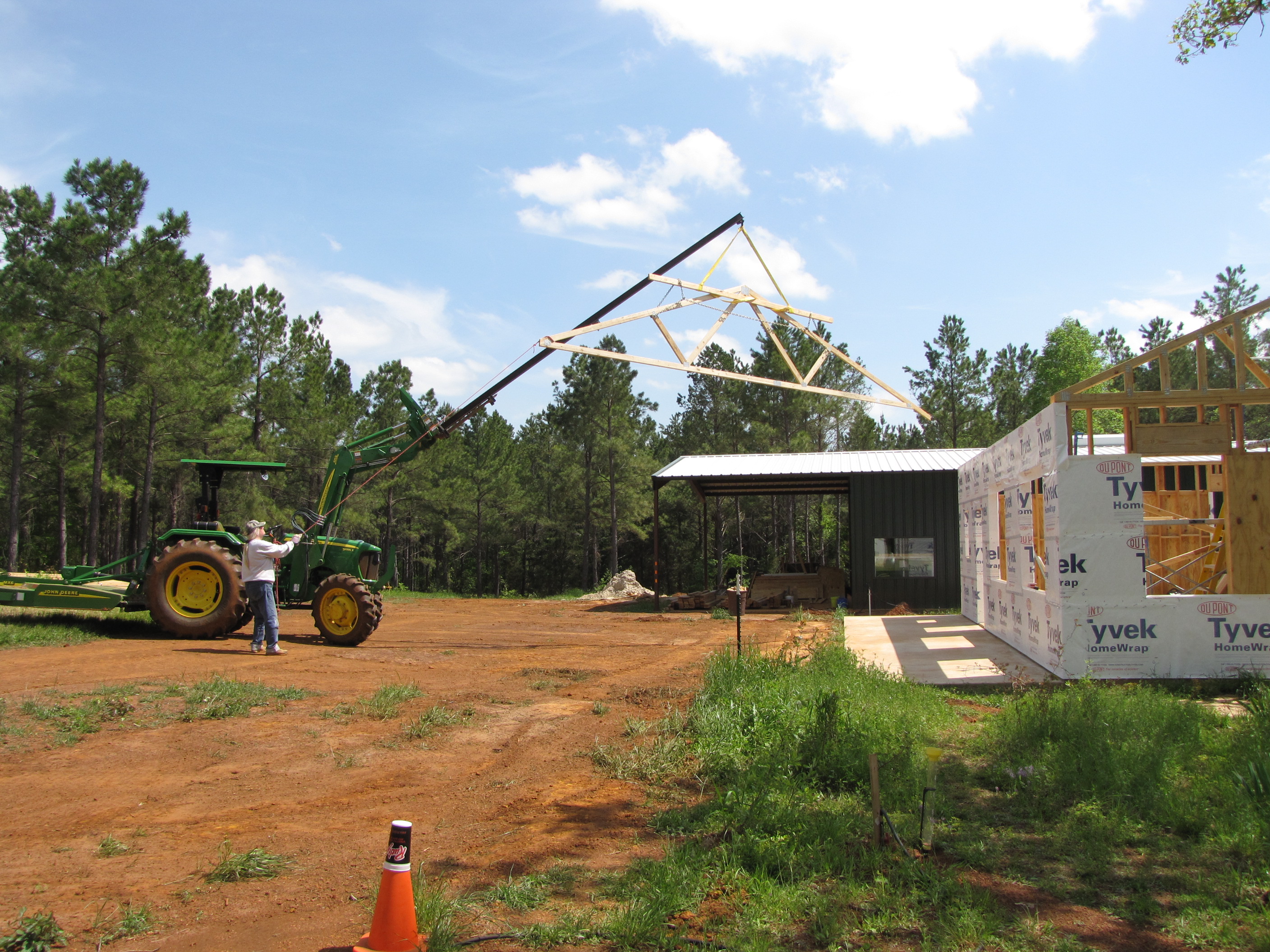

My loader will lift 3000# according to the manual. But using it like this I've increased the reach to 20 ' and the height to 16', but only lift about 200#
   / Mrs. Suggested that we might consider a Mini-Excavator in our future. #53

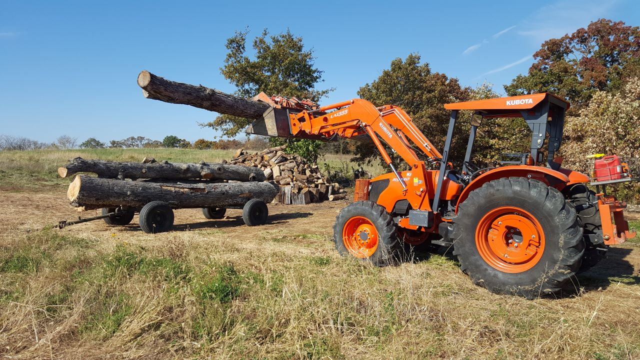

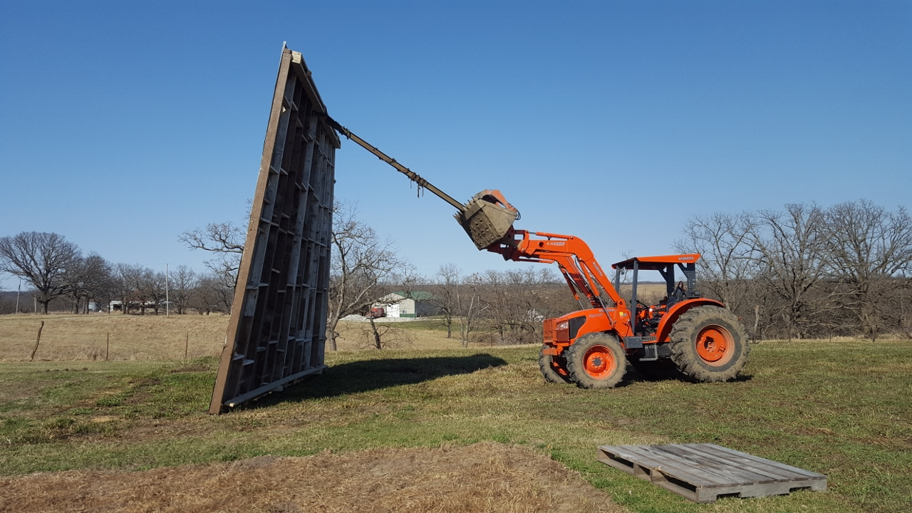

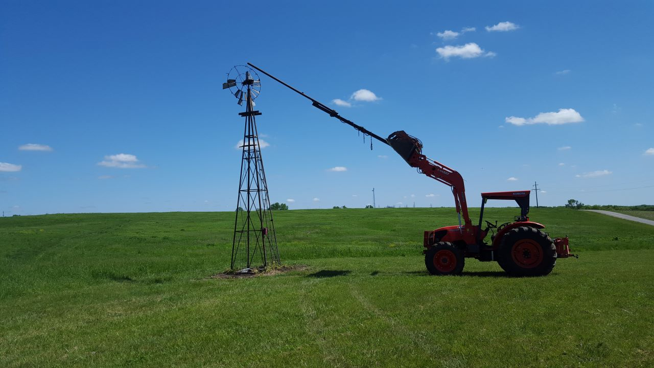

Yep, horizontal distance from the FEL hinge and the hook magnifies effort required dramatically. Not to derail the discussion, but here's a few of the things I've lifted with my tractor FEL.
