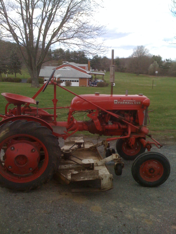

/ Mowing with an IH Cub? #28
here's my cub..
