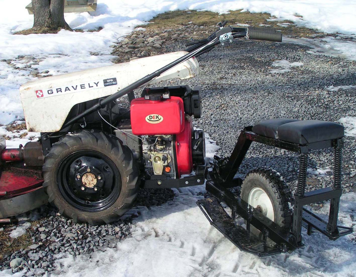

Hi! Gravely and Grillo have the same rotation. BCS Wrong or bad rotation. I can use Gravely implements with my Grillo I make a special adaptor. I dont have the 50 inch Gravely rotary mower but make fine job. I use one last year.

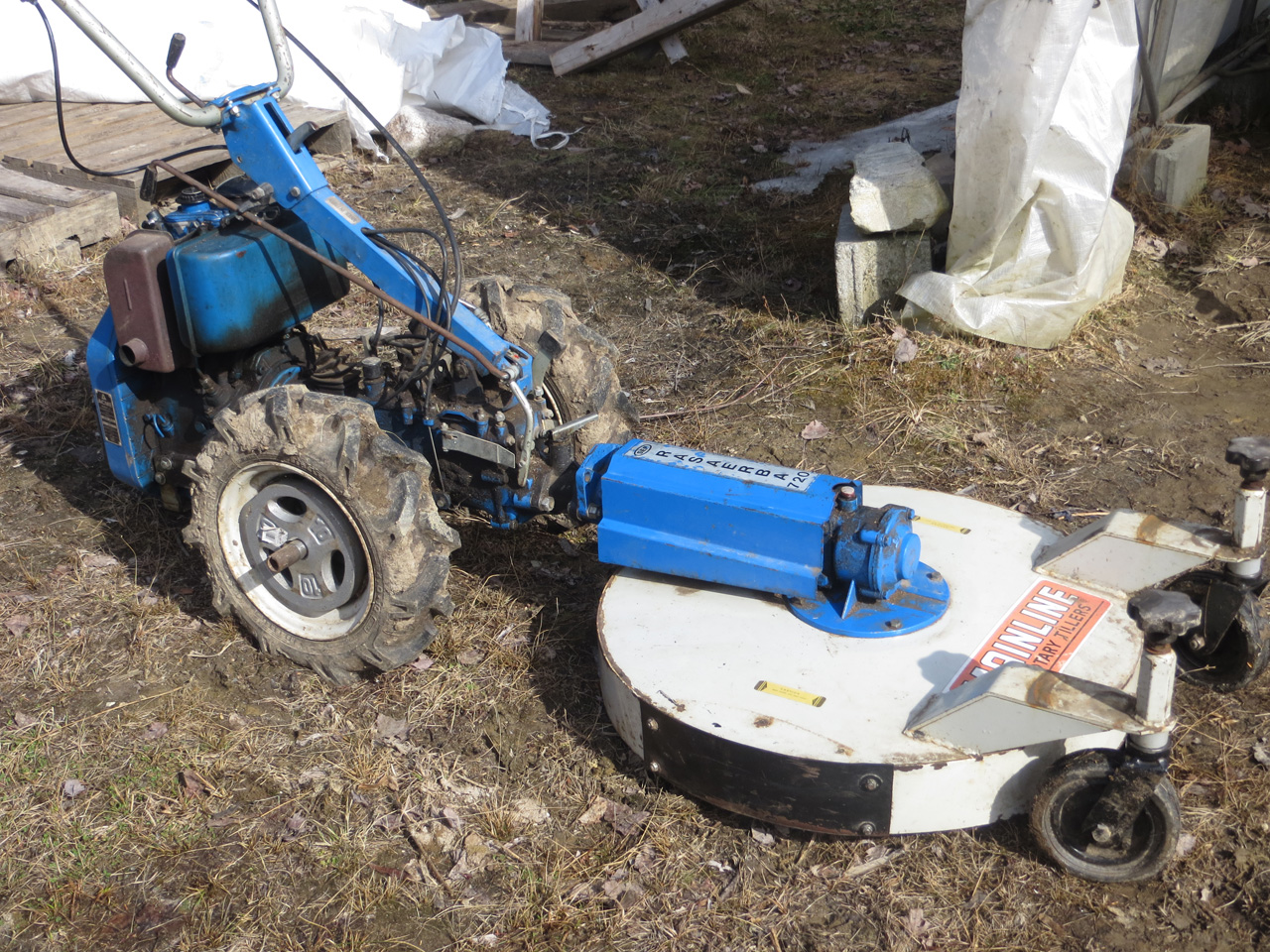

I have a SEP Mainline mower. This one was side discharge pushing long cutting in row Bad job. I remove the side discharge Make a round steel plate for replace the side discharge. So the blade cut and recut mulch in fine small parts Make a better job. Mulching is good for lawn . Make food and help to keep moisture. May be you can modify your 38 inch BCS deck for make a mulch mower.
I think for two acres you need a sulky . Some years ago I make one wheel sulky I like it.

Thank you for sending the image of your side-discharge deck modified into a mulching deck. Tomorrow I will close the right-side discharge on my 38" BCS deck with a steel plate and see if I can mulch and distribute clipping satisfactorily.
Your gravely tractor image shows modified rim and tire. Do you have any comments about changing the BCS tire size from 5.0-10 TP B 17 to a larger rim and tire that might increase ground speed?

Just a thought, Gravely did make a left hand rotation 30 deck. Now I have never done and Im not sure it can be done, but lets say one was to put a left hand rotation deck on a BCS with a right hand rotation blade or a right hand rotation deck with a left hand blade, something to look into? The left rotation boxes are old and the left blades are hard to come by but they still exist. The wheels on the above Gravely look to be for the optional gear reduction units available on non swiftmatic (8speed) units, usually the L models.
