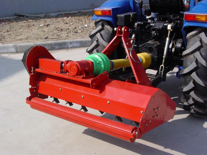

<font color="red"> Please who can explain "FLAIL MOWER"!!!??? </font> /forums/images/graemlins/confused.gif

/ Mower Types #10
As far as an "Implements for Dummies"- I ended up just reading this forum as far back as I could stand. There is a lot of repeated information but I learned a lot and figured out what I needed to get my projects done. Now I just do a search of the forum when I have specific questions. Lots of good info.
/ Mower Types #14
Andy,
Depending on the type of hammer used in a flail mower, you can have a rough cut with relatively thicker material chopped (let's say up to 3") vs. a more finished cut but thinner cut capacity (3/4 to 1 "). Different hammers are even available so you could turn your flail cutter into a dethatcher!
The primary advantage of a flail mower is that they tend to be safer to use around buildings, cars, people and livestock because they are less apt to discharge high velocity projectiles compared to a typical mower/cutter.
Hope this helps! Steve
