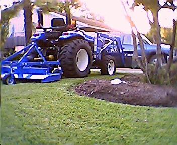

I have a 72" FC RFM that I use behind my New Holland TC33D (The Mid size chasis).
I bought it to maintain my 2 acres. But I have also use it to mow my yard at my current house. My whole front yard is about 40' by 25' with a lot of curved flowerbeds. I get some really strange looks form my neighbors but seat time is seat time/w3tcompact/icons/laugh.gif!
It makes my yard look better than when I use my 22" walk behind mower and manuvers around the free form curved beds with ease. I hardly have to even trim with the line trimmer al all.
I would sugest the RFM with the larger tractor. Can't go wrong with that combo IMO!
