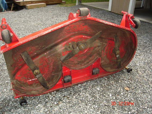

Has anyone used a pressure washer to clean under the deck when it is on the axles? Will the pressure washer blow it over? Or do you have to support it somehow.
/ mower deck axle stands #15
I used a pressure washer while mine was on the axle stands with no issues. It would take a fire hose to knock it over or the world's most powerful pressure washer in my opinion.
/ mower deck axle stands #17
Ditto Evil the Weasel-- but just to be sure, I approached the upright deck carefully to test stability as I got closer. No problems, and the pressure washer did a very nice job, even on gravel driveway. Those axles work very well, glad I got a set!
