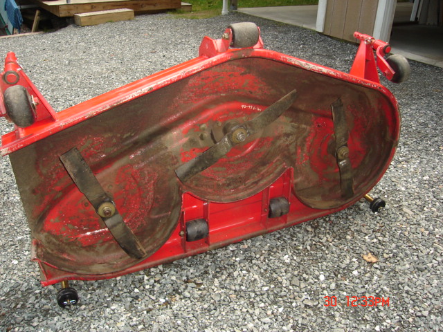

On many decks if you have one set of fixed wheels, you can flip them upside down (oposite of the ground) on the forward cutting end and stand the entire deck up and it will sit perfectly upright. I did it on my GC2400 and it works great without the added cost. I move mine all over the garage and pressure wash it with a 3500PSI washer with no fear of tipping. Just a thought to try...
/ mower deck axle stands #22
Iplumb- I made mine out of couple bolts and 2X6 cut into a wheel on table saw.
/ mower deck axle stands #23
I made mine out of some old garage door spring shaft I had laying around,about 10' long some holes drill for cotter pins and some old wheels or new one that will accept 1" shaft.About and hour once you got the parts rounded up.hacksaw, drill and bits is the tool list.Have fun
