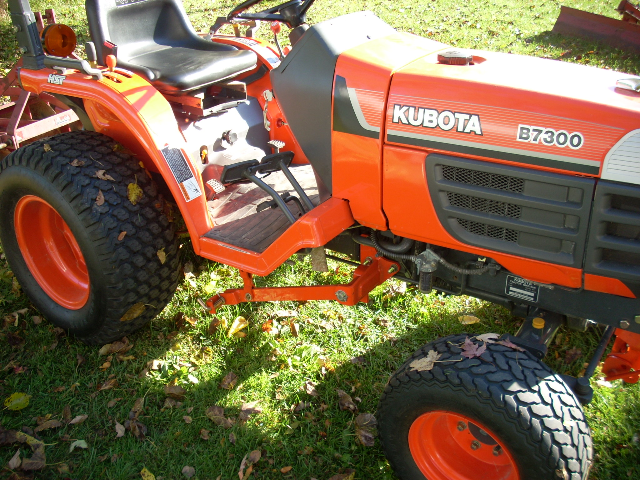

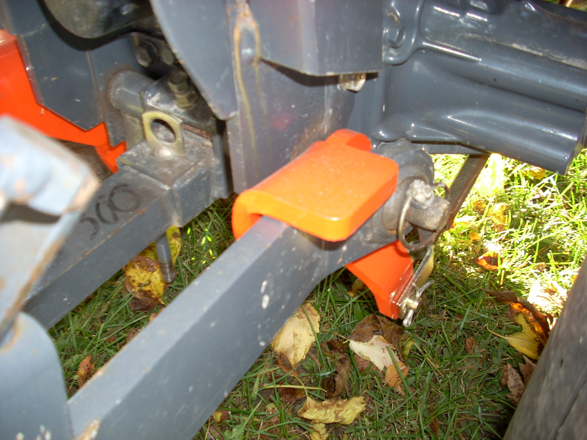

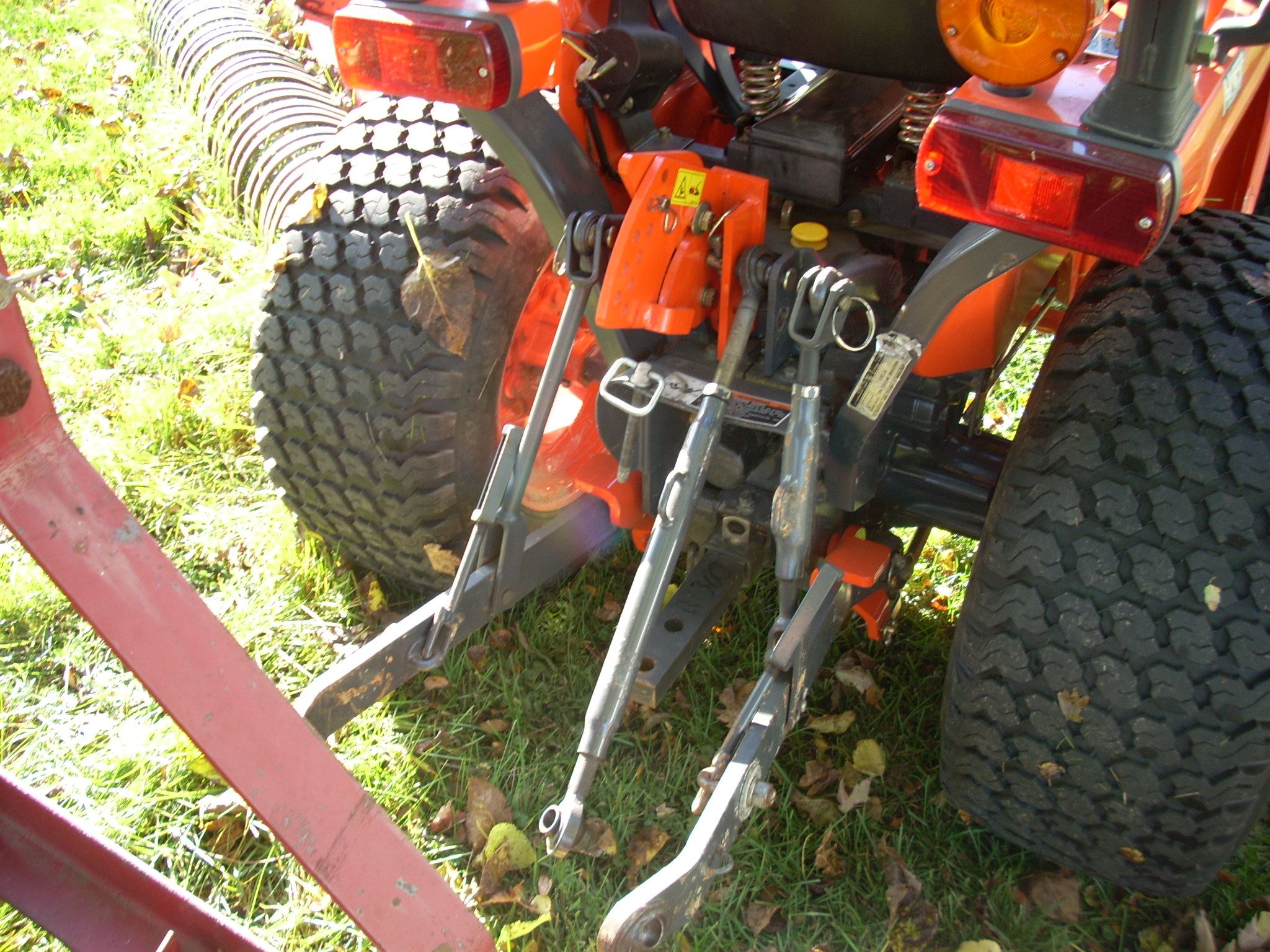

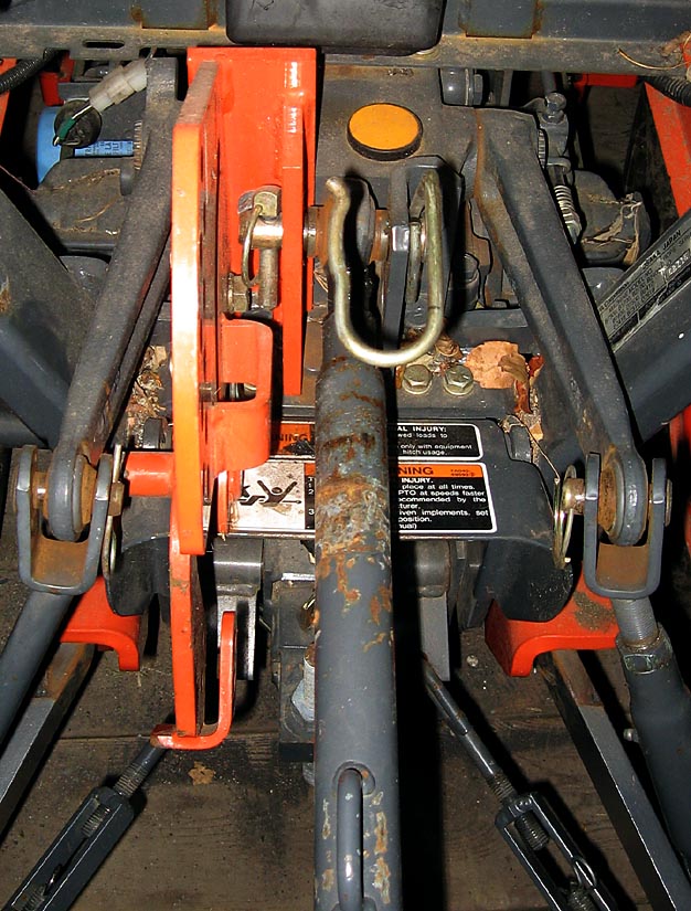

I have a friend who recently purchased a B7300 (pics attached) with a newly installed mower deck. With the deck installed and working properly, the arms on the 3 point hitch are limited in their lift height. (2) brackets that came with the mower deck have "ears" that prevent liting the 3PH very high. Do these brackets (pictured) need to be removed with the mower deck off to fully realize the lift height on the 3PH? The ideal situation would be to remove the deck only and NOT remove the brackets and hardware to be able to use the 3PH.

I have a b1750 with the same setup as you. I use my 3ph with my mower deck still attached and it raises up fine all the way. Those ears are what actually raise and lower the mower deck. It uses the 3ph lower arms to raise and lower the mid mount mower. If his 3ph is not raising implements up all the way, I would suspect a different problem.
Good Luck!
/ Mower Deck & 3PH Lift #3
The mower deck lift linkage doesn't/ shouldn't impinge on the lift height of the 3ph. If for some reason the 3ph is being restricted from full lift by the deck linkage, then something is seriously out of adjustment.

1st thought:
Is the connecting rods that go from the orange brackets on the 3pt arms to the mower deck lift are not adjusted correctly and need to be lengthend so that the mower lift mechanisim doesn't stop the 3pt arm from raising.​
2nd thought:
Is that the connecting rods are the wrong length for your tractor and mower setup.​
3rd thought:
What is that bracket to the left of the center link on the 3pt? Is it possibly in the way of the left lift arm?​
I'm sure if you look at it long enough you will see what it is being limited by. With the 3pt lowered all the way down you should be able to raise and lower the 3pt arms by hand and not have the tractor running and risk damaging what ever is limiting it from raising all the way. There is quite a bit of power in the 3pt arms.

This might be a stupid suggestion, but looking at where the mower brackets attached to the 3PH lower arms, any chance you have them reversed left side vs right? The way the are now, it looks like the top of the orange bracket will hit that bump out on the transmission just above it as it raises.

The lift rods probably need to have the length adjusted so that the mower tops out when the three point is at maximum. Gotta also make sure the stop for the three point is also set right for this to happen.:)

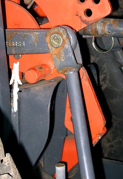

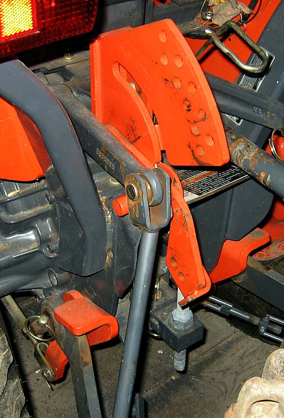

After looking at your pictures again I think there may be a problem on the orange assembly that is near the top link connection. On the left side (that is obscured) in the second picture there is a large knob that supposed to go under the 3ph upper left lift arm. It seems so that it might be above the lift arm thus limiting the lift height very firmly. In fact that is the function of that whole thing but it supposed to go under the lift arm and limit how far 3ph arms and the deck goes down. The pin that selects the height of that knob also determines the cutting height. When the deck is not in use that pin must be removed because it limits the lowest position of the 3ph lift arms. If this is the case the linkage under the tractor may have nothing to do with the problem at all. It actually sounds a bit complicated, but dealing with all this adjustment stuff only takes seconds after a proper setup. I could send some pix a little later if you would like.

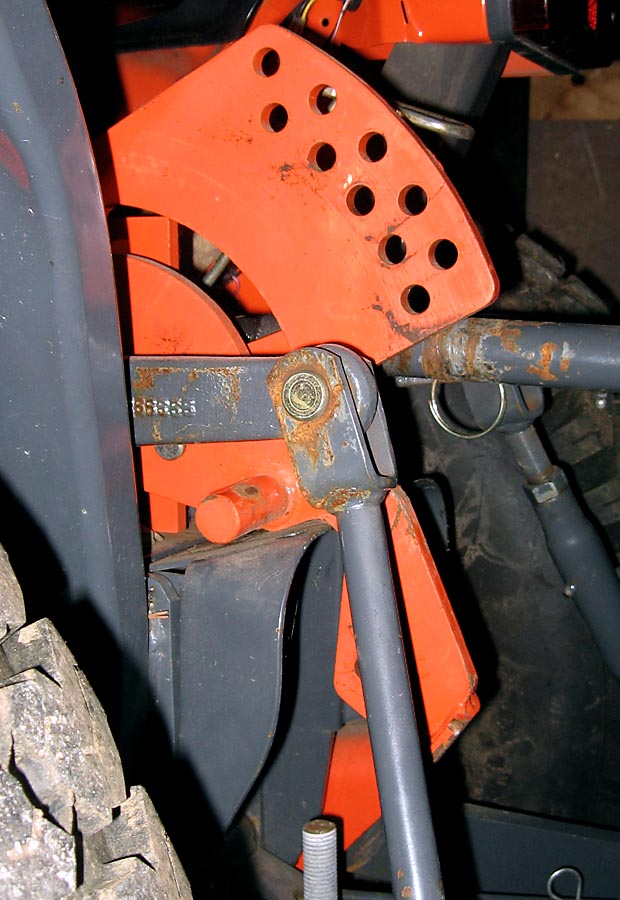

Here are some pictures what I think is pretty much the same setup your friend has. The adjustable thingy (let's call it limiter mechanism) is swung all the way down and pinned in the lowest, out of the way position. There is a lonely hole near the bottom of the steel plate that serves this purpose. In one of the pictures I fashioned an ugly arrow pointing to the pin in the plate. The many holes next to each other are for the deck height adjustment, only used when mowing. I didn't have the deck on the machine and it supposed to be set this way as for not to be in the way of the 3ph operation. You can see the large cylindrical knob right under the lift arm just to the right of the ugly arrow. The lift arm actually rests on that when the mowing deck is in use and the limiter mechanism is pinned up in one of the several holes. That way you can raise the deck but can't lower it any farther than the preset height.
I hope this helps.
