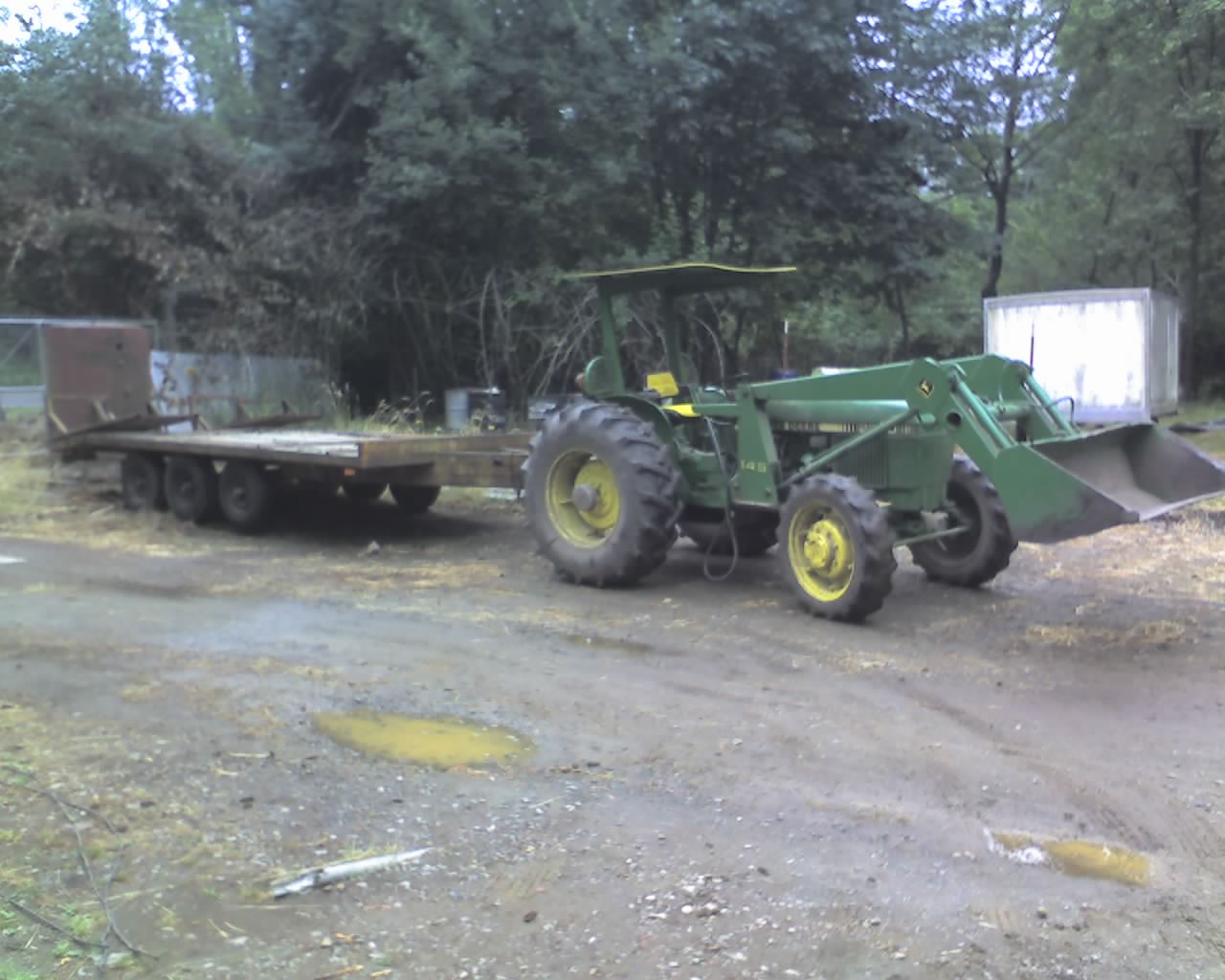

I move trailers with a ball on the FEL. It is much easier to see where your parking it that way. I first tried the rear hitch and the visibility was not good if you have a high trailer.
I use my 1910 to back my car hauler into the pole barn. It is much easier than the truck.

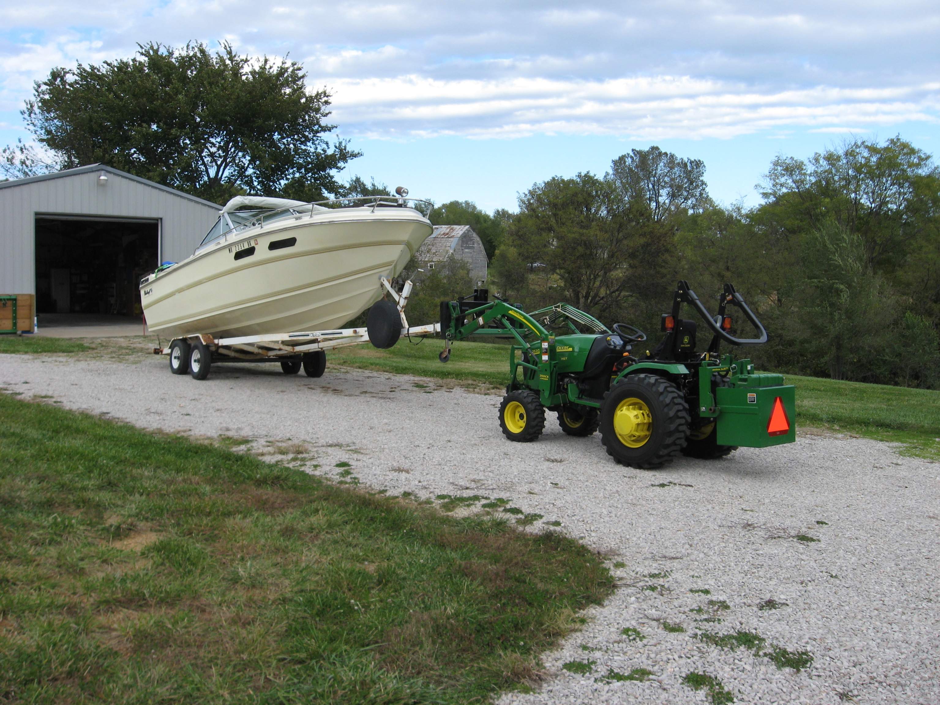

I move about 5000 lbs of boat and trailer around with a loader-mounted hitch, on a JD2520, but for your tractor, I'd probably stick with a three-point hitch. I'll bet it can handle it (level ground).

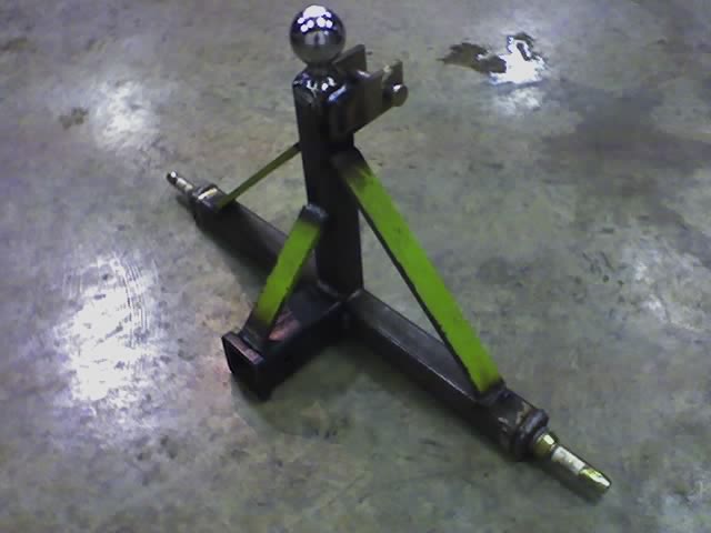

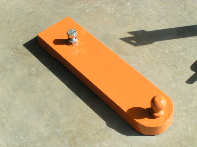

Here is what I designed for what you're talking about. It has a 2" insert for regular trailers and a larger gooseneck or 5th wheel ball on the top. I don't use any thin or weak materials either. I make my movers out of 3/8" side wall 2" square tubing with 1/2" flat bar bracing. No cheap crap here. That way you can use one implement for either type of trailer. Since everything around my area is concrete, I use the adapter shown in the 2nd picture on a fork of one of my forklifts to move any type of trailer, including pintle hitch trailers.
If you have an FEL on your tractor, I have designed several receivers that either weld on or bolt on them for moving trailers as well. It only took one trailer falling on a steel toe boot so hard that I had to have the boot cut off (boot saved my toes though!) for me to start designing better methods of moving trailers.
