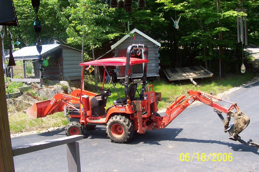

Has anyone ever put a trailer ball on the back end of the backhoe? Seems to me that would make it easy to fill then carry a small trailer with minimal disruption to the lawn etc.

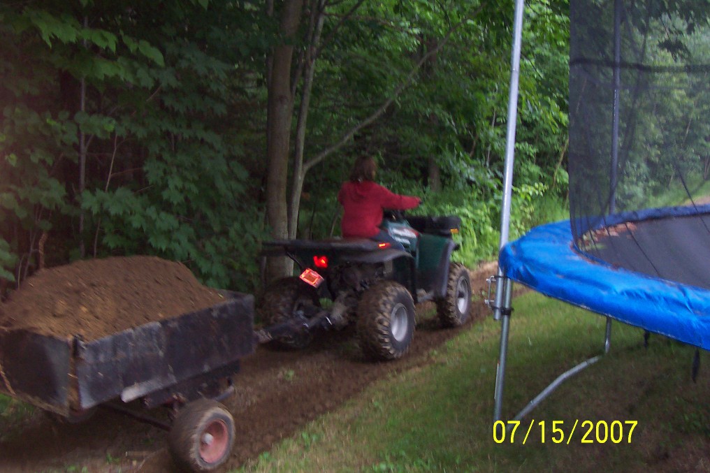

   / Moving stuff with a BX24's backhoe. #14
RedDirt said:
Got a picture of your homemade dump trailer?
HERES ONE with daughter playing truck driver:)
YES.Its a junk of i beam with a hole in it so i can use my diffferent balls that go with my reese hitch.Grab it with my thumb and go,works great.SIMPLE TO MAKE.
ALAN
   / Moving stuff with a BX24's backhoe. #16
Alan,
That is a GREAT idea. I was considering welding a reese receiver on the back of the bucket, but this is a much better idea.
Thanks
