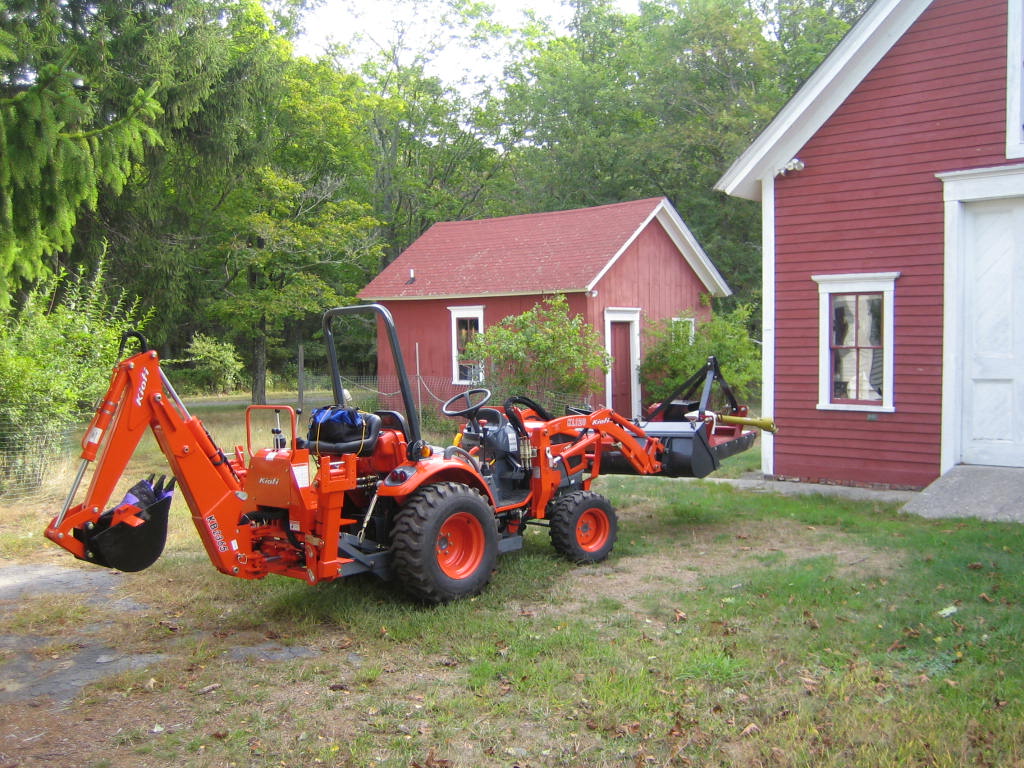

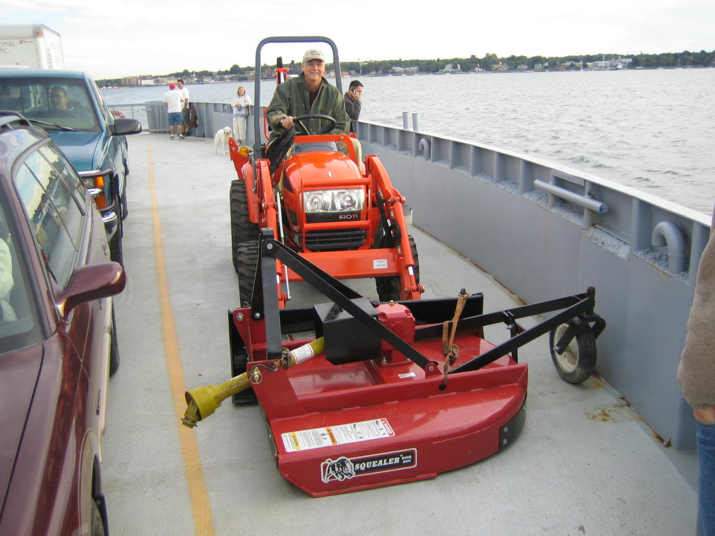

When I first got my tractor I had to move the tractor with fel, the backhoe and the bush hog at the same time via a ferry trip. No possibility of two trips. The backhoe was mounted, and the bush hog was loaded into the bucket and held in place by a number of straps. Worked fine. Drove about four miles along dirt roads with lots of bouncing and nothing moved.
