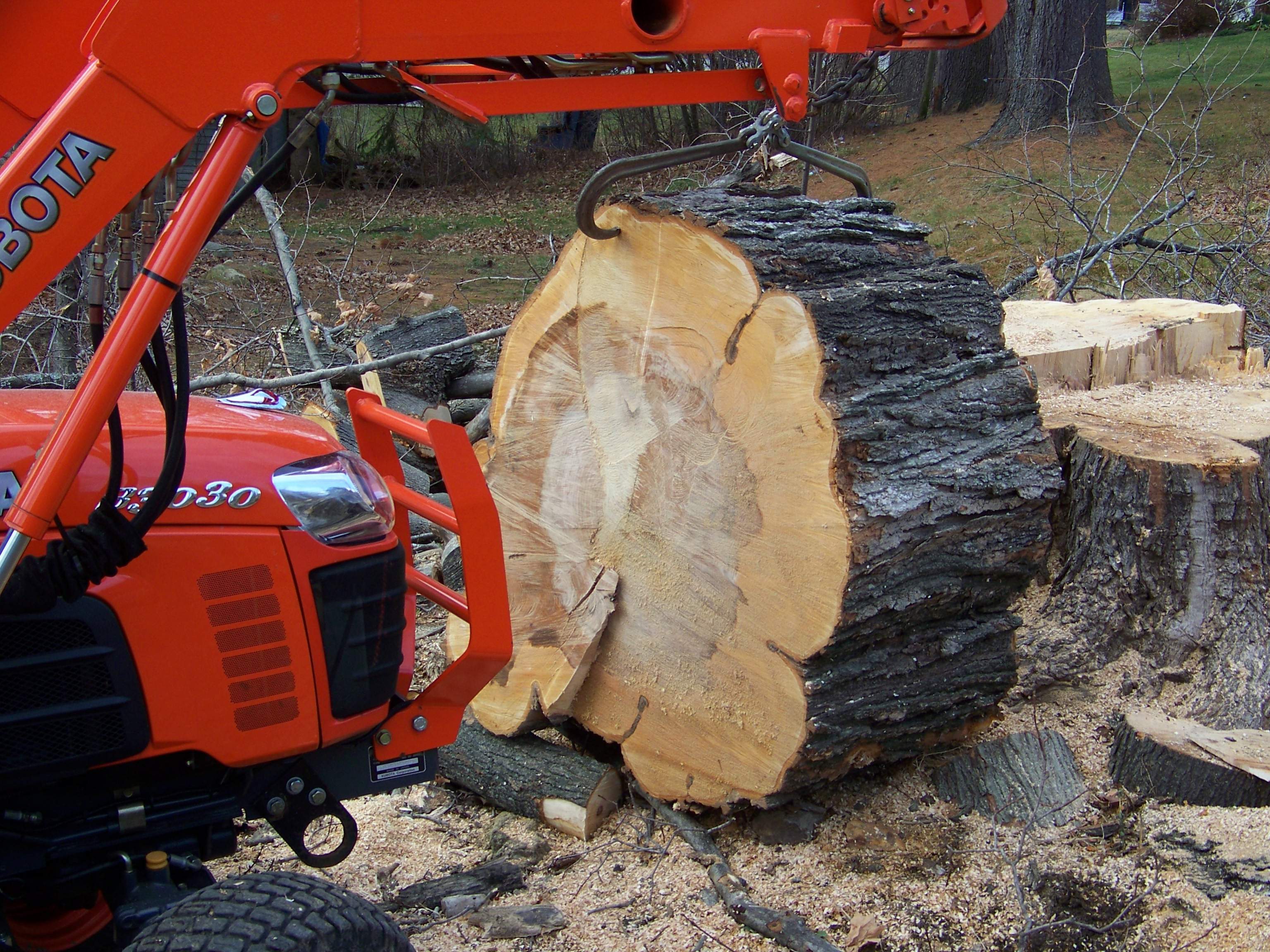

Do you have a set of forks? How about a three point carry-all?
I used an attachment I made with a set of tongs to move my 4' Sugar Maple rounds....... but I wouldn't want to go very far with them hanging. It wouldn't take much swinging to flop the tractor over.

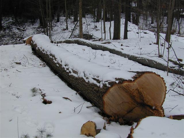

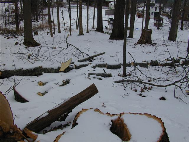

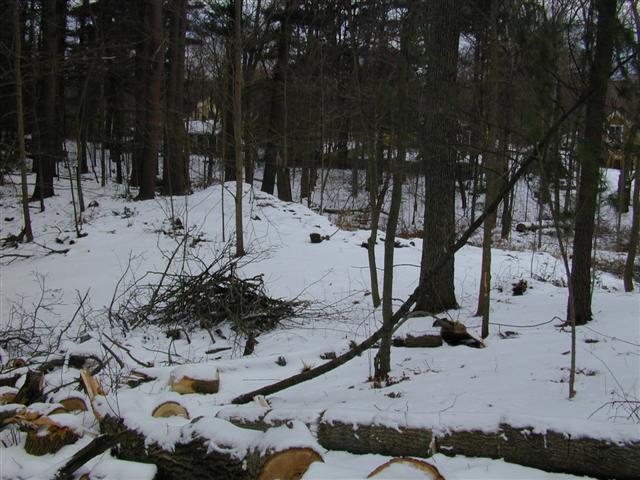

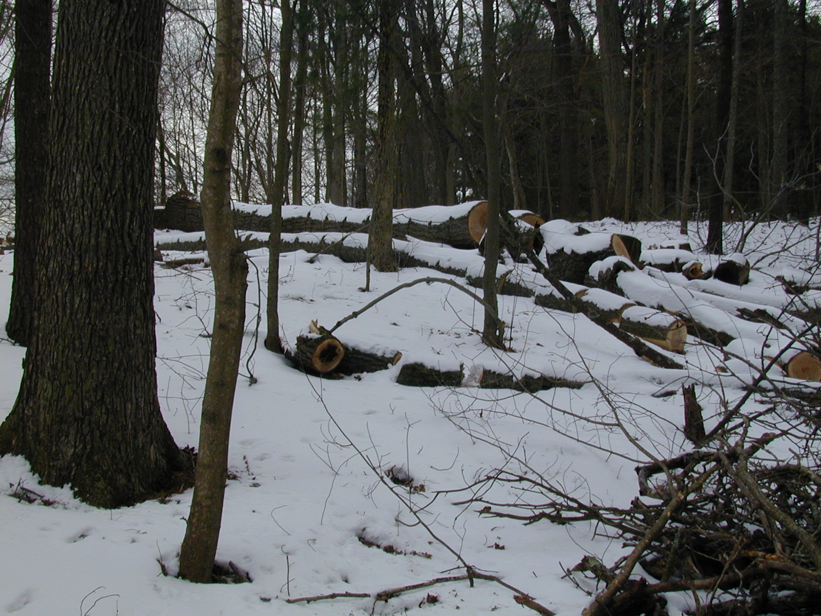

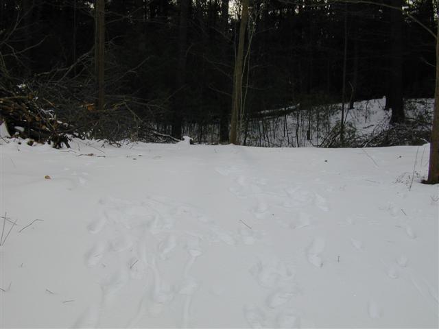

Pics added

First couple of pics are from the dropped tree to the splitting area. In this area where there is just a clear area of snow I can get my splitter and small utility trailer. I usually move the rounds to the small hill and then I take them and load them onto the log lift and can take the split wood right from the splitter table and throw the split pieces over my shoulders into my trailer.
Not sure how well you can see the topography but there are a lot of small hills and as I mentioned I don't think I'd want to move any large rounds in either my bucket or with tongs any meaningful distance. Where the tree is there are a lot of stumps. Difficult but not impossible to get the splitter there but then I'm taking my tractor down that rather steep incline to get to the utility trailer. This is my parents yard - I take the wood a couple of miles in my utility trailer back to my house. There is a picture of my parent's house to give you an idea of the grade. We used to go sledding down that hill as kids. Not sure I want to go sledding down the hill with a tractor full of wood. In the picture that shows the flat area there is a nice path I can take where I bring my utility trailer full of wood to the driveway and then attach trailer to my truck.
Thanks again for ideas. No matter how much work it is I will be getting this wood off the hill one way or another - there's a lot of it!
