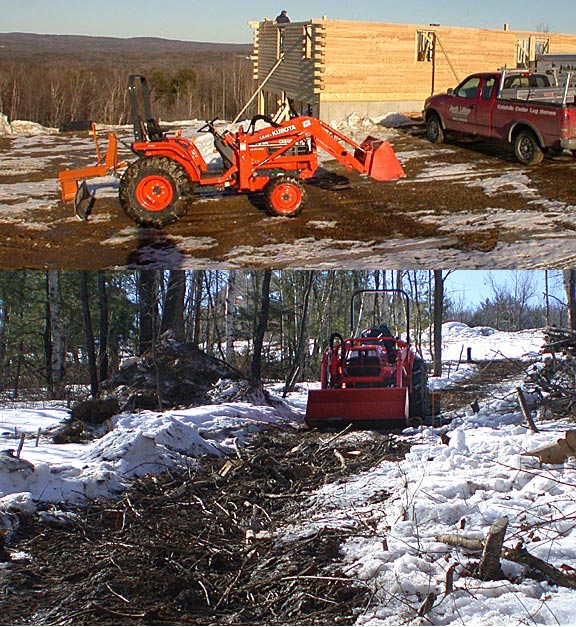

Thanks for imput everyone. Was on site at 8AM today and low temp had frozen all up solid, but yesterday before leaving the 12" plus ruts of mud, we filled them with brush and waste chunks of cedar logs from our new home. Ground remains frozen in woods except for this 20' section of mud. I made 4 trips this AM before ground started getting soft. Backing up seemed to work best. My R4's are calcium filled and they do have chains. It was the fronts that got bogged down in the mud yesterday. I need the field stones from my rear stonewall to build field stone chimney and retaining walls. Just know that March and April won't be more favorable in regards to MUD. More pics on http://homepage.mac.com/boblegg/LeggLogHome/PhotoAlbum15.html

Great photos..Looks like a great day for outside work.
Maybe a little ditching on the wood road might help to keep the dirt dryer.

Great Pictures. I sure like view and Log house. /w3tcompact/icons/smile.gif Is the house being built for you?

My Katahdin Log dealer is doing the construction. I'm coming up with these odd jobs to justify my Kubota. Actually the stone mason gave me a deal for using my own stones. He'll also get his tracked loader in their sometime before end of April. Thomas, side ditches are a good idea, I'll try to add them. Do have to remove more stumps along the way before that. I did the chainsaw bit in the summer and fall before I bought the Bota.
