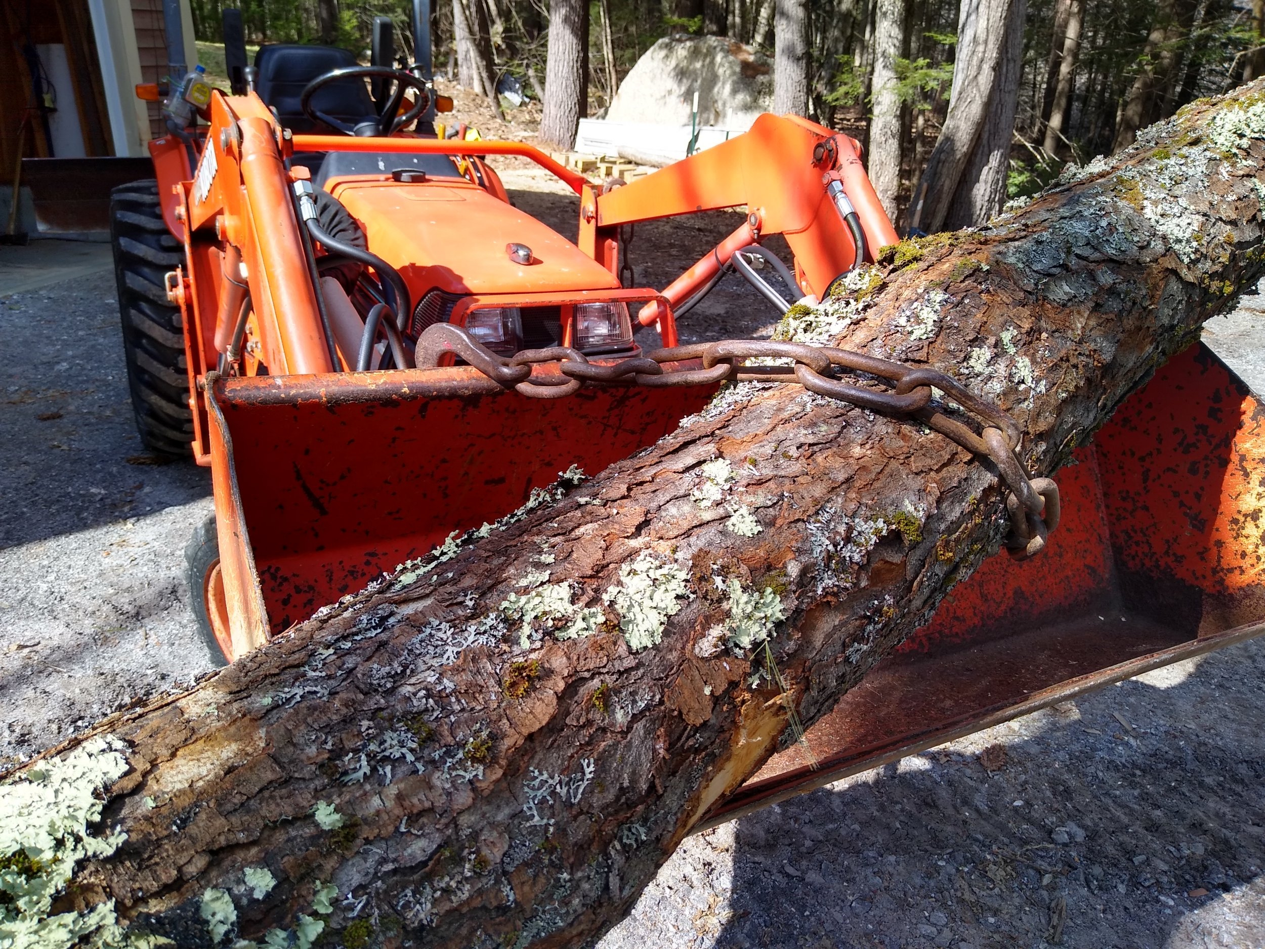

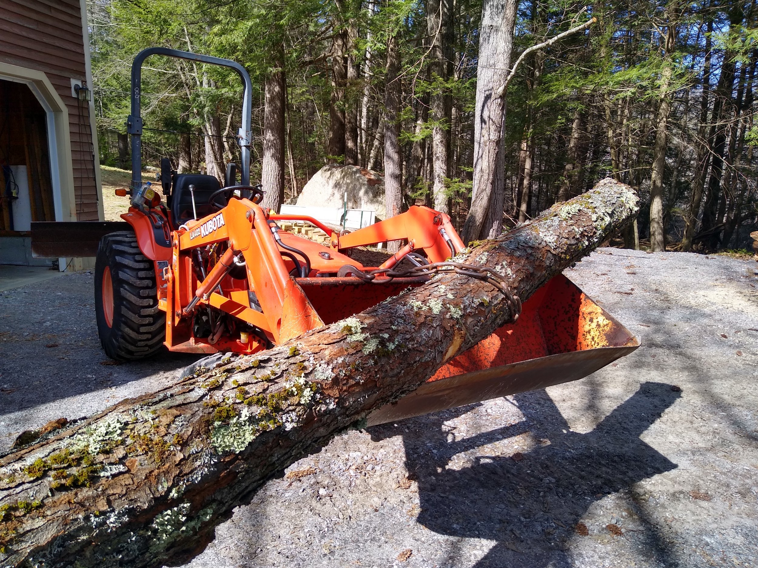

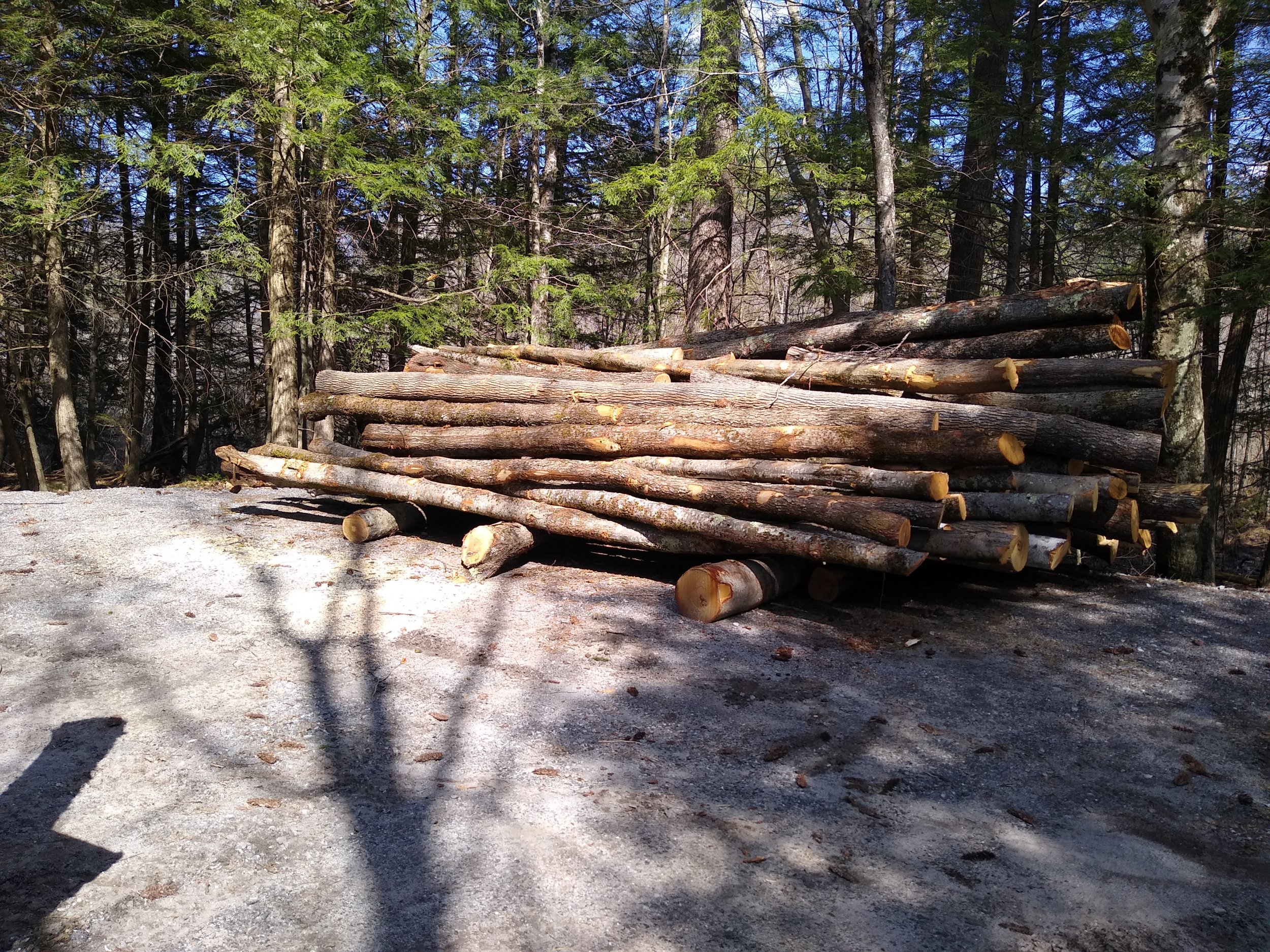

I have a Kubota B2710 which I love, but here's my problem. My logger dropped a grapple load of wood in front of my garage (the only place he could) so it's difficult to get the cars in/out, and it will be impossible to plow next year. It's at least 3 years worth of wood, so I need to move at least 2/3 of the pile before Fall. So far, I've been doing this by cutting each log in half and I chain each "half-log" to the bucket, and move it to the back yard where it's out of the way. This often involves climbing onto the wood pile to unhook the chains. As you can imagine, this is only marginally safer than Alaskan crab fishing.

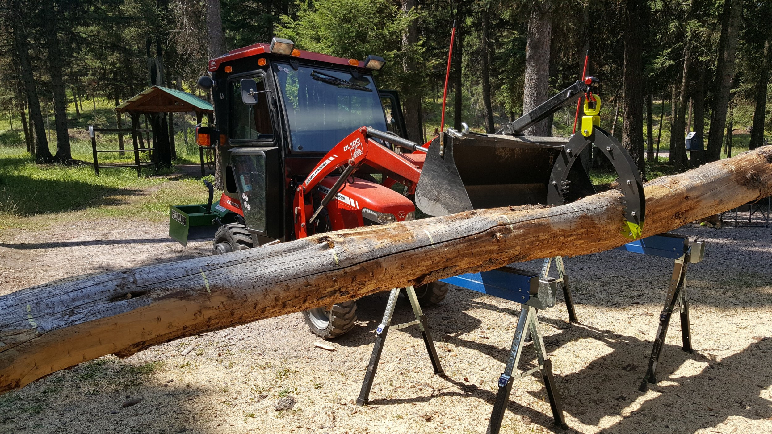

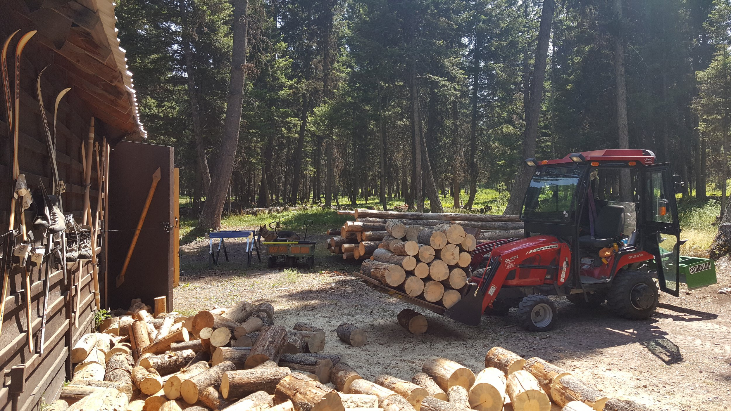

/ Moving Cordwood #9

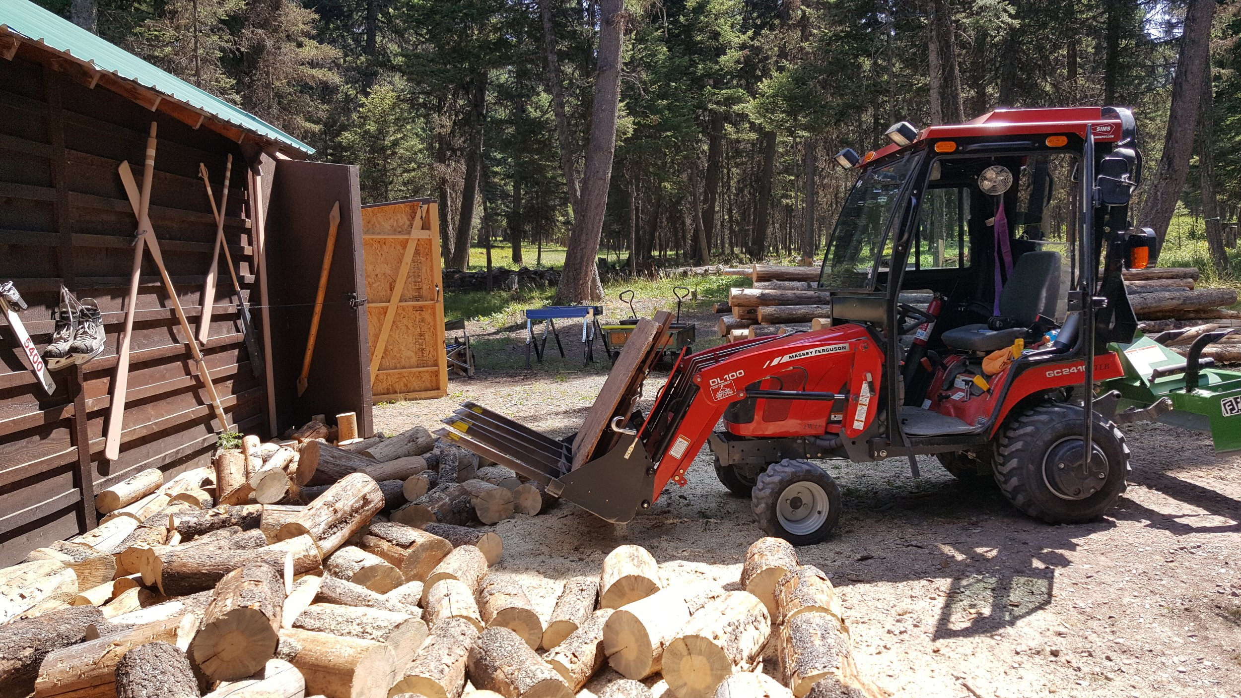

This is how I manage my firewood (18') logs, and if I were going to just move the pile of logs I'd use the brush forks because they will handle 2 to 3 logs at a time.
KC

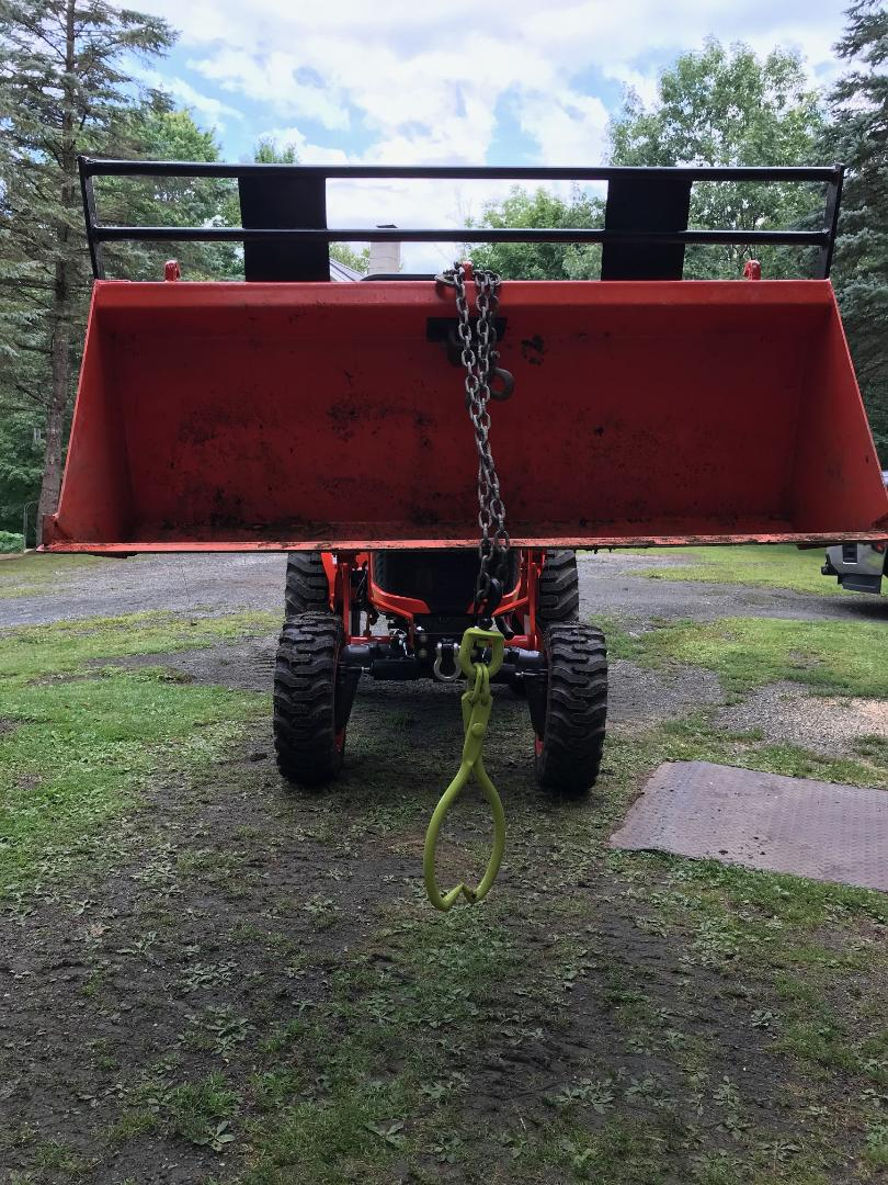

/ Moving Cordwood #10
I've had good luck using tong moving wood.
How did you get the "back fence" on the bucket? I like the idea of logs not ending up in my lap. But with those tongs, the log would want to go parallel with the tractor.(?)
This might work for me. I'd use a shorter chain, so the tongs (& log) were in the middle of the bucket. Hence, it couldn't swing, and would remain perpendicular to the tractor.
