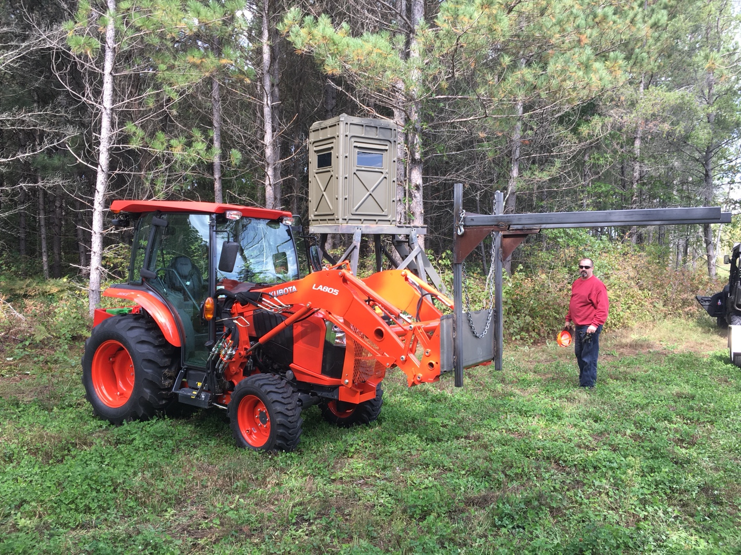

I bought a as mounting plate for my loader and welded some “high forks) to the plate. They are 5’6” long. Now I can pick up blinds up to about 14’ high at the floor....and very carefully move the to new locations.
We have nine blinds and after logging our deer property some needed moving. Gotta have good ballast and be super careful with these forks but they have worked pretty slick for me. IMG_5623.JPG
ADVICE: Dont try this on Hilly Land. Be ready to set the blind down in an instant.

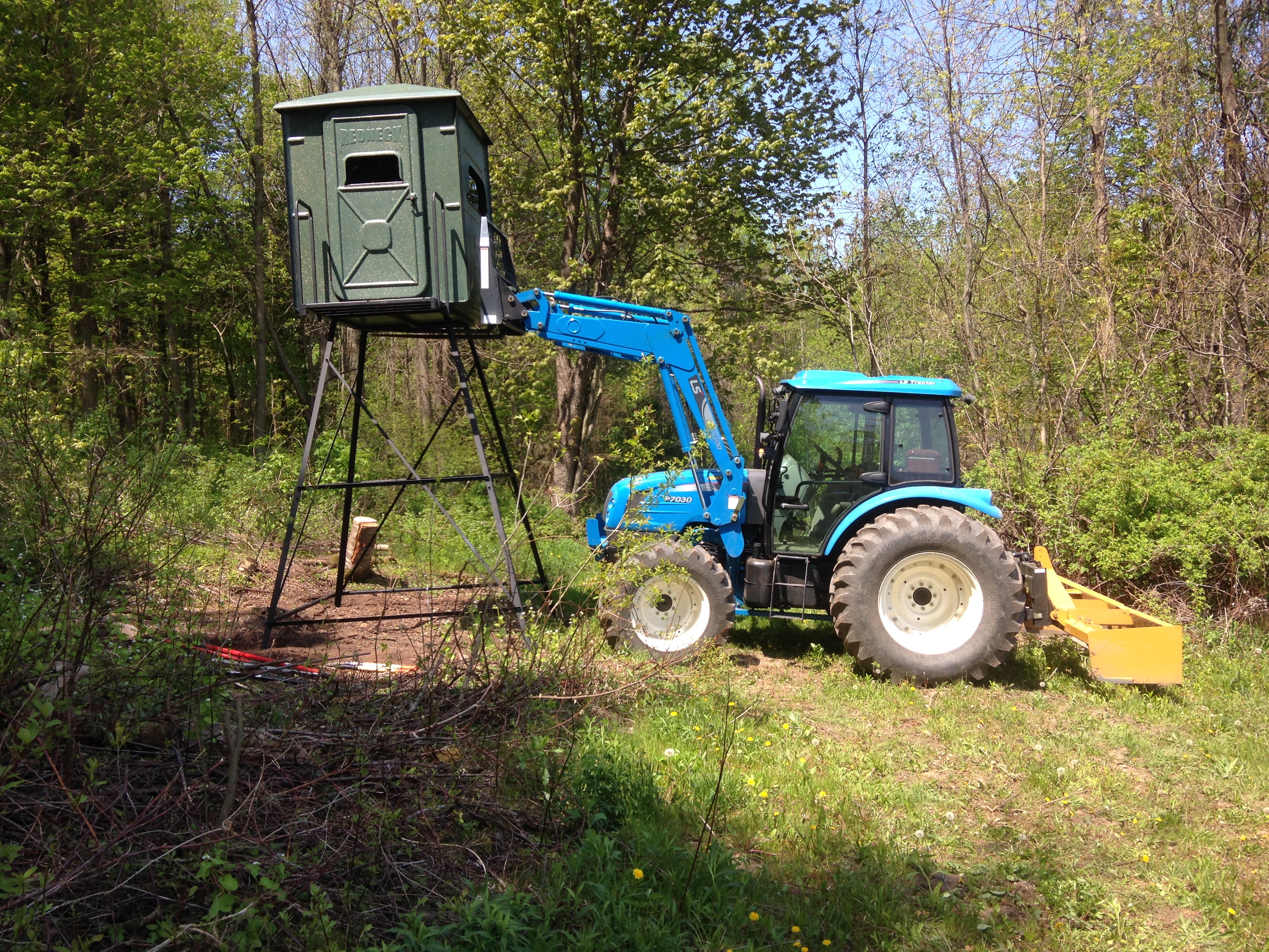

Getting ready to go down the hill:
About a thid of the way down:
Made it!
And how it looks now:

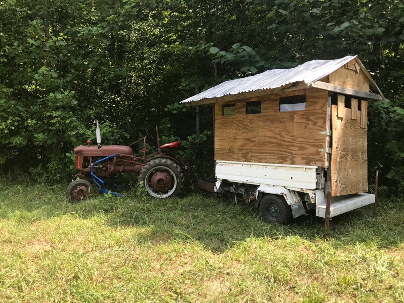

I built one on an old trailer so I can move it easy or pull it down the road, not too far, lol.
