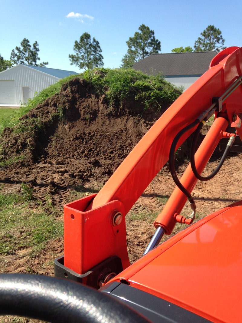

I've been around tractors for 40 years I guess, but this one is the first one with a FEL. I've had some days off and I am moving a pile of topsoil for my church and spreading it out with a box blade (at which I have a lot of experience). For the most part I've just been driving straight into the pile RPMs up and start raising and curling the bucket to get a good load. The tractor is a 45 horse Kioti with the shuttle shift, so I have to clutch from forward to reverse. I guess my question is about lugging the engine down momentarily until I break free with the load. This seems almost inevitable unless I turn a 12 hour job into a 30 hour job. Does it hurt anything to do this? I've been driving into the pile in 4wd and in first or second gear in mid range. One thing I've tried is shaving the edges off the pile which creates a lot of loose stuff that is easy to scoop, but that just seems like extra work and time. What is your general methodology, gearing, speed, rpm etc?

Do just what you are doing,,, Work that tractor,,, that's what it was made to do. You are doing it just right. If your FEL will pick it, your tractor will handle it, providing you have counter weight, but you know that any way with years of experience. BTW Box blade is one of the best counter weights you can have, and one of the most usefull implements you can have. G.

AS long as your not stalling the motor, your doing all right. With 4wd, you don't need to ram the pile at warp speed because as you lift, your front tires get ALOT more traction. Wasting time trying to get an overflowing bucket isn't worth it either, im sure as you work your way through, you will get a feel on how to load the bucket efficiently. If the pile is really packed in tight, you can start a little higher to keep the breakout forces a lil lower while filling the bucket. Happy tractoring!

Do you have a tooth bar on the bucket? If the pile is settled/compacted very much and you don't have a tooth bar, you might find it helpful to backdrag the pile to break it down a bit, then scoop up the looser debris. With a tooth bar, you likely wouldn't have any problem just digging right in. As long as you aren't repeatedly stalling the engine, don't worry about rpm dropping while you scoop. When I do a job like this, I find myself wishing I had the HST version of my tractor (not available on the DK45 when I bought mine in '06).

I find that sometimes it works best to back drag from the top of a well compacted pile so you have some loose material to scoop up. Otherwise it sound like you are doing OK. Don't ram into a pile of dirt at more than a slow walk speed because you could damage the FEL.
The best way to get a full bucket is to start with the bucket cutting edge in a slightly downward from level position and then lift and tilt back as you drive into the pile. HST is really nice for this as you can keep the forward pressure on and not stall the engine, but straight gear will work too if you gear it down slow enough. Spinning the tires a bit is ok as long as you aren't digging deep holes when loading.

I do it the same as others have suggested. Drop the bucket over the top, dump the empty bucket, and pull the top off the pile landing in front. I can usually get a couple good buckets full, then pull more down. Even if the pile seems loose, the inside is compacted on itself, and backdragging it off the pile makes it much easier. It also seems to load the bucket easier, scraping/floating on the ground as I fill it compared to stabbing the center of the pile.

On that particular pile, and at that particular time, I would work the left and right sides next, that are sticking out. Work them in, until you are past the center cut, about as much as you are in the center, compared to the outsides in the picture. Then go back to the center. If you leave points about 2/3 the width of the bucket, you'll actually have more breakout/loading force, only cutting 2/3 of the bucket width, but yet end up with a bucket full of dirt.
Just work across the face of the pile, and leave a space about 2/3 the width of the bucket, then come back and pick that point up. As you work into the pile, the face will get wider. Just keep making the narrower points, and working them off, back & forth. It will load easier, and be easier on your tractor.

Also, if the pile of stuff you're scooping with the FEL is resting on a concrete surface, you need to be in 2WD. When you push the bucket into the pile and the forward motion stops, all the driven wheels have to be able to slip. Not so much a problem for the big rear wheels. However, if you're in 4WD drive, there's a good chance that the front wheels won't be able to slip and you can mess up the 4WD system (shafts, axles, transfer box, etc).
