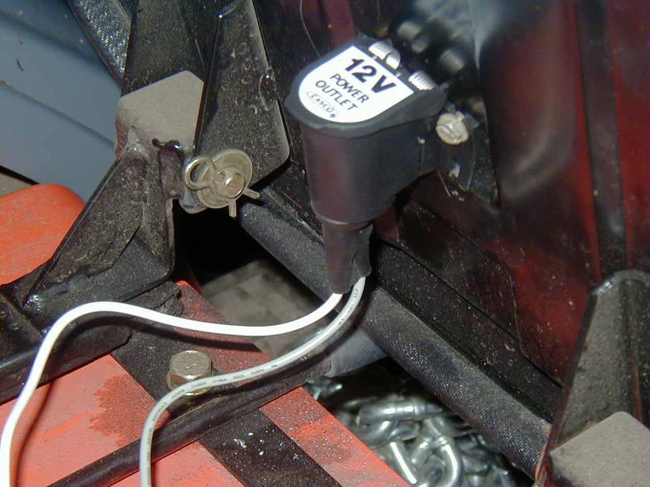

The 12V outlet is mounted under my seat, and was bought at Walmart also. Under $10 as well.

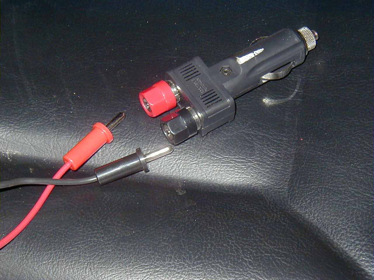

/ Moveable/Removeable Lights #52
This power plug was bought from Radio Shack. One can connect with the banana plugs as I have, or just hook the wires in directly. Note that I bought straight black and red wire to make the connections for the flood light, a coiled 12V power plug wire for the amber strobe.

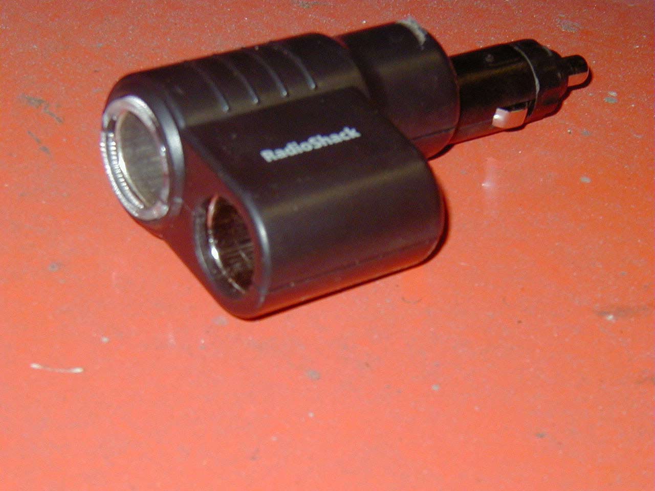

/ Moveable/Removeable Lights #53
I bought this double 12V outlet from Radio Shack as well so that I could plug in the Amber strobe and the floodlight at the same time. This plugs right into the 12V outlet, and position can change as you'll see in this picture and the next.
/ Moveable/Removeable Lights #54
Another position you can use on the double 12V outlet.
