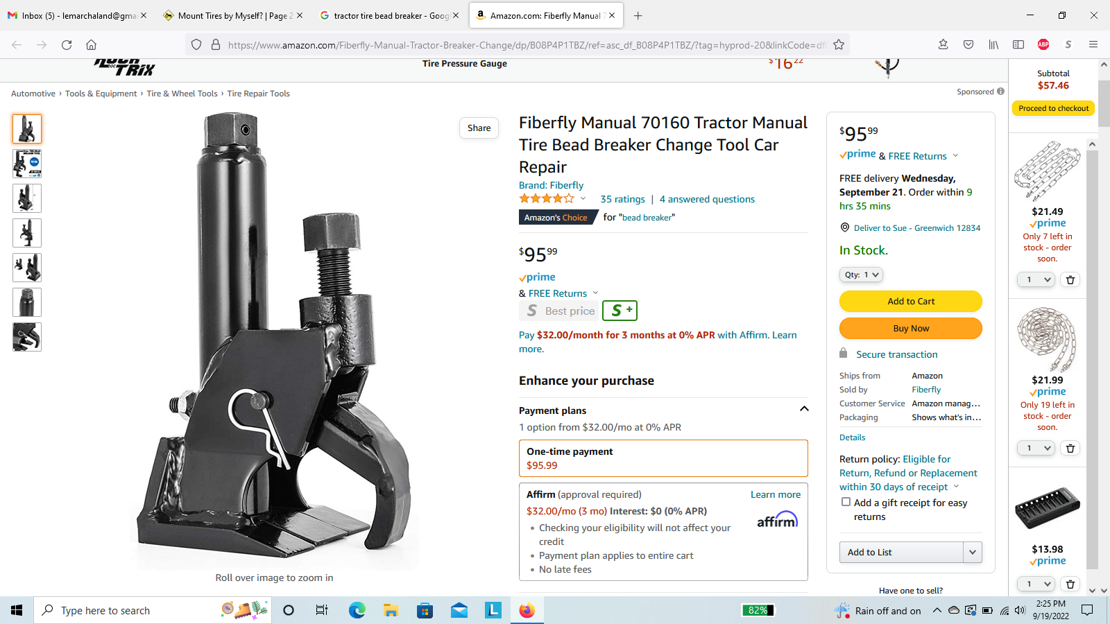

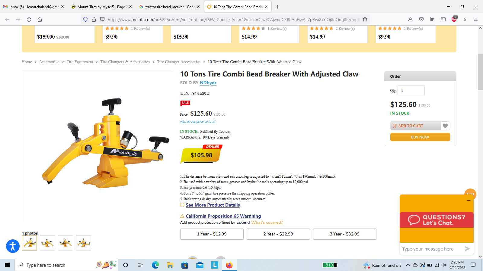

We use a bead breaker;
similar to this
I a have looked at the hydraulic style, but it is falling to the younger guys now days, so may save my money
