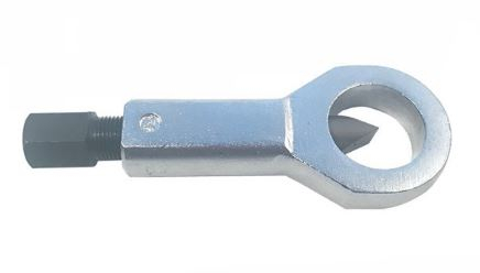

Most useful wrench​
I use my 24 inch adjustable wrench more for bending and straightening metal, than wrenching.
Not mine, but it looks the same:
Well maybe mine is more nicked up and not as shiny :D

/ Most useful wrench #28
Most useful wrench​
I went to the shop and took pictures. Not as nicked up as expected, but definitely not as shiny:oops:
It is made by Williams
