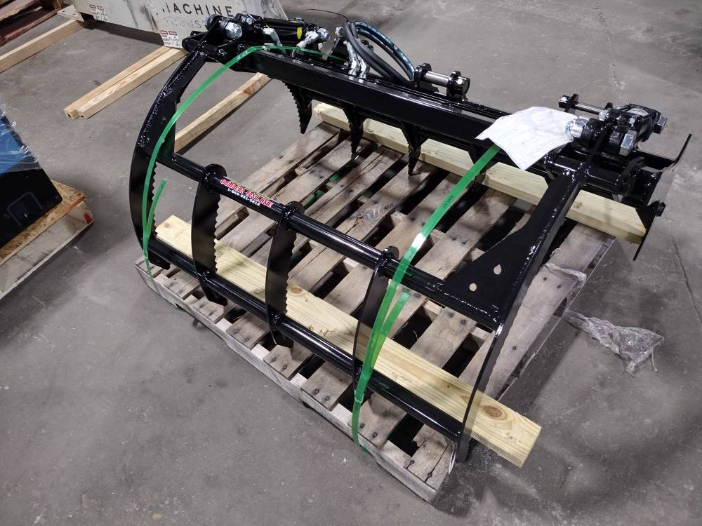

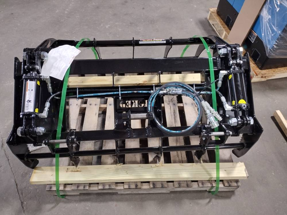

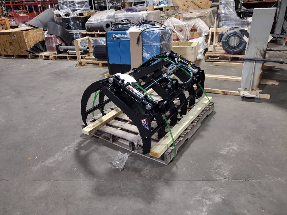

grapple is my best friend, grabs almost anything ... not always gracefully though :)

I think my Land Pride grapple is my most useful implement( SGC1560). It saves me from having to pick everything up by hand. OR reducing things to a size that they can be picked by hand. It is designed to be used on a skid steer - it's made of very thick steel - it is heavy( 820# ). I can still pick and move objects up to 3000 plus pounds.
Tough as a bull moose - the only damage - loss of some paint on a few tines.

I've been using the bajeezus out of my grapple. It's already paid for itself.
Both the raking and grappling functions are incredibly useful. Worked on cleaning up an old brush pile half a day this past weekend and got a lot done.

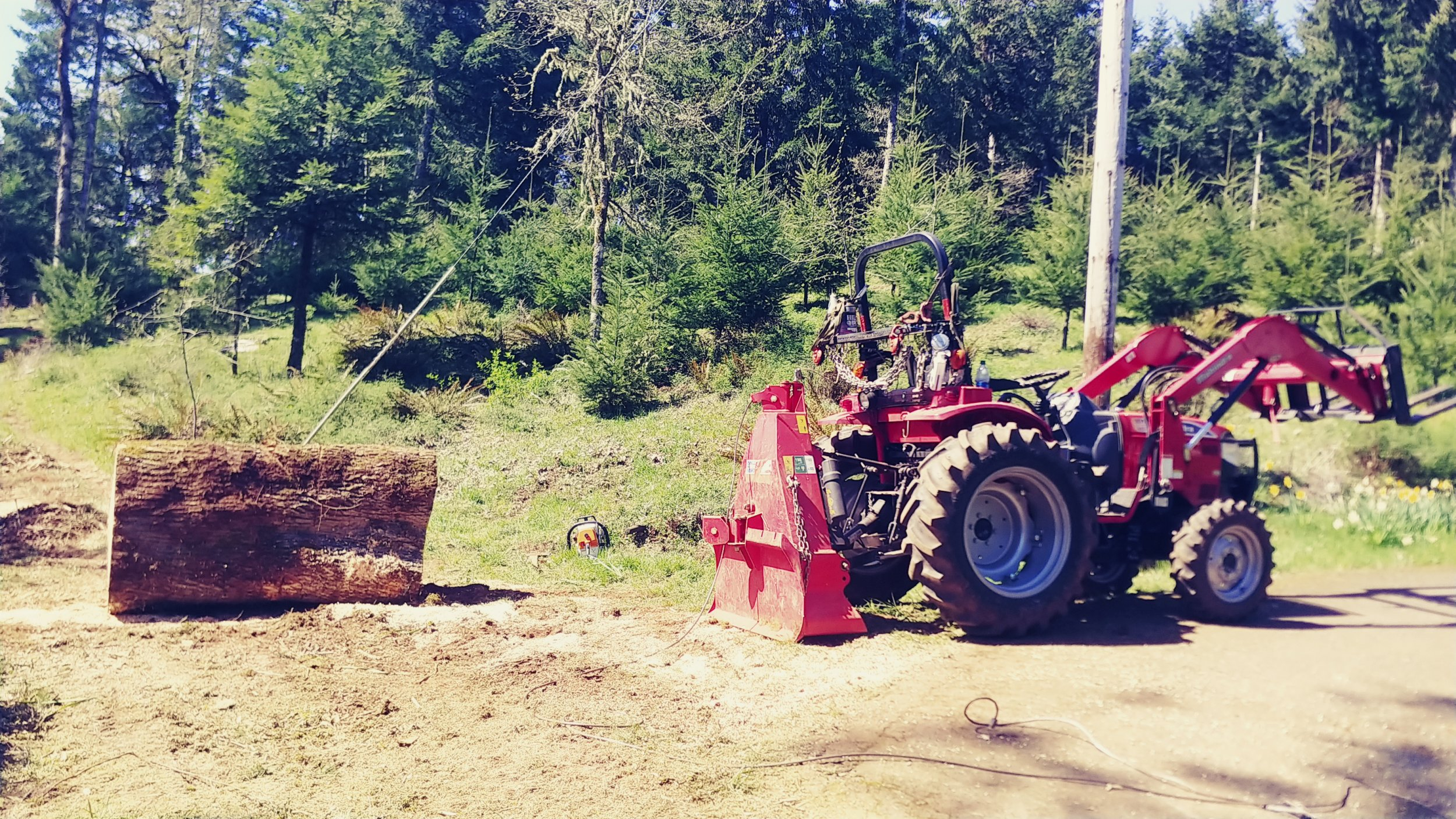

Probably gonna cause a frown or two with this tangent; but here it is; maybe the OP might want to think outside the box or come into another woodlot someday.
I couldn't do without the FEL or the FX65 logging winch on my tractor....the skid-steer FEL has 4 pallet forks mounted (no grapple yet); both stay mounted 99% of the time.
It takes me 3-5 days to do one day of work+ recovery time; I can't do much without the "help".
