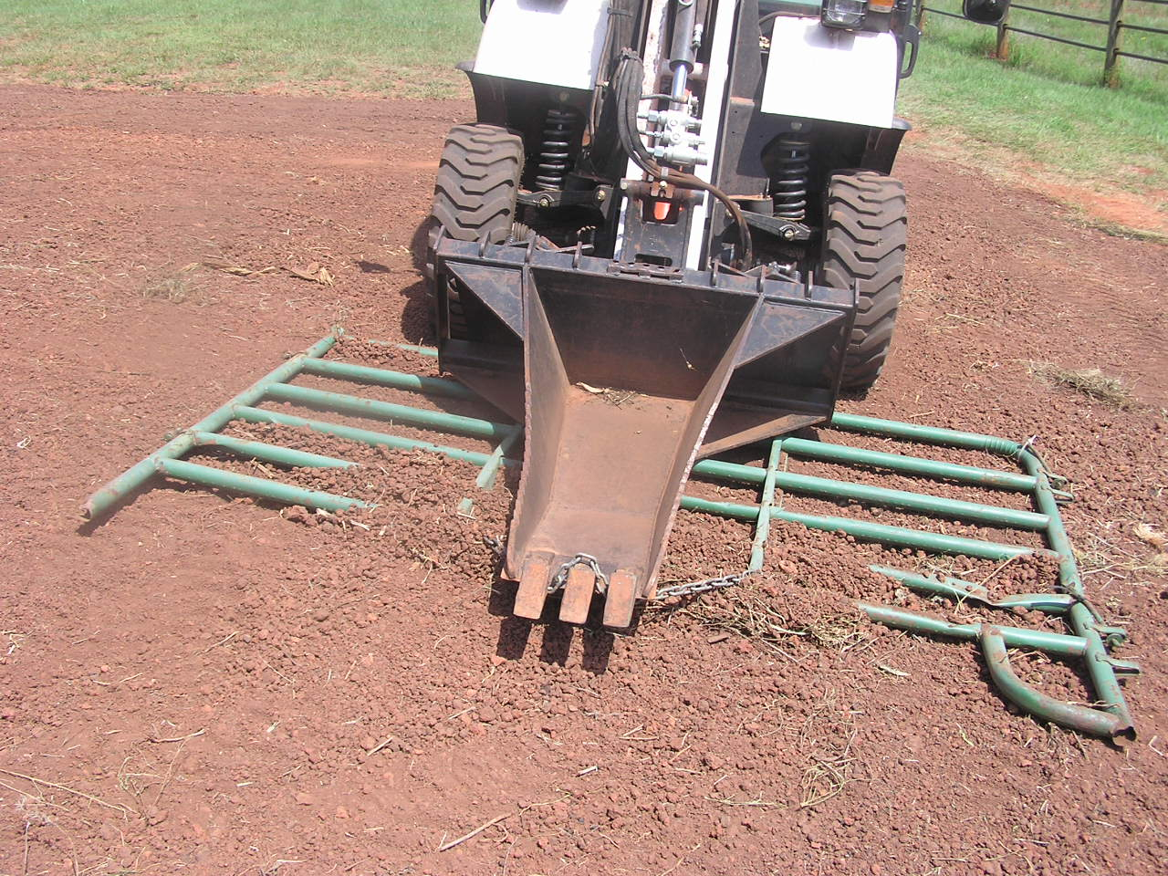

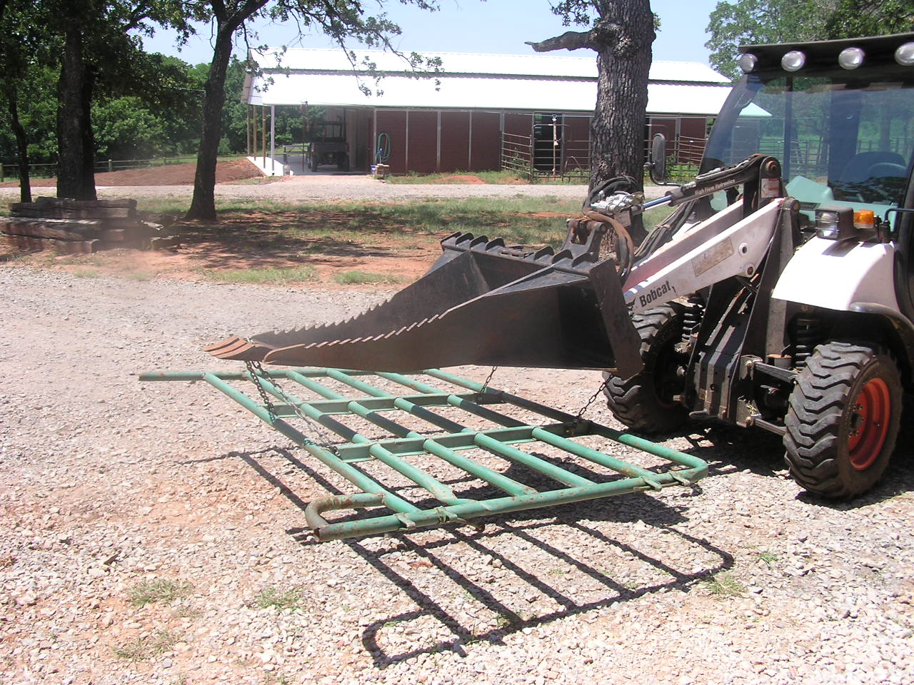

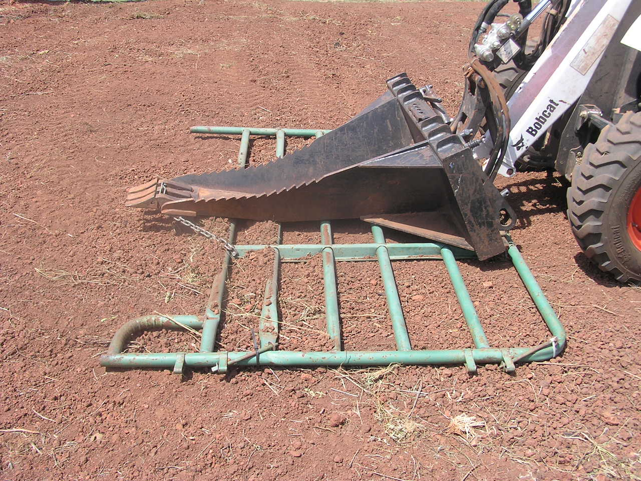

Try it. Might even work in float and add weight if needed.
With the independent suspension on the Toolcat I was able to put some down pressure on the gate.
Well, I ordered that 6' gate, I'll pick it up today or tomorrow, and try it out on a sandy "lawn" Friday.
The idea popped into my head after seeing these for a mini skid.
I thought "Hey, that might work well on my BX."
Then I saw you using your gate and thought that might work just as well for a fraction of the price, and with far less fabrication to make it work.

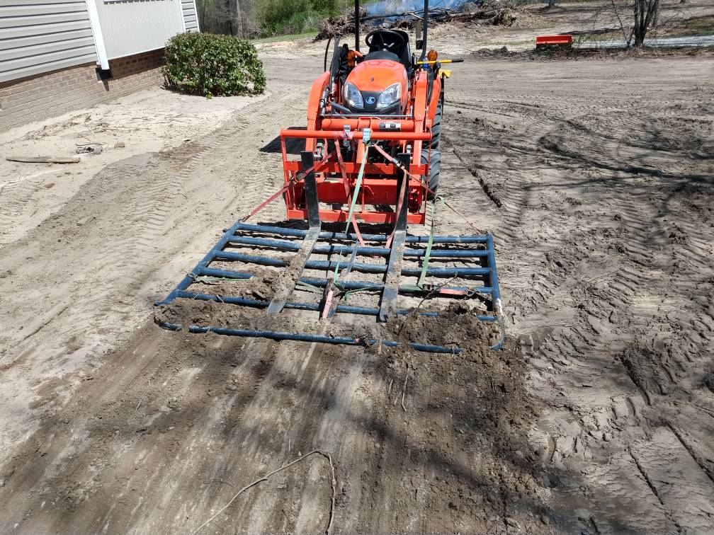

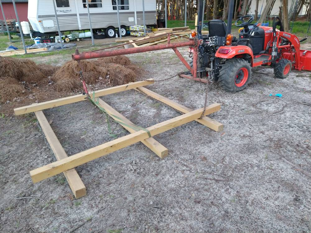

I forgot to update. I did try this and it did work very well. I sort of temporarily set it up with straps. I found out that it works, but I'll need a heavier duty gate for sure if I plan to use one like this often. I was going to modify it with some hoops to slip my fork tines through, or some square U bolts or something similar, but this particular gate just isn't going to cut the mustard.

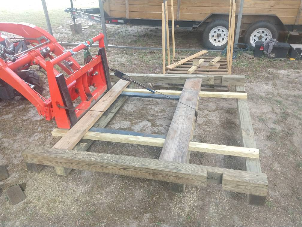

I have a grading job to do this weekend, so now I'm going to try this.

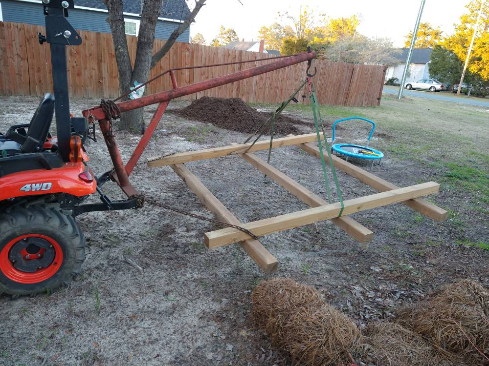

It's similar to my 8x8 drag, but that one is cumbersome to pack on the trailer.
This new one is a little shy of 6x6 and will fit on the trailer easier. It's crude, but I'm expecting to start using it and see that I need to make some changes. I may still find that I want to drag it behind me.

Thanks for the trip down memory lane. An uncle farmed with a drag that I think he used to flatten the ground. I think his was actually a wide stone boat that he had repurposed for land leveling. I was just a little kid, and never learned much about it.

I tend to think a rear mount drag is going to work better than a front mount because a rear chain drag leaves the drag totally free to follow the ground contours. Something on the FEL would be more subject to up/downs of the tractor and if it's lightweight, it would have a harder time actually moving the dirt. The weight wouldn't be as much of an advantage if mounted on the FEL because the FEL would be carrying that weight as opposed to it resting on the ground if dragged behind the tractor.
But if you are essentially trying to move dirt around in a controlled manner like with a front mount box blade, that could be different than just trying to smooth the dirt out over a large area.
Chain link fence might be something to consider if dragging behind the tractor because you could roll it up for transport.

I guess think more like land plane than chain drag. At any rate, when I tested this with the cattle gate the way @Xfaxman did it worked really well for me. I can put the loader in float and drag with it. I can push or pull if I need to, and I can manipulate what it does with the tilt function, which proved useful. I can also put down pressure on it but only as needed. Being able to reach forward and set it down into places I can't drag into is useful.
I was able to accomplish the same end result I do when I use my pull behind drag. There are pros and cons both ways, and you definitely can't beat the sort of passive smoothing and leveling I get over an 8' span with my drag.
I'll be doing some more testing with this method on some ground that's perfect for it soon to be able to have a better comparison. I've pulled my drag a lot and done a lot with it. Using it with the boom pole helps get around a lot of the shortcomings, but that's just MORE to pack for the road.
Boom pole and drag is king at home.
