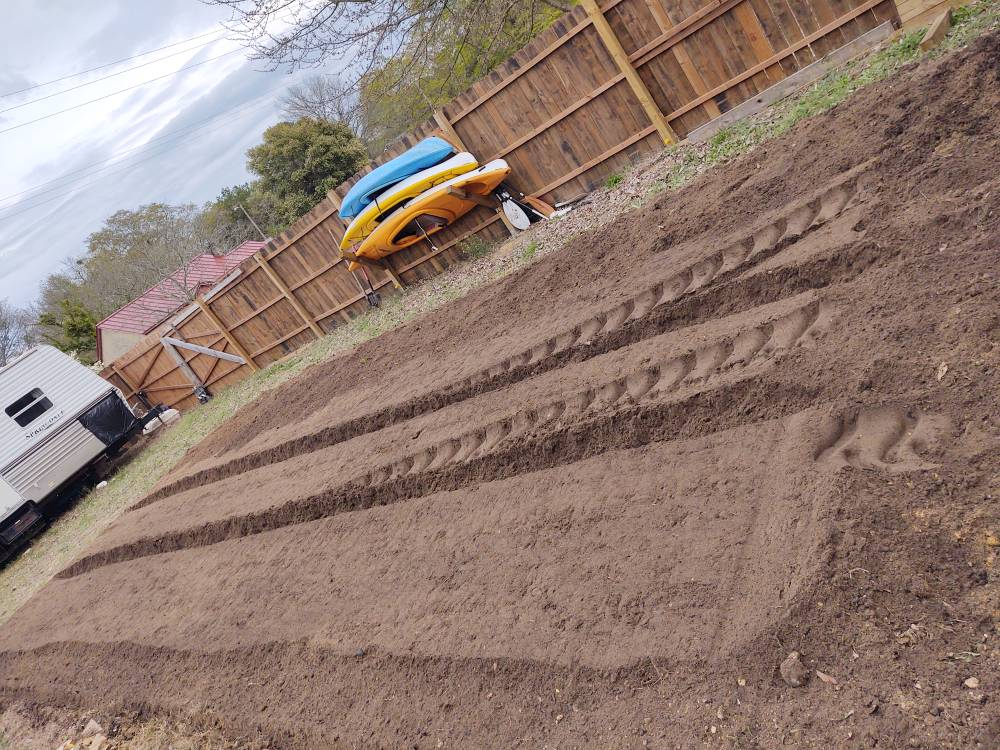

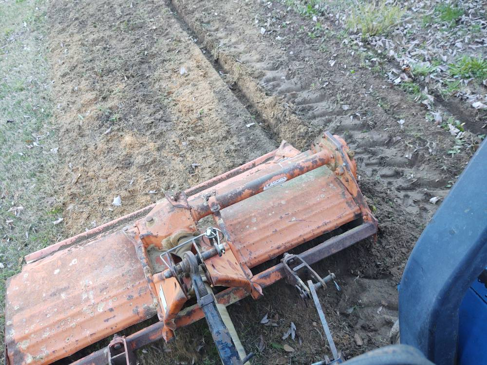

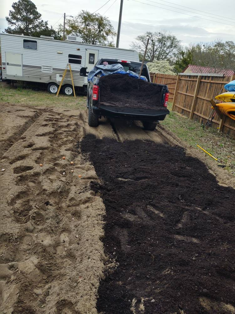

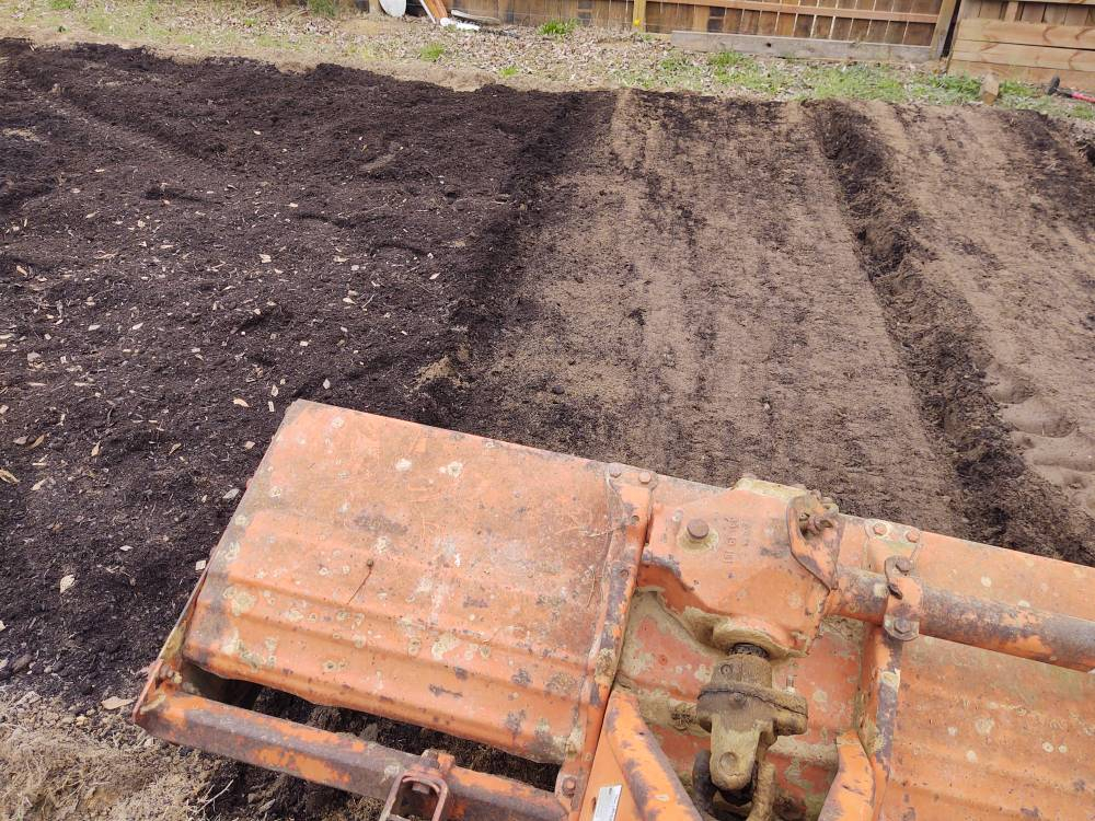

After tilling my garden, I see great value in a tiller. Even for doing some light grading work around my property. I think I could hit it with the tiller then finish off by hand in a jiffy, or smooth it with a bucket if I wind up with a front end loader.
My daughter, wife, and I planted all of our fruits and vegetables yesterday in the new garden. We enjoyed getting out there and working in the dirt, and my daughter (6 years old) is absolutely stoked about watching the plants grow and can't wait to "eat her basil" . She will literally pick basil straight from the plant and munch on it .
I tend to meander through my thoughts, but I said that to say that I think we'll continue gardening in some capacity, so I think a tiller would be worthwhile. Even though they aren't cheap. The current measurements are about 30x 18. We may even need to add room for one more row this year.
