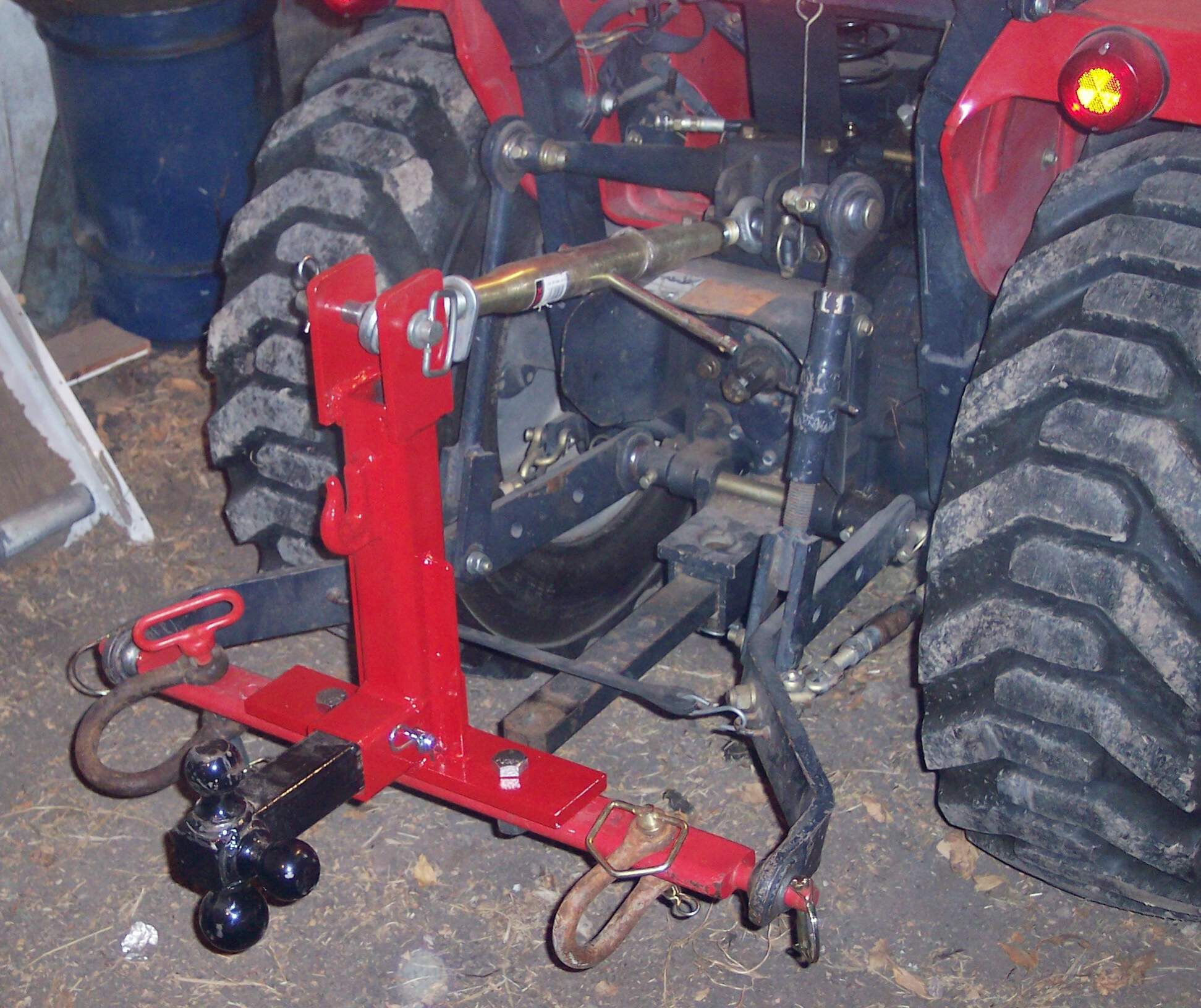

Here's my trailer mover....

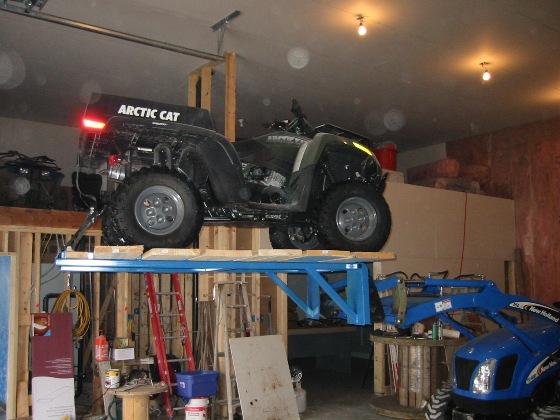

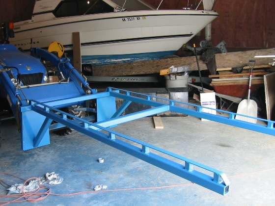

I use my front platform all the time, it's one of handiest things I have built.

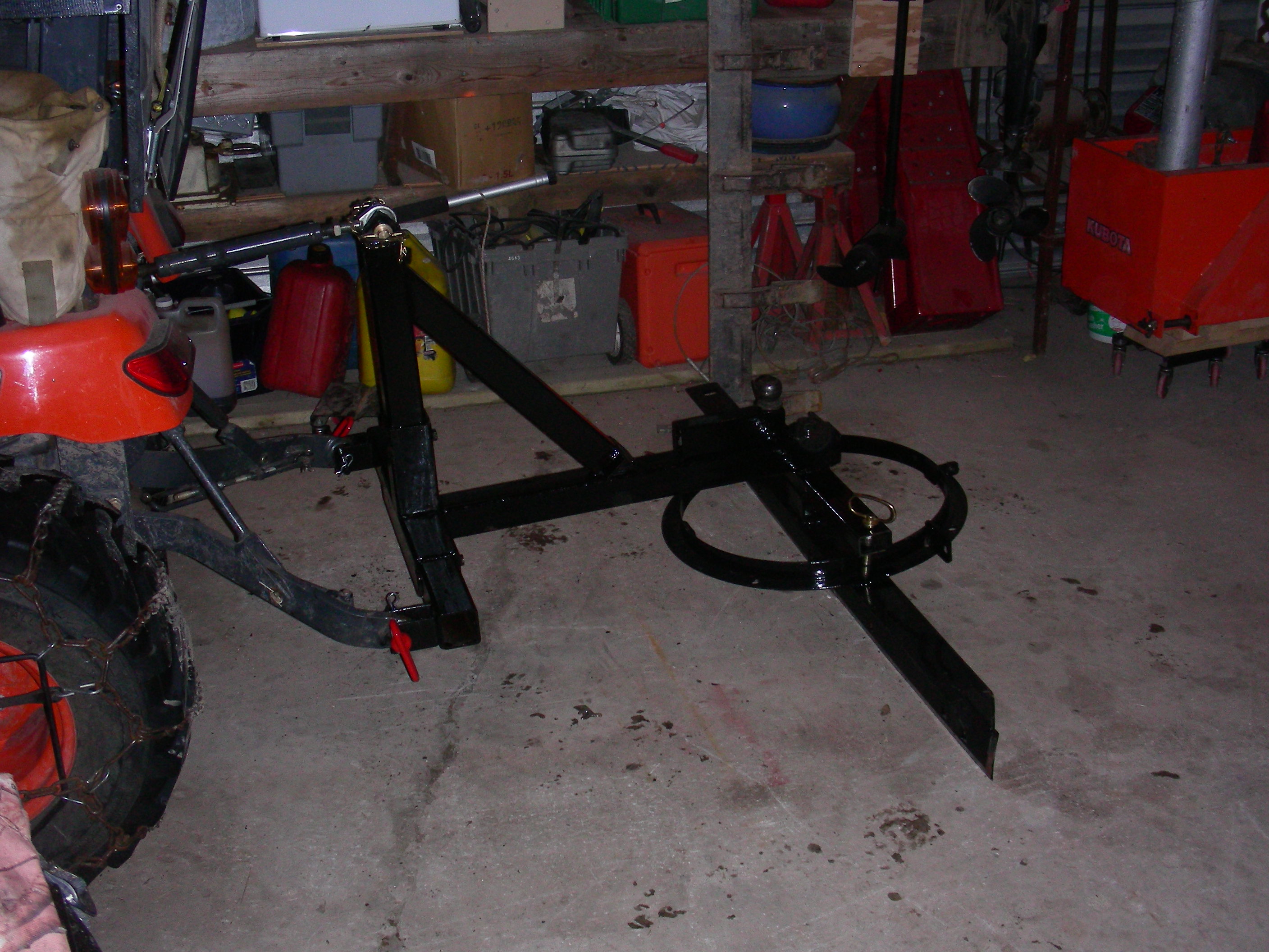

I made this over past two weeks . Painted it last night.
All scrap metal I already had, but drillbits and sawsall blades , pins etc cost me $100
I used an old engine cradle that had casters removed, and used a old sattelite dish round circle thing, for swivel and pins set up, and I had an old cutting edge I cut down to 54 inches and tacked a 4 inch angle iron on top of the cutting edge to give the blade some height . Will use it to spread gravel and topsoil.
I also added a trailer ball , I attach a ball to all my attachments in case I need to move the boat or a trailer .
