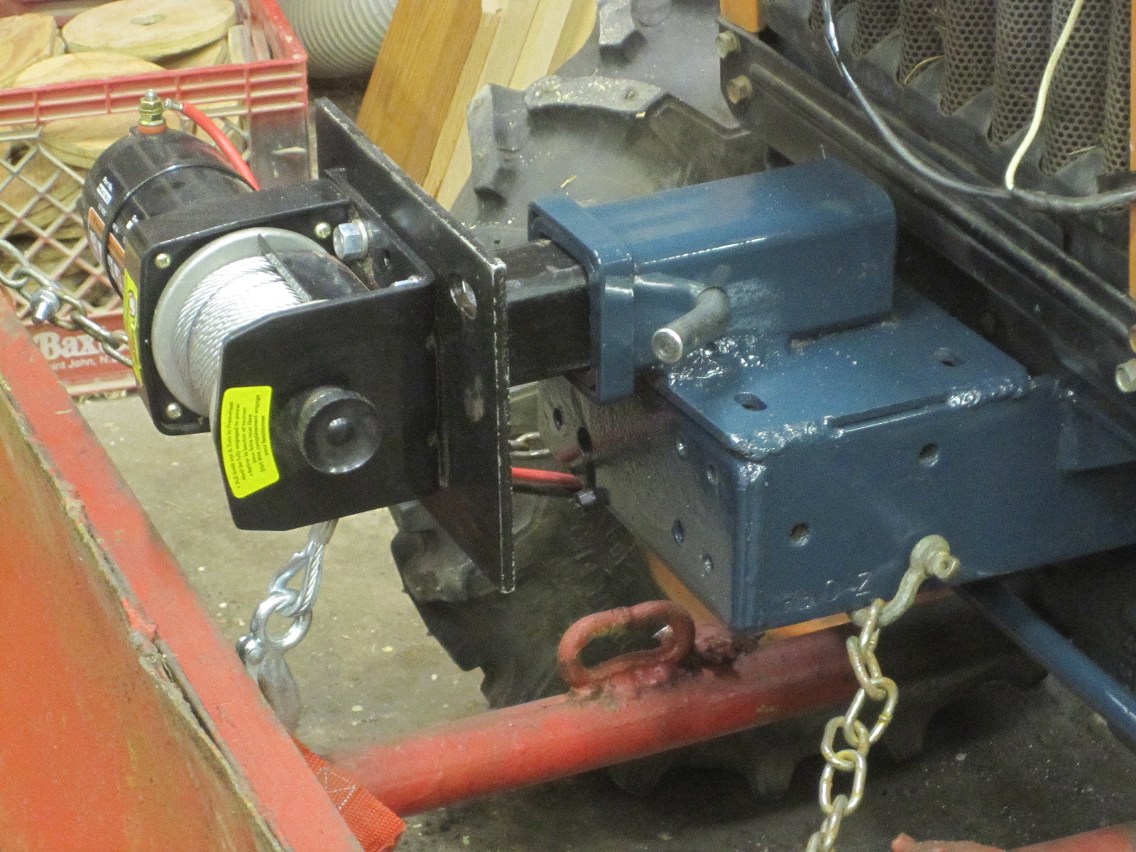

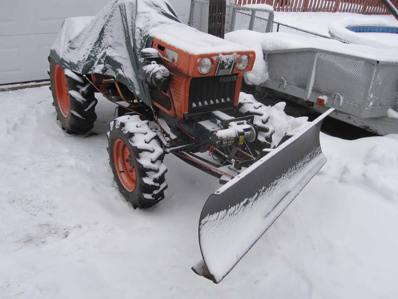

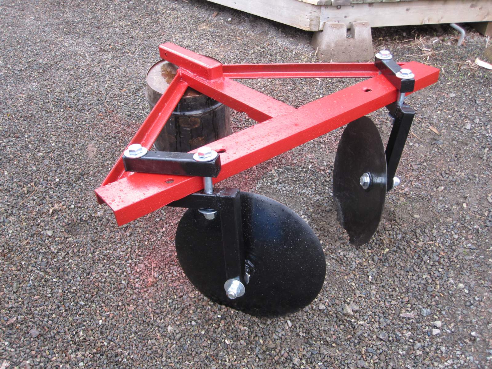

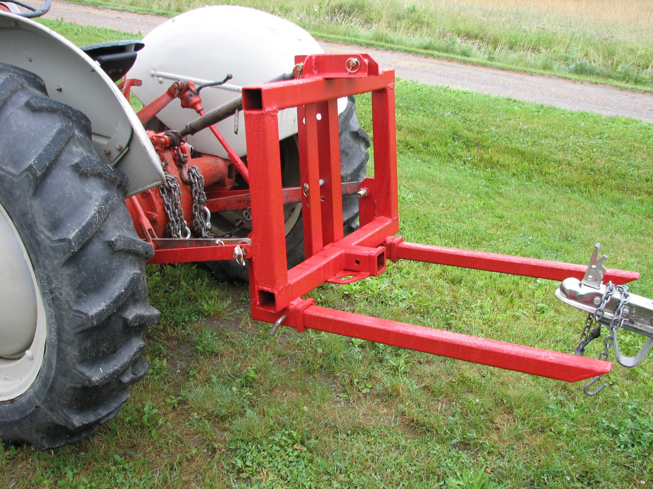

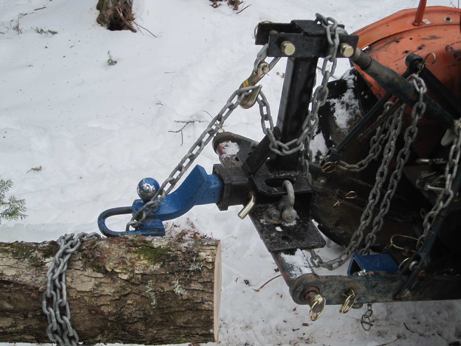

Some of the stuff I have made for my Ford 8N & my Kubota B7100.

Ken Pike, That's a slick setup on the rear forks! And most excellent use of hitch tube!!! I have a small winch that I bought at auction and thought about putting it on my B7510 but didn't want to leave it there because I use it on my utility trailer, Now I got an idea of how to mount it for use on both!!

600Rider - forks have come in handy a few times. With a pallet slid over the forks I can load & move (8) 24"x30"x1.5" patio blocks - the 9th block causes the front wheels to come up a bit if I hit a bump. Last Fall I loaded a 18" x 12' White Ash log (donated from a buddy's firewood load),traveled 1/2 mi. to my wife's Uncle's band saw mill for sawing. While he started on that one, I went back for the the other 12' section of the log. As we sawed, I stacked the sawn lumber back on my forks, hauled it all in (1) load (very heavy!) down to our cottage & stickered it under cover. Haven't tried it for fit on my Kubota but it will take Cat 1 implements. I might make a smaller set this summer when we get moved back there.
