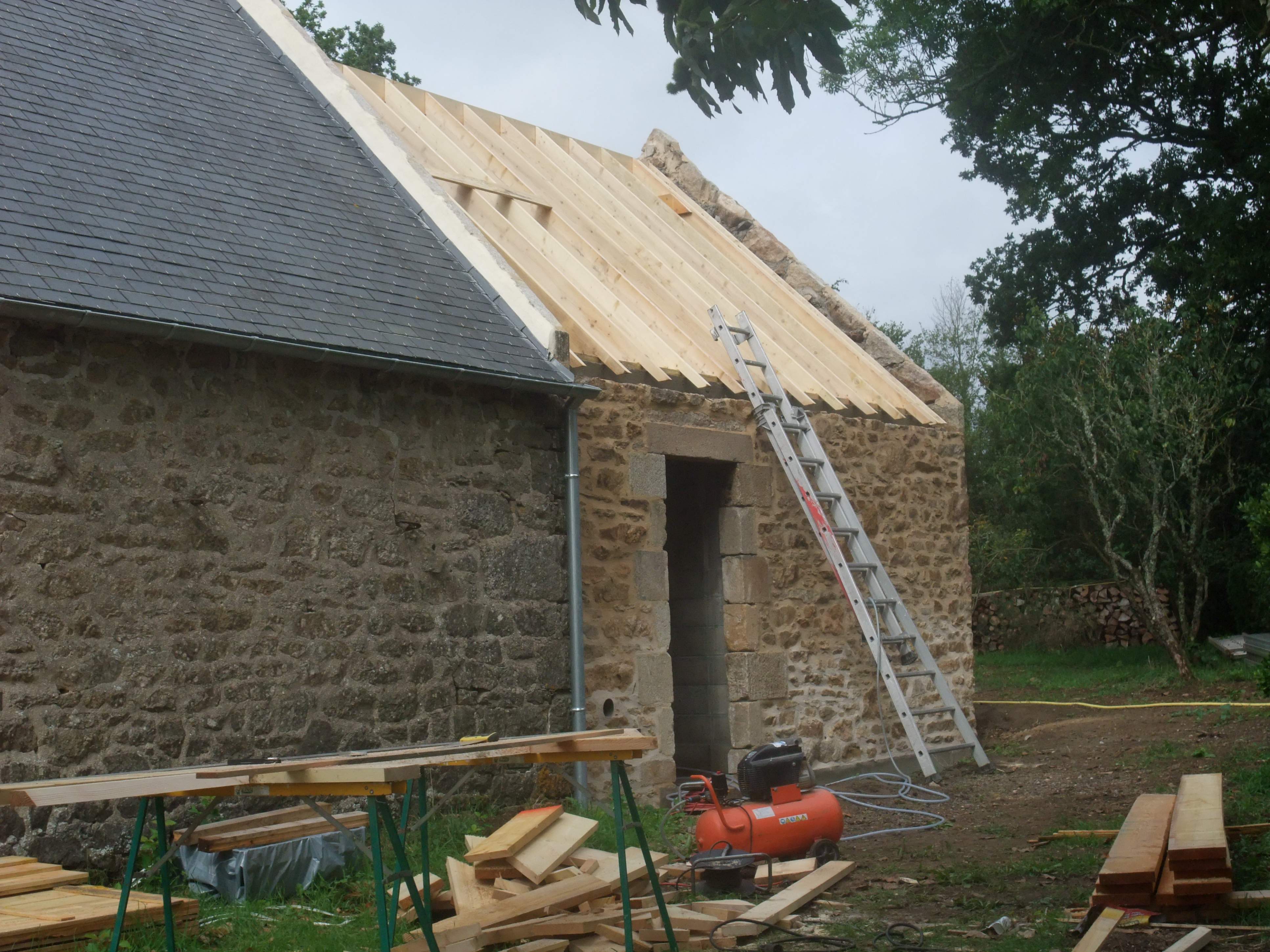

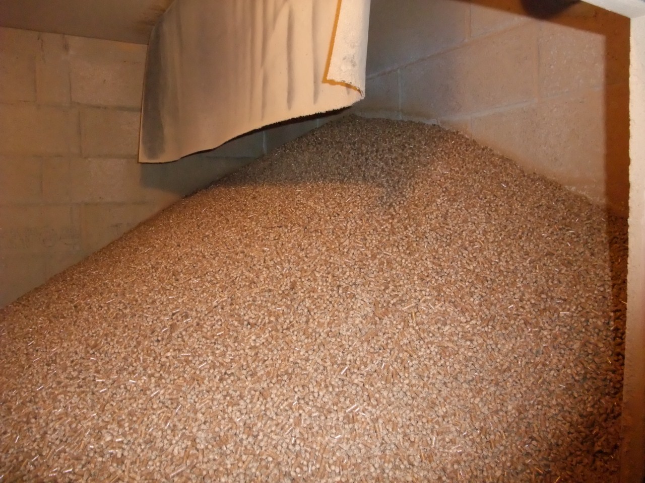

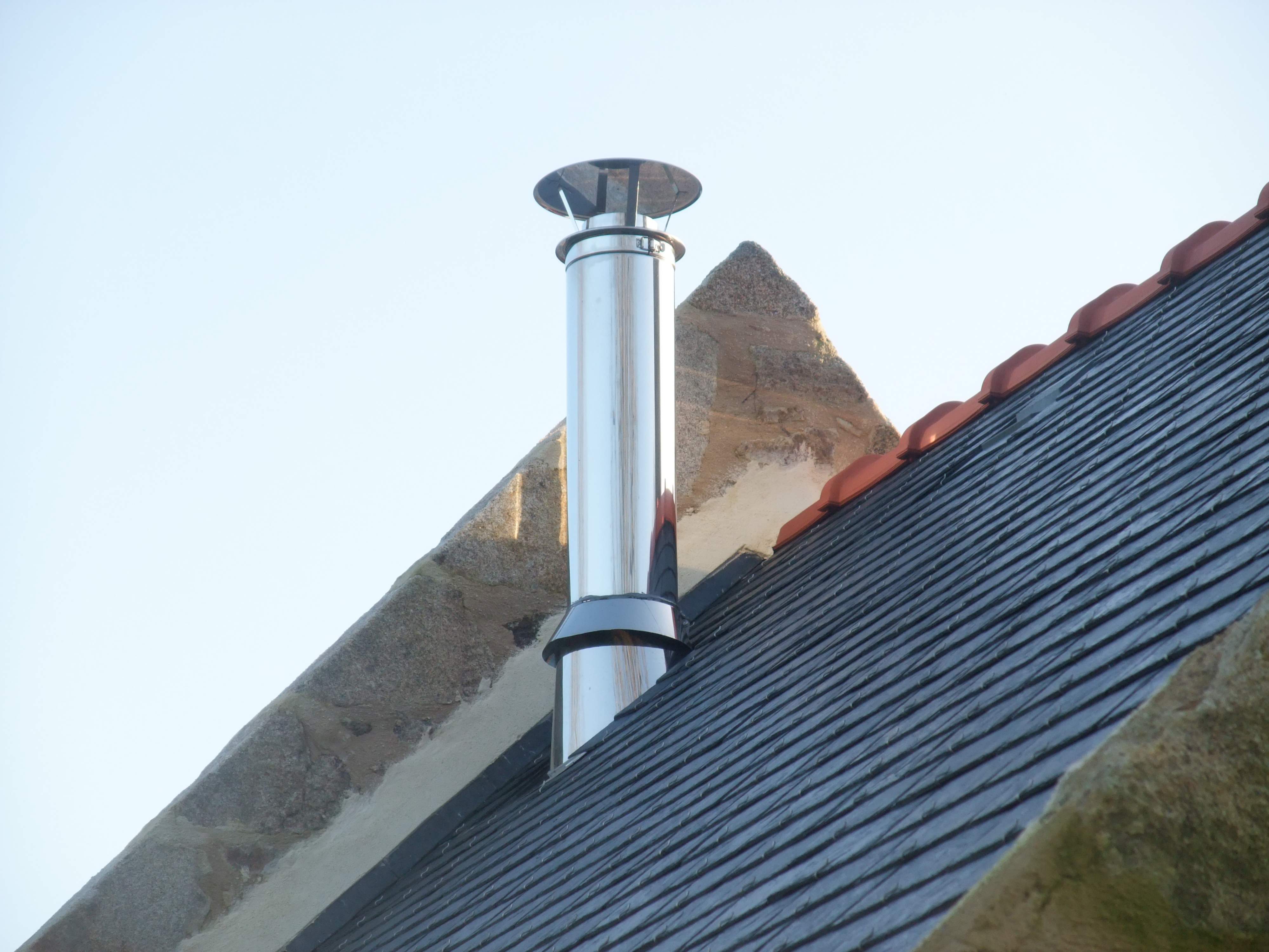

Two years ago, I was disgusted by my electricity bills and tired of carrying logs to the fireplace. So I replaced everything by an automatic pellet furnace. The pellets are delivered right in the silo and taken to the furnace as needed by a screw. Circulating water carries the heat to every room and creates a very comfortable atmosphere. I had to build an extra room to house the whole thing, but I find it was well worth it.
I think Europe seems to be always in the lead with alternative heating technology. This is driven of course with fuel cost ie. parts of Italy paying over $9 for a gallon of gasoline. I'm sure fuel oil must be up there as well in Europe. There are some great wood stoves there that we can't as yet buy here.
