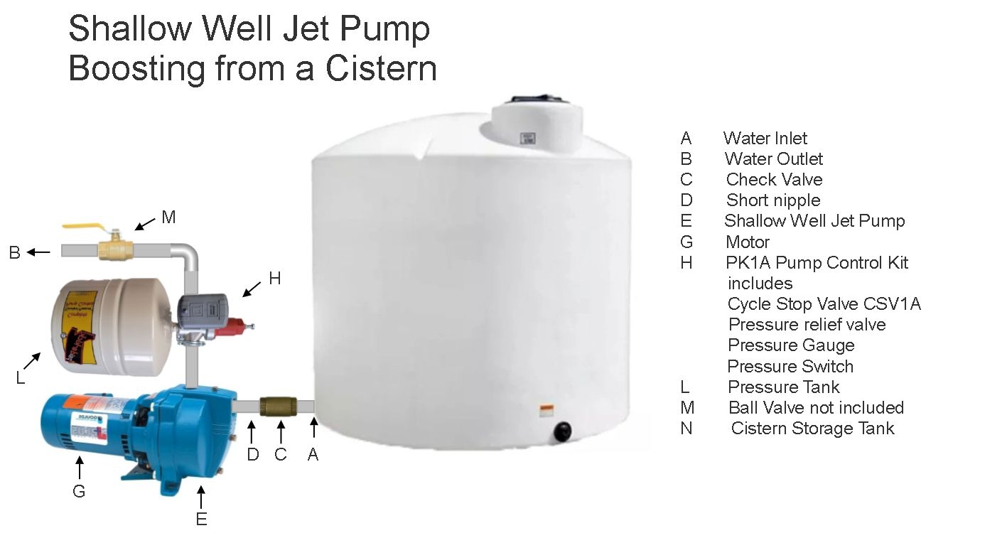

With the well pump only making 30 PSI and having to wait for a pump man. You could put in a cistern with a booster pump for temporary service. Might also make the pump in the well last much longer.
