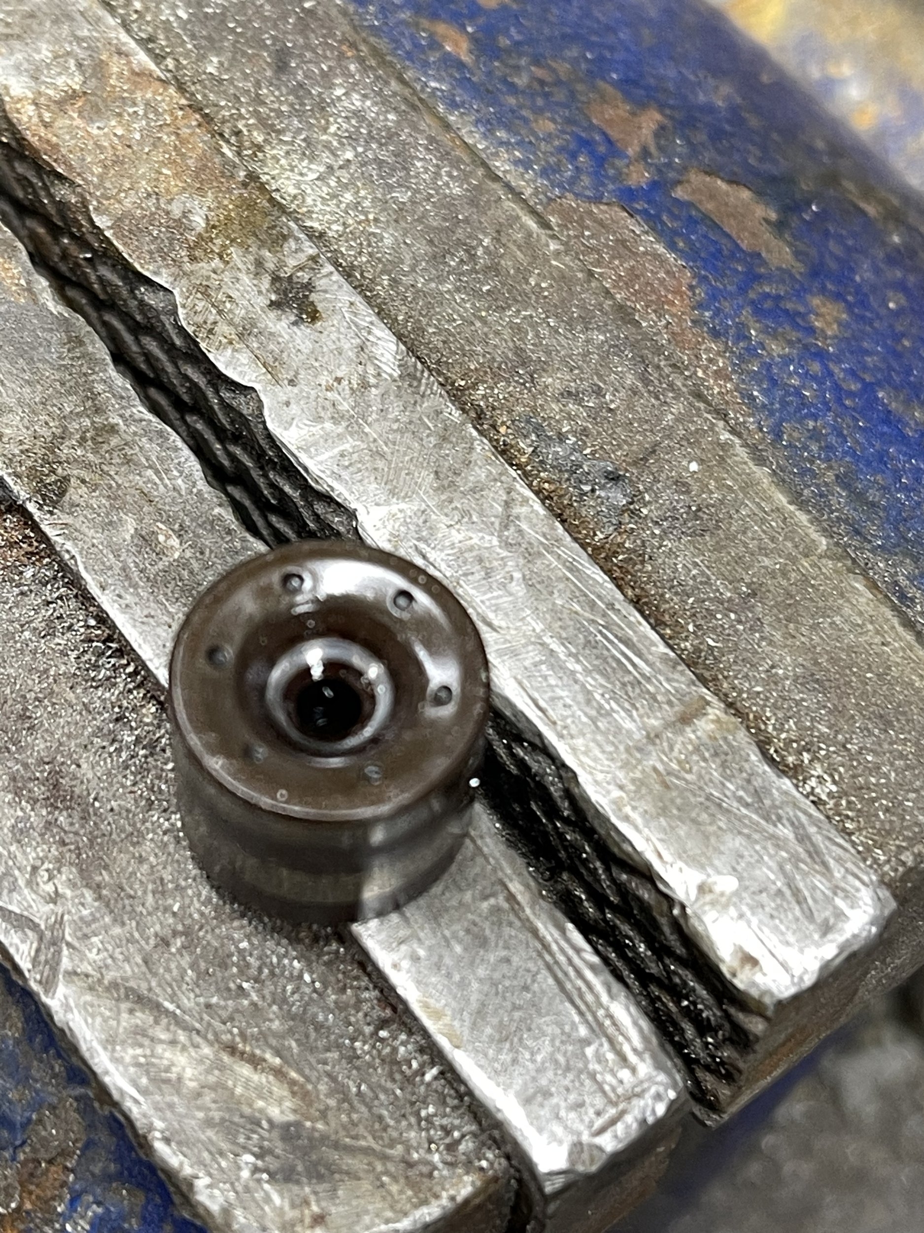

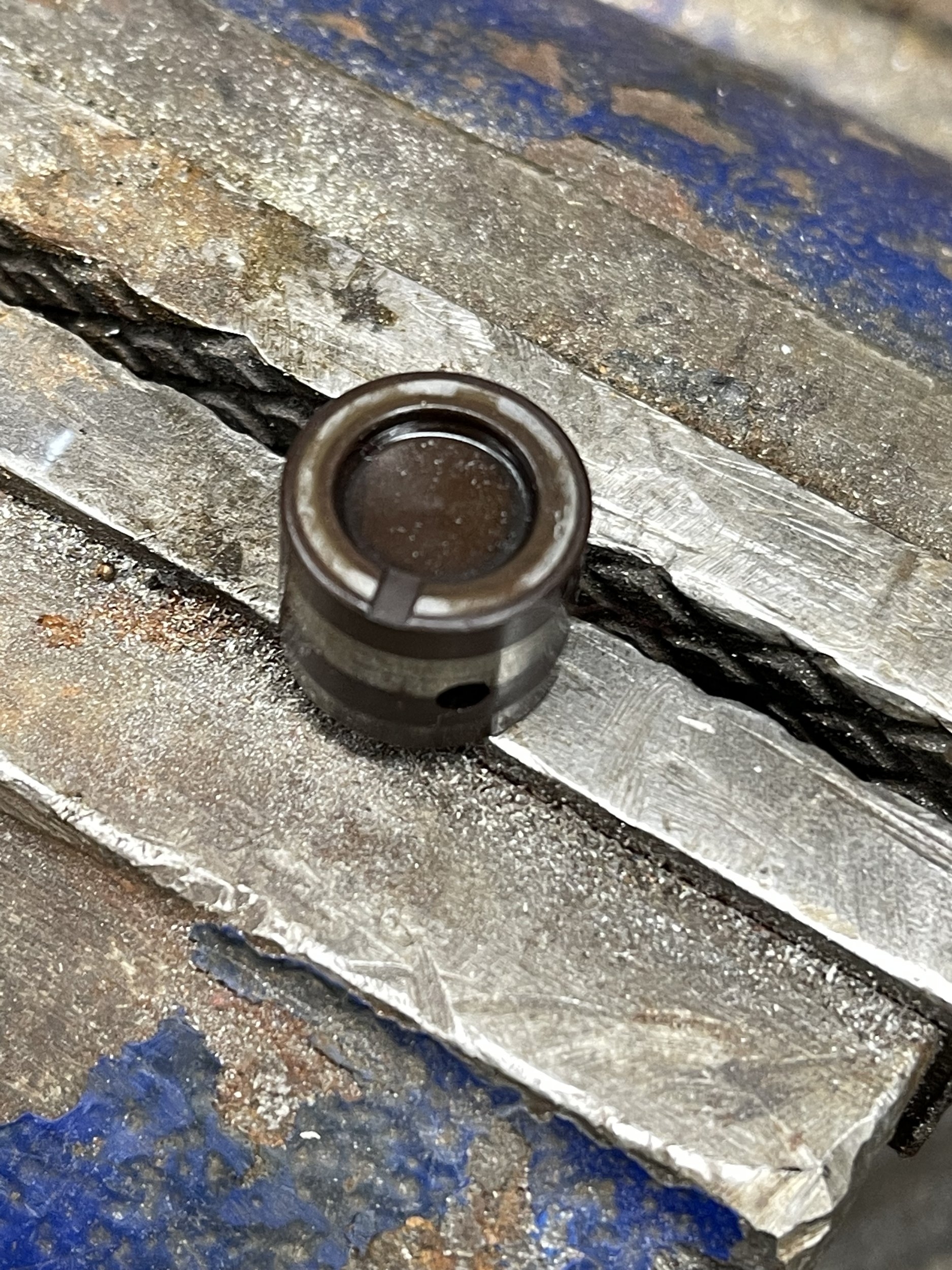

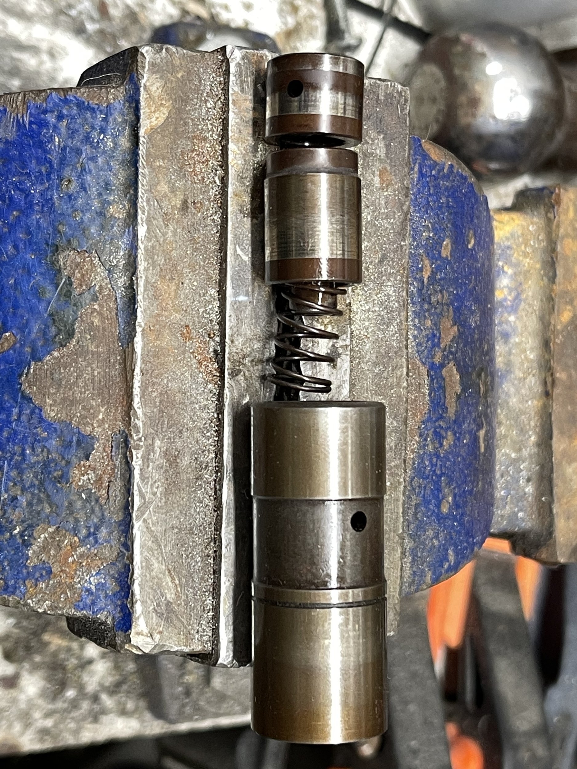

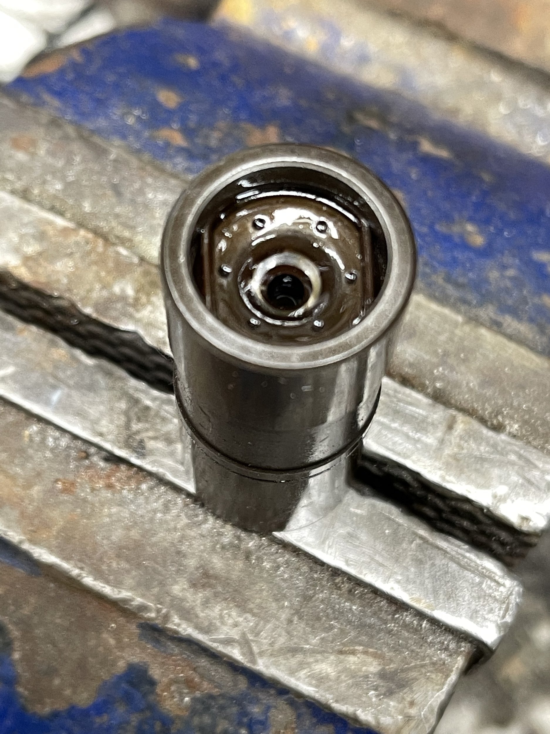

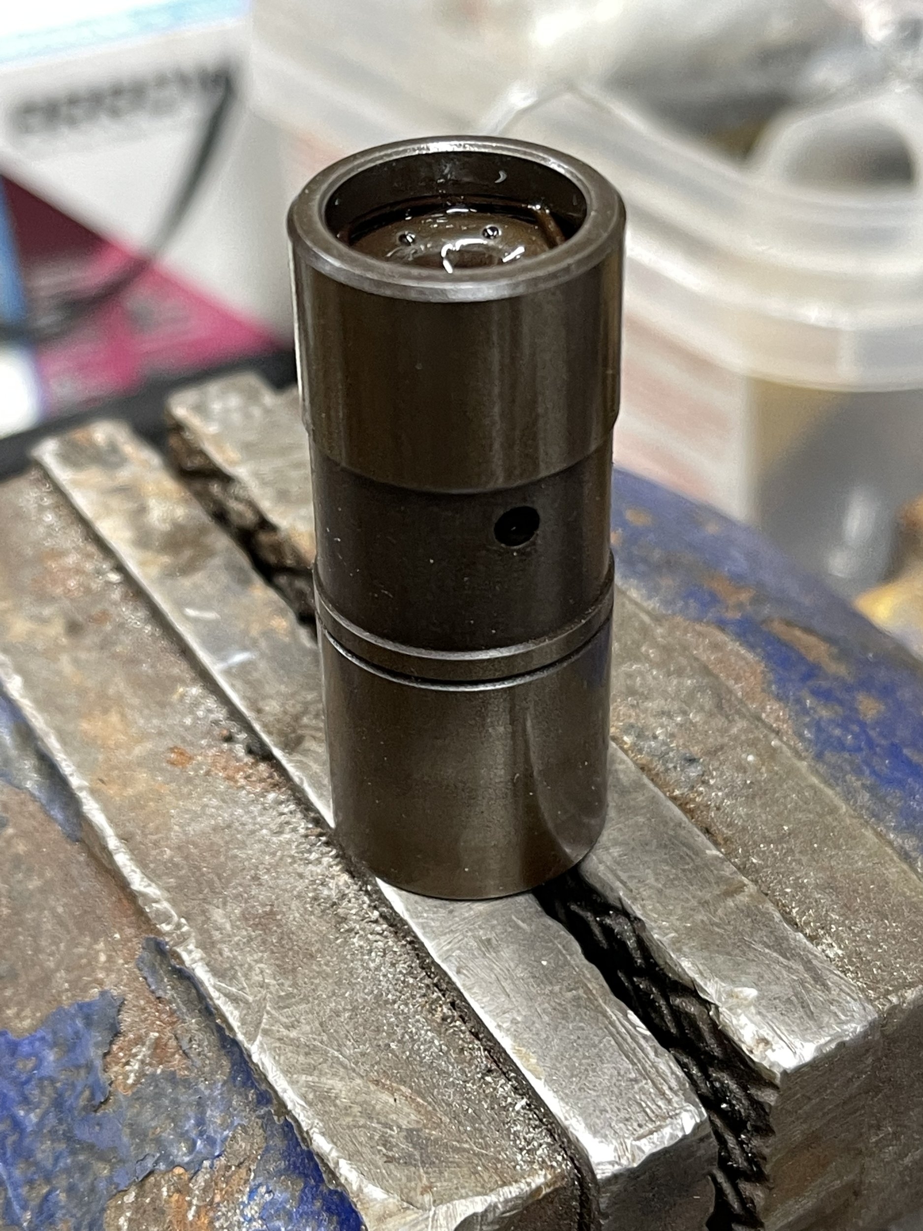

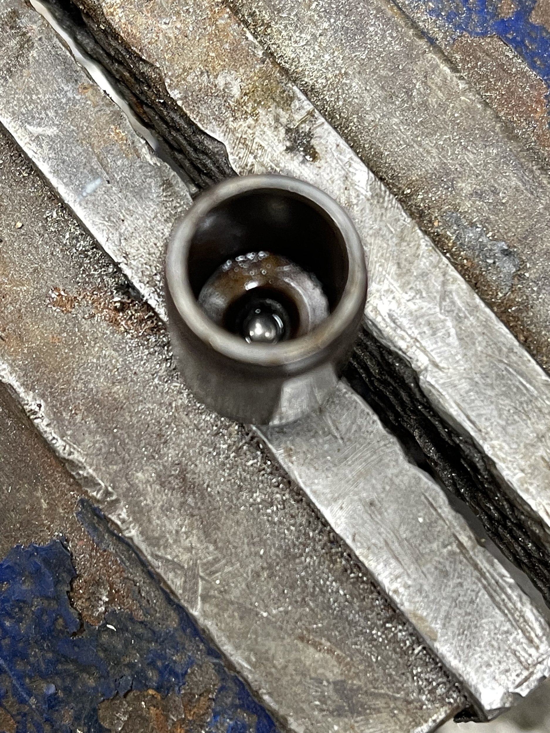

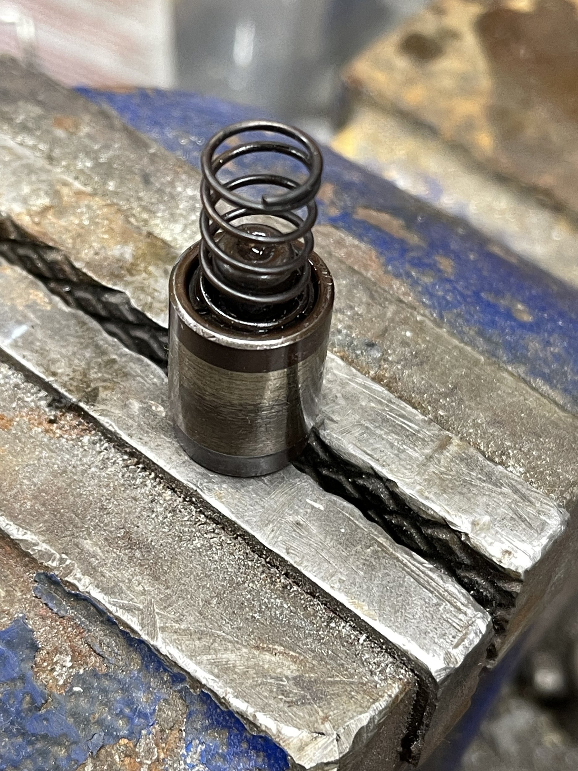

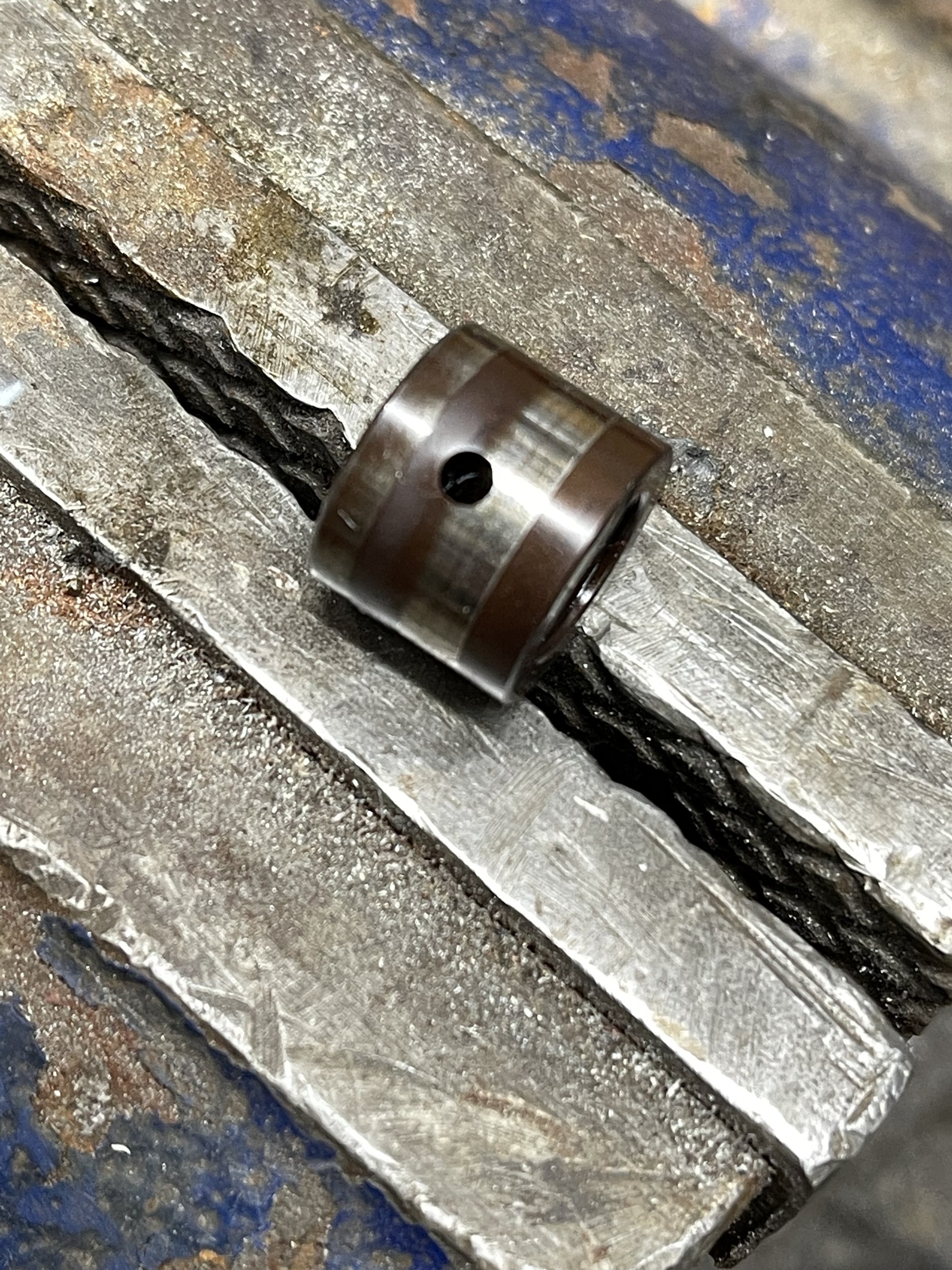

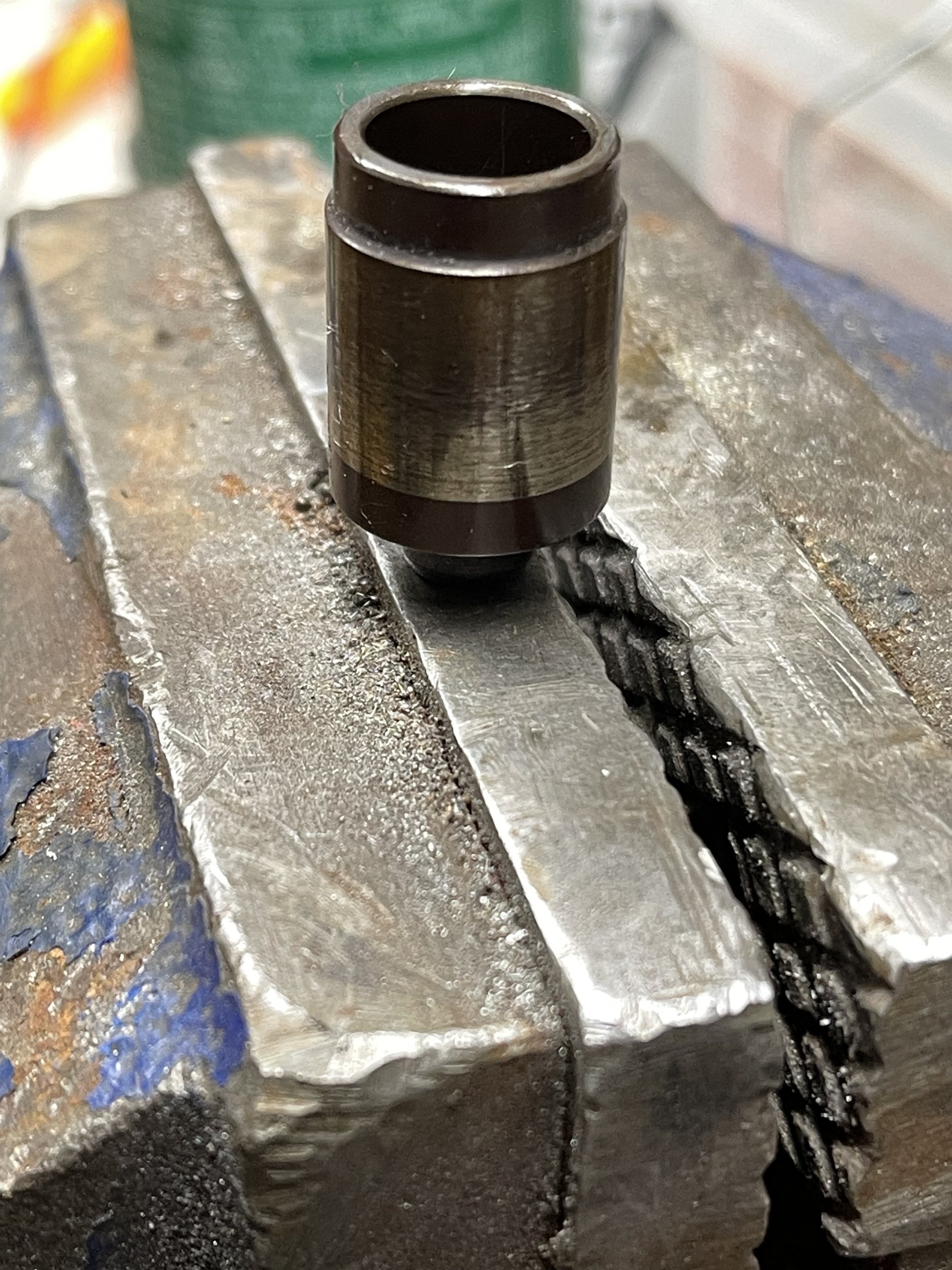

Sunday night…decided to disassemble a hydraulic lifter. I chose the intake side on this problem cylinder, and I had previously taken it out and bled it before putting back in. Tonight after pulling it, I found it to be stuck again—took an extreme amount of force to get it to bleed again…
Here are some pics of it in various pieces, in case someone else is curious too. 😜
And then I’ll include the latest pics of the head and problem exhaust valve…
