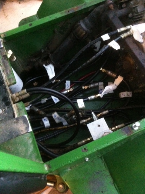

Well I finally got the last two hoses off and the pump removed. Had to take off the pto pump to get to the last hose.......also can't take the tram pump off without removing the engine mount pump adapter.....it's a bit like a chinese puzzle. One thing I noticed is that a couple of teeth on the coupler spider had sheared off but since it's just a plastic part I'm inclined to think that's more a result of the problem then the problem itself.
If what I'm seeing is correct the only hose that connects to the filter is attached to the tram pump......so the only oil being filtered is what goes to the tram pump and then the wheel motors......everything else on the machine including the steering/pto pump and all cylinders is using unfiltered oil.......but I'm a real amateur on hydraulics so I stand by ready to be corrected :)

You got it. When you step on the pedal, the swash plate in the tram pump directs oil in the wheel motor circuit one way. When you step on the pedal in the other direction, the swash pump changes angles and directs it the other way. All of the oil in the wheel motor circuit just goes around in a big loop. However, anything that goes past the swash plate goes to the hydraulic cooler and then back to the tank. To make up that lost oil, the tram pump sucks oil from the tank and through the filter. Or something close to that explanation! :laughing: Anyhow, if the tram pump blows chunks of metal, it can go though any or all of the wheel motors, the cooler and then into the tank. Hopefully it settles out in the tank bottom before being picked up by the 2 PTO pumps. One PTO pump is dedicated to the main PTO only. The other smaller AUX PTO pump provides pressure to the steering, lift and curl/dump circuits, as well as the quick attach (which is also called the AUX PTO). ;)

This is the spaghetti of hoses that is left over after pump removal.
