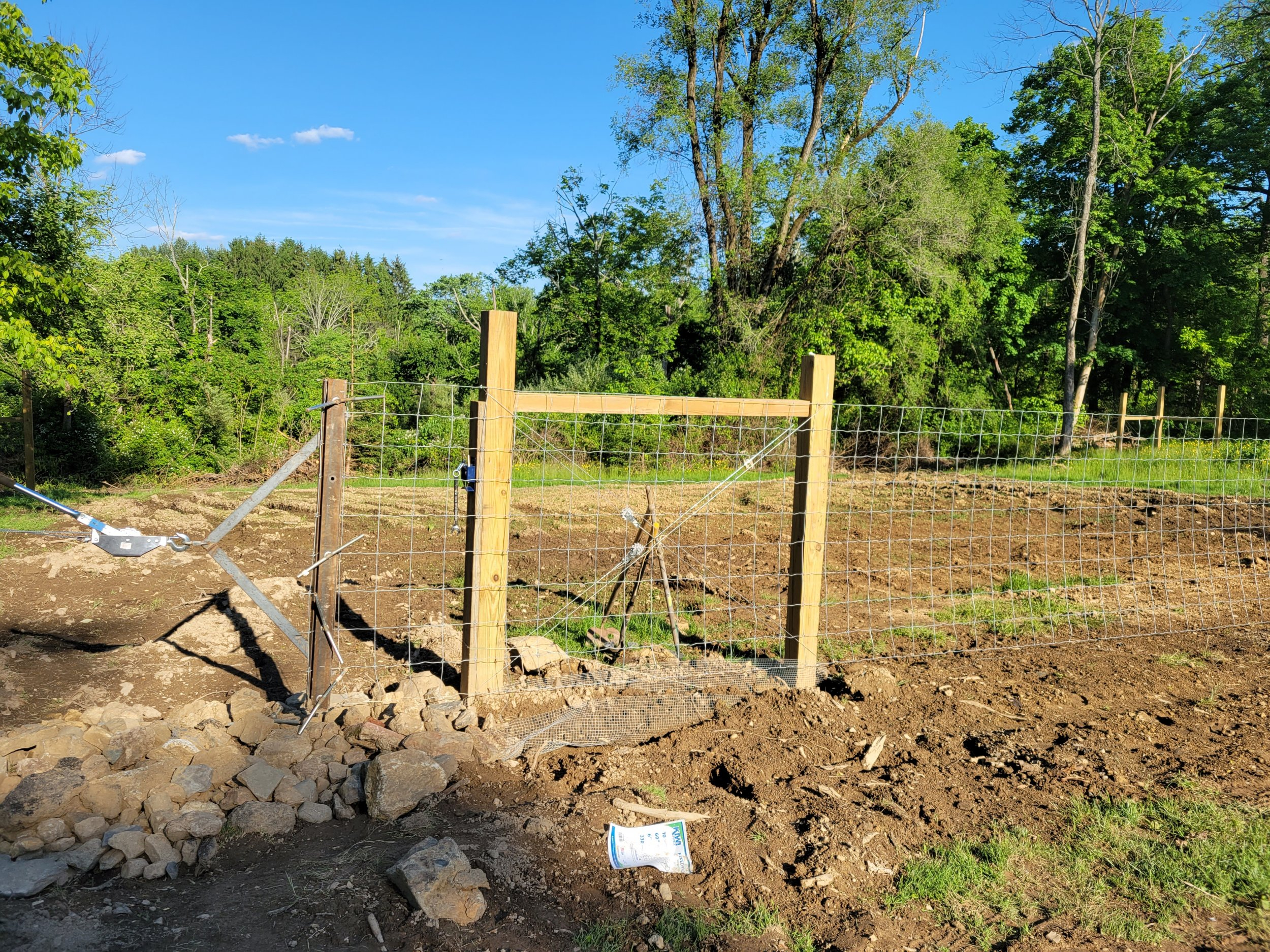

OK ladies I know this is not the usual cookies, knitting, and doily work, but I would like a little input.
See images. I am terminating a run of high tension fencing.
My best plan as things stand is to pull a little too hard on the fence and splice some fencing wire to the fence in the pics. Then use that spliced wire to tie the fence off to the pole. Then start wrapping the actual fence wires on cutting them from my stretcher one at a time.
Something tells me that this is not the usual way. Maybe what I should do is cut the lines from the stretcher starting in the center of the fence and wrap them and crimp them one at a time.
How do you do it?

What the heck is this “tie” stuff? I stretch it, staple it to both posts, then cut and wrap end around last post and staple it again.
/ more fencing, terminating a run #7
If your corner is set good stretch fence to desired tension then get a little more staple fence to post , cut then wrap around post and dally back to fence wire.

When we made vineyard gates with that type of material, we'd cut the verticals and wrap the horizontals around the tube.
Move the stretcher between the posts, restretch, you can use some staples just to keep it from flopping so much and in position, then trim and tie.

Got 'r Dun~!!
Took me long enough. I 'spect it'll take less time as I progress around the field.
I do like that little stretcher I made. Nothing slips, not a bit, not at all, not any.

Stretcher about a foot before the tie post, not after. Cut, tie, then release tension.
Bruce
I cut verticals and then go all the way around, wrap the wire back on itself. just need about 3 loose staples top bottom and center to keep it from moving vertically. this lets it move a little with the seasons and the tension stays in the fence longer, preventing broken wires at stress points at the tight staples. The temp swings here from max of 100+ to -30 or -40, so more change in length over a season than a lot of places.
