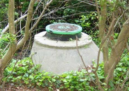

not if there is a heater or lights in the well house. most well house panels ive seen have 120 circuits there also. if they are not [present, then yes only 3 wires would be needed.
The well house is an above ground manhole-caission type structure. I'll examine more closely the next time I go pry the cover off, but the circuits and breakers I see in the basement of the existing house indicate a three wire setup.
Looks a bit like this:
